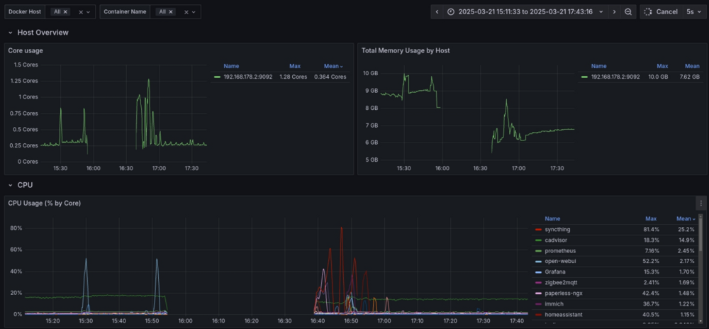

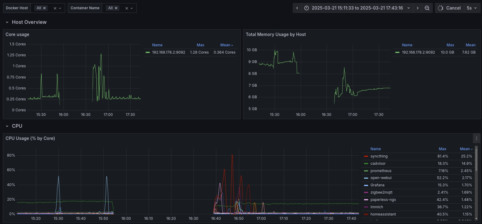

  1. it happened again. Two times. Once friday the 21.03 some when around 16:30 and this night some when around 02:30 this night the appdatabackup ran. On Friday it was something else. Seems it's really something with docker. On Friday I worked a bit with openwebui Container. This night it looks like immich container made a bit CPU load. But I still don't have a clue what breaks the entire system or where I can look for more informations. syslog-192.168.178.2-2.log cakestation-diagnostics-20250325-0753.zip

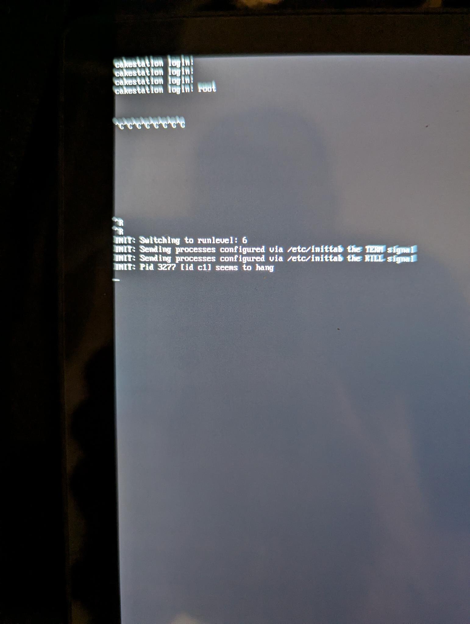

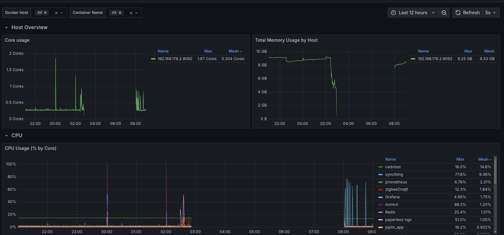

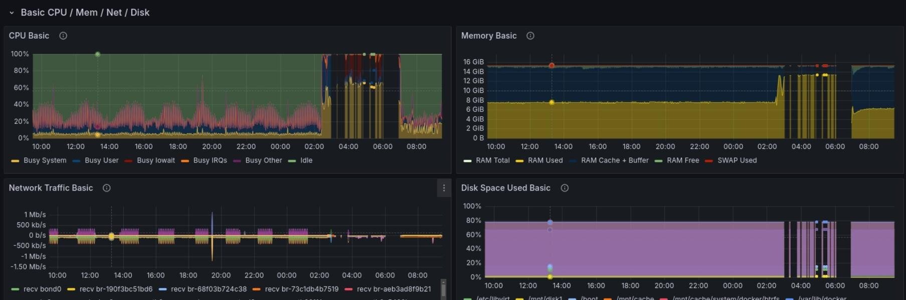

  3. Hi, since Version 7 it happened the second time now. That my server freeze. On the first time couldn't troubleshoot it, because I haven't set a syslogserver. This time I have, but I don't see anything suspicious. The first time I could login anymore. But with an external screen I could see a loginpromt, but the login won't get any feedback. After pressing ctrl alt del a process seems to hang. But also no response anymore. After I checked the grafana graphs I saw that after 02:00 wasn't anything logged anymore. This time the entire Server has not given any response. The display was just black, no loginpromt. The disk LED was always on?! Anyways it looks like grafana or prometheus could log at least some metrics. I checked the new syslogfiles and see that at 02:26 there are many docker network entries. Mar 10 22:32:35 cakestation Docker Auto Update: No updates will be installed Mar 11 02:25:07 cakestation kernel: veth9b5ce00: renamed from eth0 Mar 11 02:25:54 cakestation kernel: eth0: renamed from veth4fb02a8 Mar 11 02:26:01 cakestation kernel: vethf199325: renamed from eth0 Mar 11 02:26:01 cakestation kernel: docker0: port 18(veth717551c) entered disabled state Mar 11 02:26:01 cakestation kernel: docker0: port 18(veth717551c) entered disabled state Mar 11 02:26:01 cakestation kernel: veth717551c (unregistering): left allmulticast mode Mar 11 02:26:01 cakestation kernel: veth717551c (unregistering): left promiscuous mode Mar 11 02:26:01 cakestation kernel: docker0: port 18(veth717551c) entered disabled state Mar 11 02:26:01 cakestation kernel: docker0: port 18(vethf7fd347) entered blocking state Mar 11 02:26:01 cakestation kernel: docker0: port 18(vethf7fd347) entered disabled state Mar 11 02:26:01 cakestation kernel: vethf7fd347: entered allmulticast mode Mar 11 02:26:01 cakestation kernel: vethf7fd347: entered promiscuous mode Mar 11 02:26:01 cakestation kernel: docker0: port 18(vethf7fd347) entered blocking state Mar 11 02:26:01 cakestation kernel: docker0: port 18(vethf7fd347) entered forwarding state Mar 11 02:26:02 cakestation kernel: eth0: renamed from veth8867d93 This behavior went further till 04:05 since this time, there was trouble with usb devices Mar 11 04:05:15 cakestation kernel: usb 1-5: USB disconnect, device number 13 Mar 11 04:05:25 cakestation kernel: usb 1-5: new full-speed USB device number 14 using xhci_hcd Mar 11 04:05:25 cakestation kernel: cdc_acm 1-5:1.0: ttyACM0: USB ACM device Mar 11 04:05:25 cakestation kernel: usb 1-5: USB disconnect, device number 14 Mar 11 04:05:25 cakestation kernel: usb 1-5: new full-speed USB device number 15 using xhci_hcd Mar 11 04:05:25 cakestation kernel: usb 1-5: unable to read config index 0 descriptor/all Mar 11 04:05:25 cakestation kernel: usb 1-5: can't read configurations, error -110 Mar 11 04:05:25 cakestation kernel: usb 1-5: new full-speed USB device number 16 using xhci_hcd Mar 11 04:05:30 cakestation kernel: usb 1-5: unable to read config index 0 descriptor/all Mar 11 04:05:30 cakestation kernel: usb 1-5: can't read configurations, error -110 Mar 11 04:05:32 cakestation kernel: usb usb1-port5: attempt power cycle Mar 11 04:05:32 cakestation kernel: usb 1-5: new full-speed USB device number 17 using xhci_hcd Mar 11 04:05:32 cakestation kernel: cdc_acm 1-5:1.0: ttyACM0: USB ACM device I am not sure, but this could be my zigbee Stick. This went further til 06:06 which is also the last log entry. At 06:55 I had to hard reboot the server. Suspicious is, that both times it was something around 02:00 in the night. cakestation-diagnostics-20250311-1008.zip

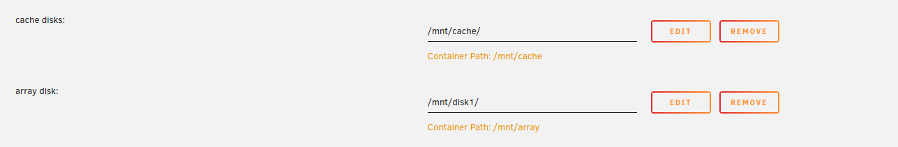

  5. Can you explain this to me? I use the Agent2 and i can only see the array, but not the Cache as FS in zabbix. Also I would like to the the disks itself. Where I have to the theses Settings in the zabbixGUI?
