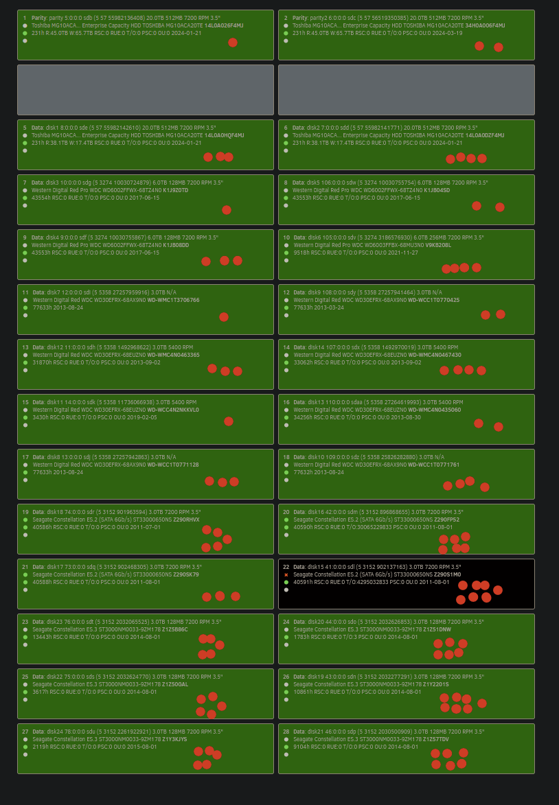

  4. I don't have the calculations i did before purchase at hand at the moment, but i added all of the maximum currents of all harddrives together and it was approximately 250 watts @12V for the harddrives. I compared the currents for 5V and 12V with the specs of the power supply and decided to go one step bigger (850W vs 750W) to be on the safe side regarding the currents, since harddrives take the maximum of power when they are spinning up. I would think that a problem with the amount of power supplied would show while bootup (all disks spinning or starting) and not while (in this instance) 22 of 26 disks were spun down and hardly using any power (in the range of 0,5W per Disk) from the supply. Before i put any Data on it i tried multiple times to boot the machine and the power supply did this without any problems. Controller Issue: yes that could be possible. 2 of the 4 controllers are PCIe x4 and 2 of them are PCIe x1 attached due to limitations of the slots on the MB. But they are all of the same brand (MZHOU - Chipset ASM1166). These were mentioned somewhere in the Forums as working and ASPM compatible. The SATA Connections are as follows: The 20TB Toshibas are connected directly to the MB. 1. Controller ASM1166 (PCIe x4) -> half of the WD Red Pro and half of the WD Red - 6 harddrives total 2. Controller ASM1166 (PCIe x4) -> half of the WD Red Pro and half of the WD Red - 6 harddrives total 3. Controller ASM1166 (PCIe x1) -> half of the Constellation ES.2 and half of the Constellation ES.3 - 5 harddrives total 4. Controller ASM1166 (PCIe x1) -> half of the Constellation ES.2 and half of the Constellation ES.3 - 5 harddrives total Edit: I just saw that the disk15 shows 4295032833 Command Timeouts in the Disk Location Plugin. I guess thats just another clue to what happened, but i don't know if its visible in the diagnostics: and the disk16 is reporting 30065229833 Command Timeouts, both are on the same SATA Controller. The other two: disk17 and 18 are on the other x1 Controller, and have no timeouts reported. Can i shutdown the system to check the Cables and the reseat the Controller in the PCIe Slot? And the System isn't able to show any SMART values for the errored drives:
  5. Hi Jorge, thanks for your reply. yes, i am using power splitters in the following configuration: My power supply comes with 5 plugs for Drive connections 1 Cable with Molex Only (x4) 2 Cables with 4x SATA 2 Cables with 3x SATA I purchased 3 splitters: 1x Molex -> 5x SATA since the Molex connector is generally good for up to 10 A of current while the SATA connectors are only good up to 1,5 A Number of red Dots - Connection to power Supply 1x Molex -> 5 SATA (4 used) 1x Molex -> 5 SATA (4 used) 1x Molex -> 5 SATA (5 used) 4x SATA direct (4 used) 4x SATA direct (4 used) 3x SATA direct (3 used) 3x SATA direct (3 used) so the failed & emulated drive is on Connection with 7 Dots - direct to power Supply with supplied Cable by Manufacturer and the other errored drives are on Connections 3, 5 and 6, so only one of the errored Drives is actually connected to a Splitter cable. All of the Molex - Splitter Drives (total 13 Drives) are connected to one Plug on the Power Supply. As you can see in the Picture i distributed the Hard drives across the Power Connections as best as i could. Thanks!
