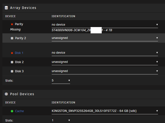

  1. yes, the 64 gb drive was cache previously new config worked, its currently syncing. thank you very much 🥳

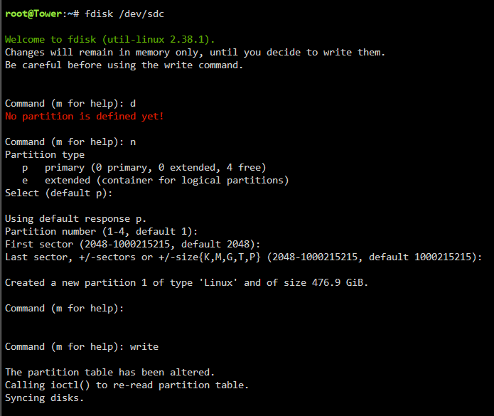

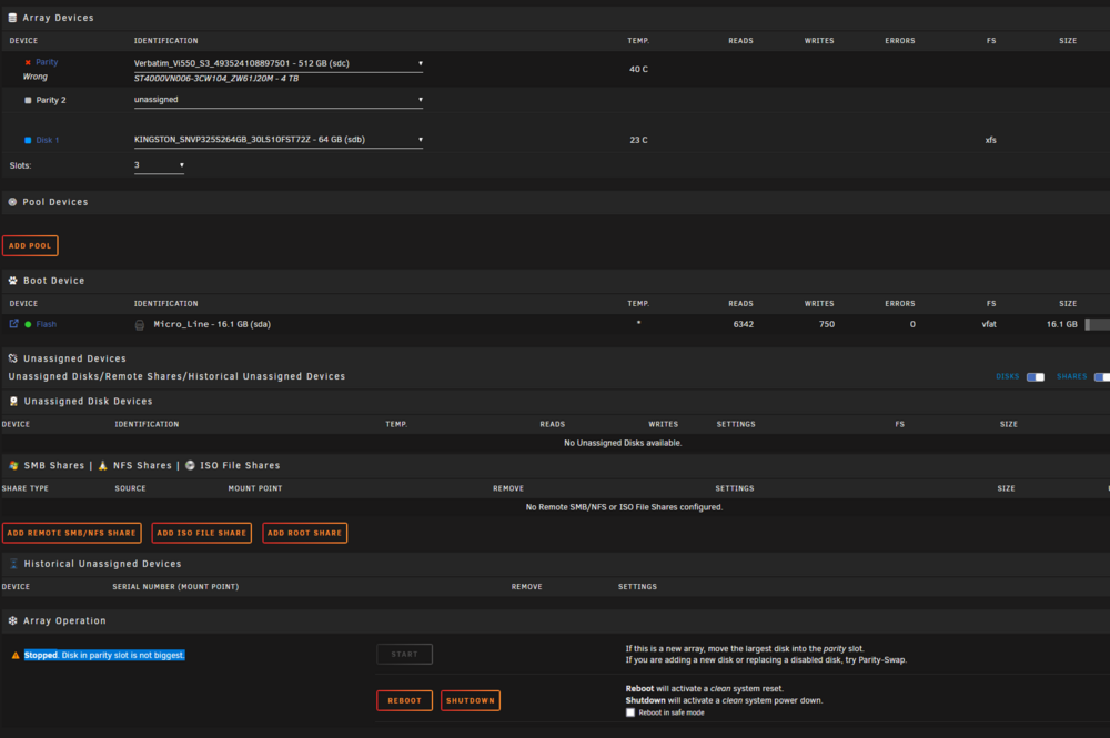

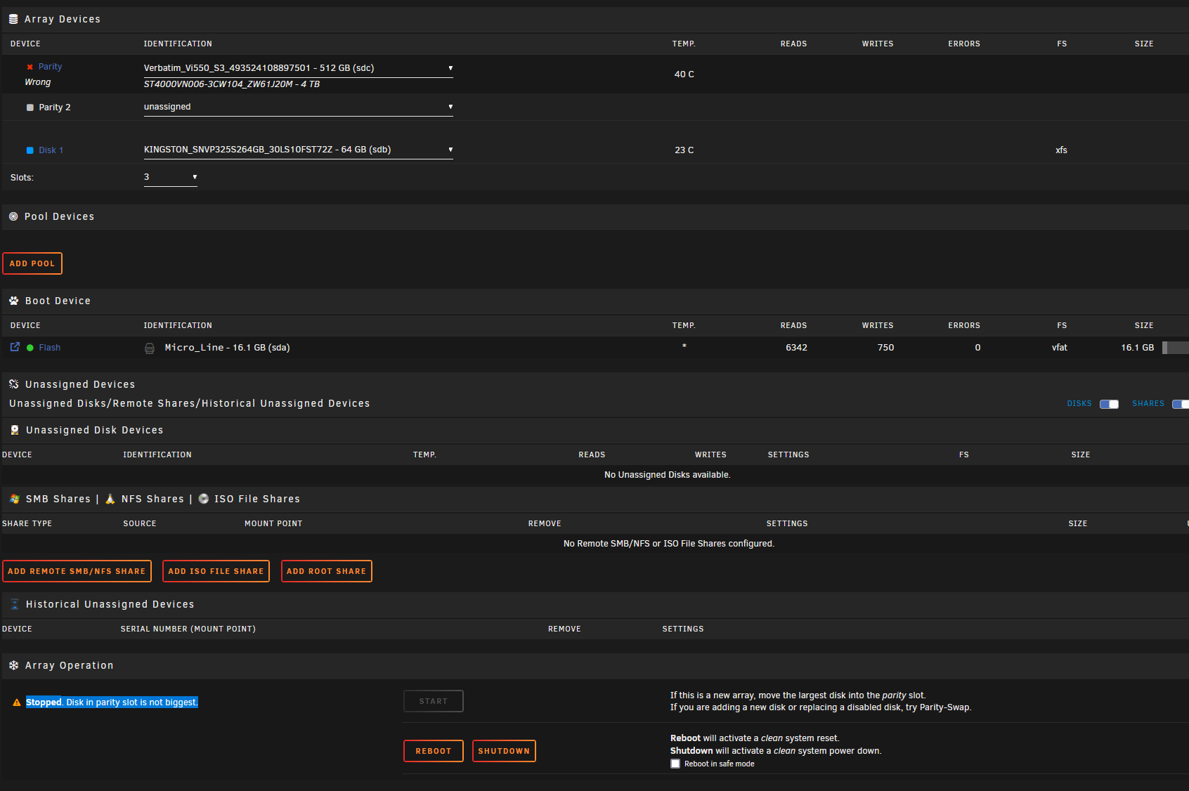

  2. Hello, while my 2 drives from this thread (https://forums.unraid.net/topic/166160-2-hdd-died-at-the-same-time-but-different-how-would-you-proceed/)are shipped to seagate for warranty support I wanted to use a new 512 gb ssd with my old cache as an array to get unraid to run. Unraid does not allow me do so because of: "Stopped. Disk in parity slot is not biggest." drives look like this => I also formatted the new drive like this: I saw in another thread that you need to disable HPA => ### so.. Why does it not detect, that the new drive is bigger than my cache drive? How can I achieve that?

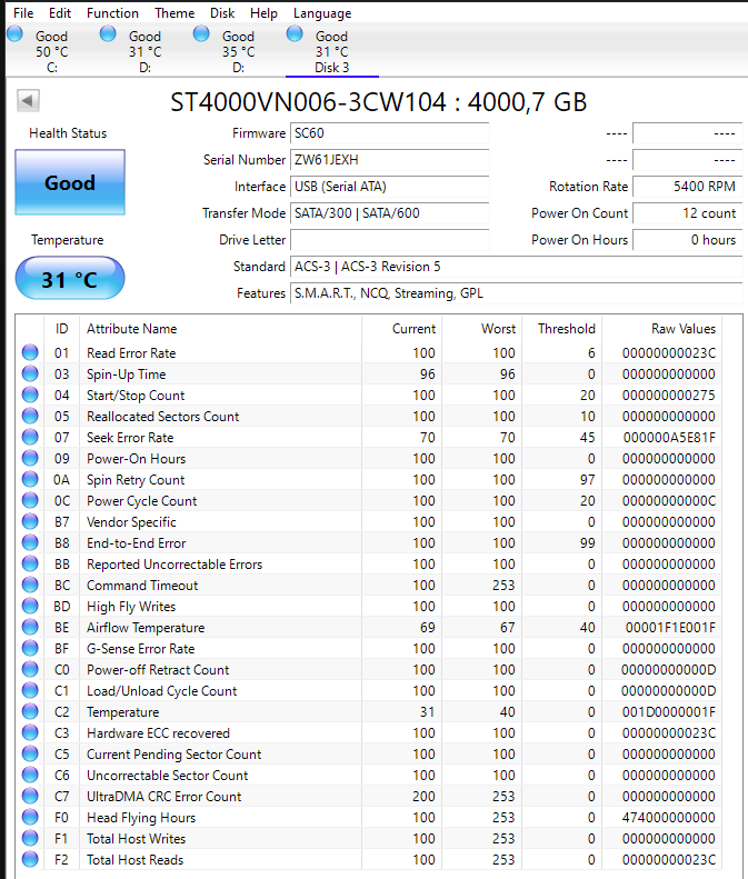

  4. i cant assign drive b to anything, but the SATA and HDD leds are on with a stable light drive b is also the parity drive
