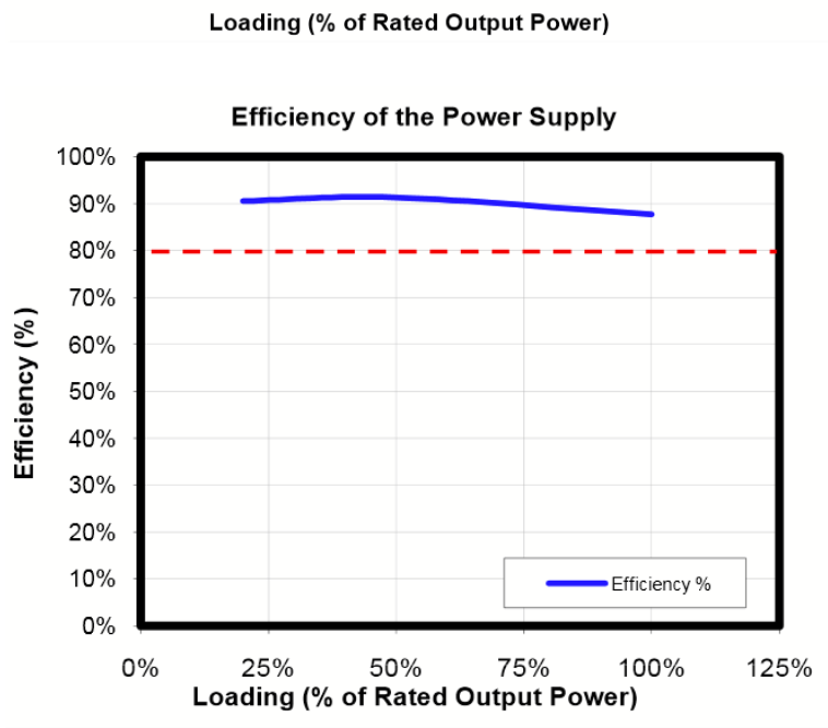

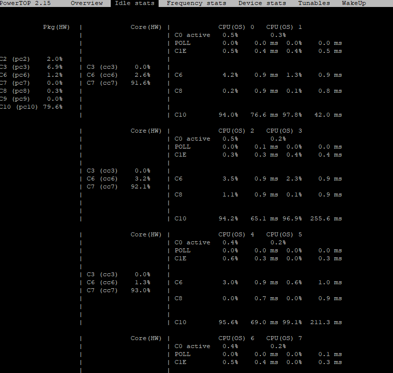

  13. You where correct. I´ve switched to putty and now I get C10. I attribute about 2-3 Watts to my APC I have. I´ve found test data for the PSU and it looks like it is actually pretty good. But given that literally nothing else is connected to the board itself the idle draw still seems high. I am measuring with a Tapo plug via the app and my APC can display power draw.
  14. Joining in with: Gigabyte B760M DS3h DDR4 Core i3 1200 (no letter) 32 Gig Corsair Ram PSU beQuiet BQT9-700W unraid downgraded to 6.12.4 I have set everything in Bios to what I have found in almost any thread around here. I have NOTHING connected, despite the USB stick and network. No Sata, no NVME, no HDMI, no keyboard. I am stuck at 20 Watts idle. I had C10 yesterday, but still 20 watts. today I only get to C8. I´m using a 10+ years old PSU beQuiet 700W. But from what I could find it is not too shaby at low loads. I´f I could get anywhere near 10 Watts idle I would consider sourcing a better PSU. Here is my Go File: #!/bin/bash # Start the Management Utility /usr/local/sbin/emhttp echo 1 | sudo tee /sys/bus/pci/drivers/r8169/0000\:02\:00.0/link/l1_2_aspm powertop --auto-tune &>/dev/null # ------------------------------------------------- # Set power-efficient CPU governor # ------------------------------------------------- /etc/rc.d/rc.cpufreq powersave # ------------------------------------------------- # Disable CPU Turbo # ------------------------------------------------- [[ -f /sys/devices/system/cpu/intel_pstate/no_turbo ]] && echo "1" > /sys/devices/system/cpu/intel_pstate/no_turbo [[ -f /sys/devices/system/cpu/cpufreq/boost ]] && echo "0" > /sys/devices/system/cpu/cpufreq/boost # ------------------------------------------------- # Enable power-efficient ethernet # ------------------------------------------------- # enable IEEE 802.3az (Energy Efficient Ethernet): Could be incompatible to LACP bonds! for i in /sys/class/net/eth?; do dev=$(basename $i); [[ $(echo $(ethtool --show-eee $dev 2> /dev/null) | grep -c "Supported EEE link modes: 1") -eq 1 ]] && ethtool --set-eee $dev eee on; done # Disable wake on lan for i in /sys/class/net/eth?; do ethtool -s $(basename $i) wol d; done # ------------------------------------------------- # powertop tweaks # ------------------------------------------------- # Enable SATA link power management echo med_power_with_dipm | tee /sys/class/scsi_host/host*/link_power_management_policy # Runtime PM for I2C Adapter (i915 gmbus dpb) echo auto | tee /sys/bus/i2c/devices/i2c-*/device/power/control # Autosuspend for USB device echo auto | tee /sys/bus/usb/devices/*/power/control # Runtime PM for disk echo auto | tee /sys/block/sd*/device/power/control # Runtime PM for PCI devices echo auto | tee /sys/bus/pci/devices/????:??:??.?/power/control # Runtime PM for ATA devices echo auto | tee /sys/bus/pci/devices/????:??:??.?/ata*/power/control

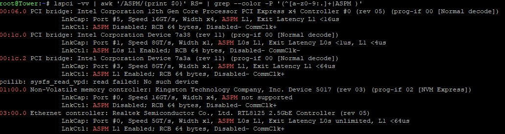

  17. Ja mir war das schon wieder klar beim Kauf, dass Asus da nicht der Bringer ist und unter anderem nur einem Sata-Port daherkommt. Es war nur schneller verfügbar und ich hab gerade Zeit. Die ich natürlich damit wieder verplempert habe. Hätte alles geklappt, hätte ich die Platten per ASM1166 an den PCI-E gebunden. Ich hatte noch einen 6-fach liegen, aber selbst ein Firmware-Update hat nichts gebracht. Ich hätte dann entweder einen 10fach oder noch einen m.2 auf Sata dazu genommen oder es bei einem Array belassen. Die Energiepsarzustände sind doch enabled oder hab ich Knick in der Optik? Na jedenfalls hab ich jetzt das B760M DS3H DDR4 mit i3 geordert und schaue mir das mal an. 2 Arrays .. ich meinte zwei Pools mit Parity.
