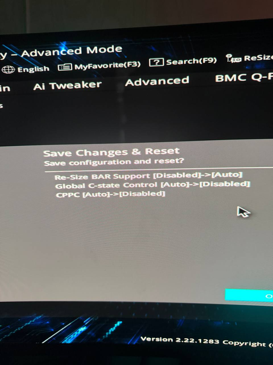

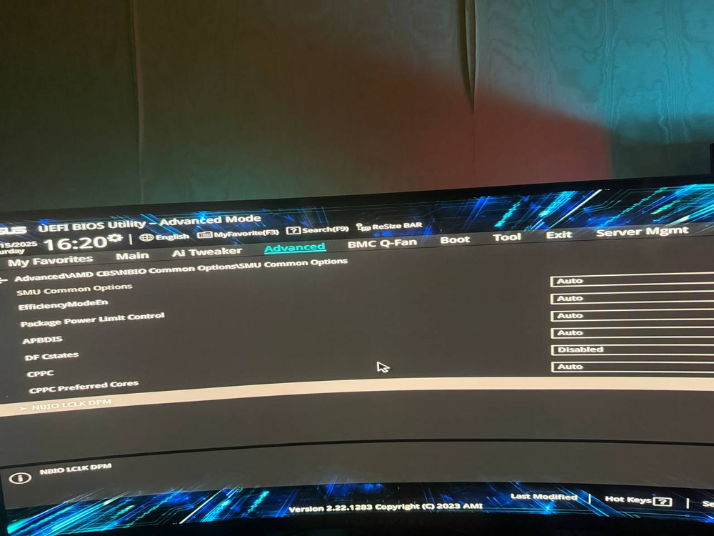

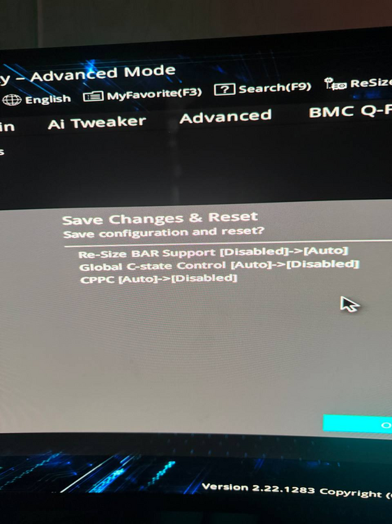

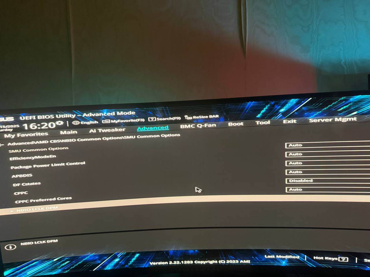

  2. only issue im having after doing these changes is even i enter the unraid disk password and the unraid is booting up the shares etc the unraid webui suddently cannot be accessed anymore, everytime i go on it i get the error ERR_CONNECTION_REFUSED however all docker work and all websites of the docker work. solved after bios update, i will let you know if the system unresponsive issue still happens with global c-state control disabled.
  3. for some reason the diagnostics did not attach hello, thanks for your reply: i've made the changes and hopefully its gonna solve the issue; only thing i did not find "Power Supply Idle Control" at all, however i managed to disable C-States and CPPC, heres the screenshot of a tab that might include that power supply idle control however i was not sure. and here are the changes made to bios
  4. My Unraid server randomly becomes completely unresponsive while the physical server continues running. When this occurs: WebUI becomes inaccessible All Docker containers stop responding SSH/network access lost Server requires hard restart to recover System Information: Hardware: ASUS Pro WS WRX80E-SAGE SE WIFI II CPU: AMD Ryzen Threadripper PRO 5975WX 32-Cores RAM: 256GB (8x8 slots populated) Unraid Version: 7.2.0 Storage Configuration: 8x data drives (12TB-22TB Seagate drives) 2x NVMe cache pools (Samsung 990 PRO 2TB, 980 PRO 1TB) I will attach the full diagnostics done with syslog server of previous shutdown diagnostics-20251114-1421.zip

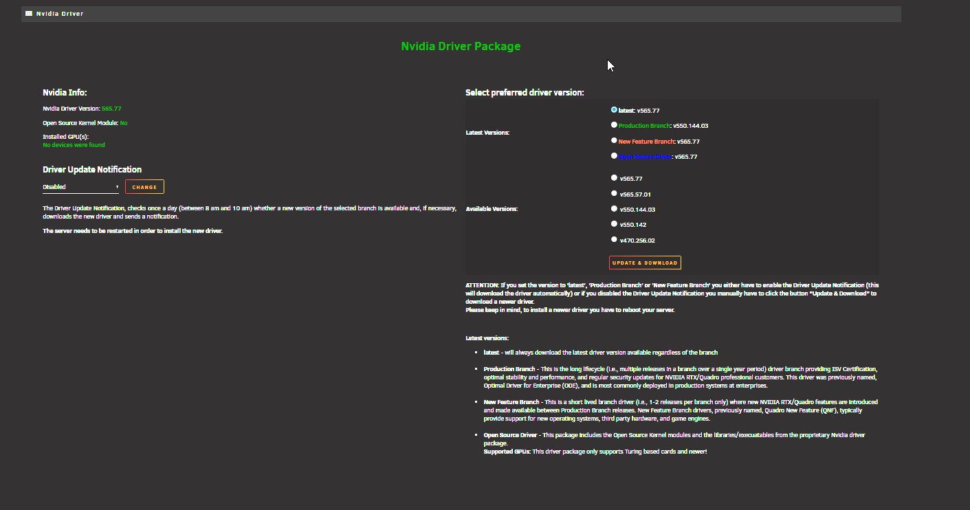

  9. hello, i've had this issue a few times; why does the nvidia driver after a while it cant find my gpu anymore? it works for a bit sometimes 1 day sometimes 2 days then i have this issue; ill attach the unraid logs if they can help to solve this syslog-20250201-2217.zip
