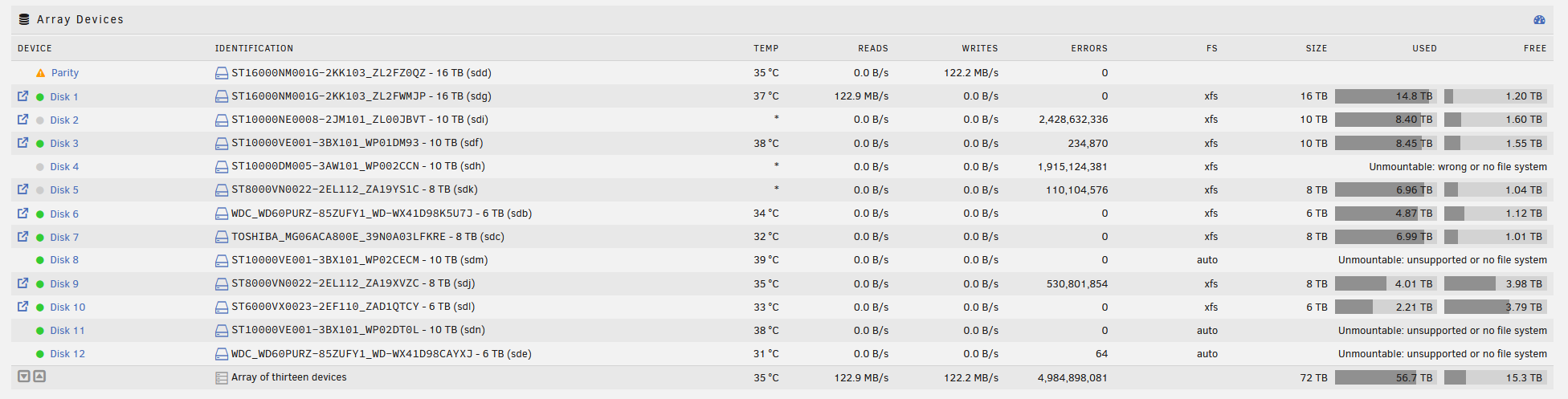

So the parity check finished and then I formatted the 3 new drives and then mounted them. Everything is looking good. Is there anything that I need to be worried about from the previous post? Disk4 is a drive that was previously in the array and Disks 8, 11 and 12 are the new ones. I added diagnostics for clarity. datavault972-diagnostics-20251216-1103.zip

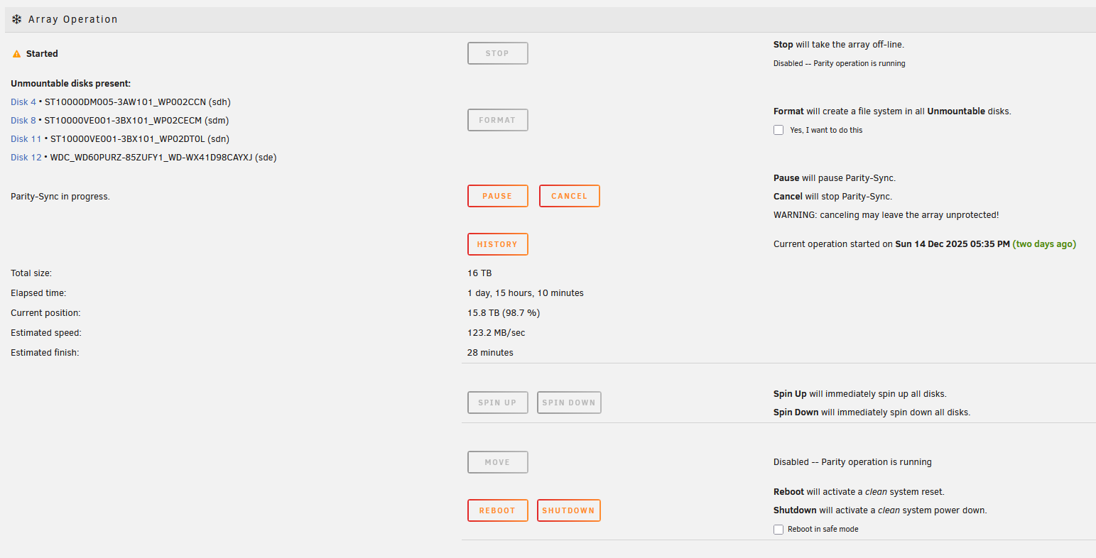

OK I did some further testing, I plugged Disk 8 into an external enclosure and it failed to spin up and even be recognized by Unraid. Whereas, when I plugged in the parity drive, it was picked up and spun up. This confirms that the drive IS dead. Apologies, I know that this is a very similar message to what I sent an hour ago, but it is confirmation. My problem is now, how can I replace the DISK 8 and then get the parity to rebuild itself
Parity Device is still disabled after the normal "Fix"
Hi @JorgeB I did some testing and it seems like Drive 8 has failed. When I plug it in and run the server, it does not spin up at all. I have felt it and listened to it. I think that it may have died. If that is the case. How can I start up my array as, with both the parity drive and drive 8 down, I am not able to start it up.
