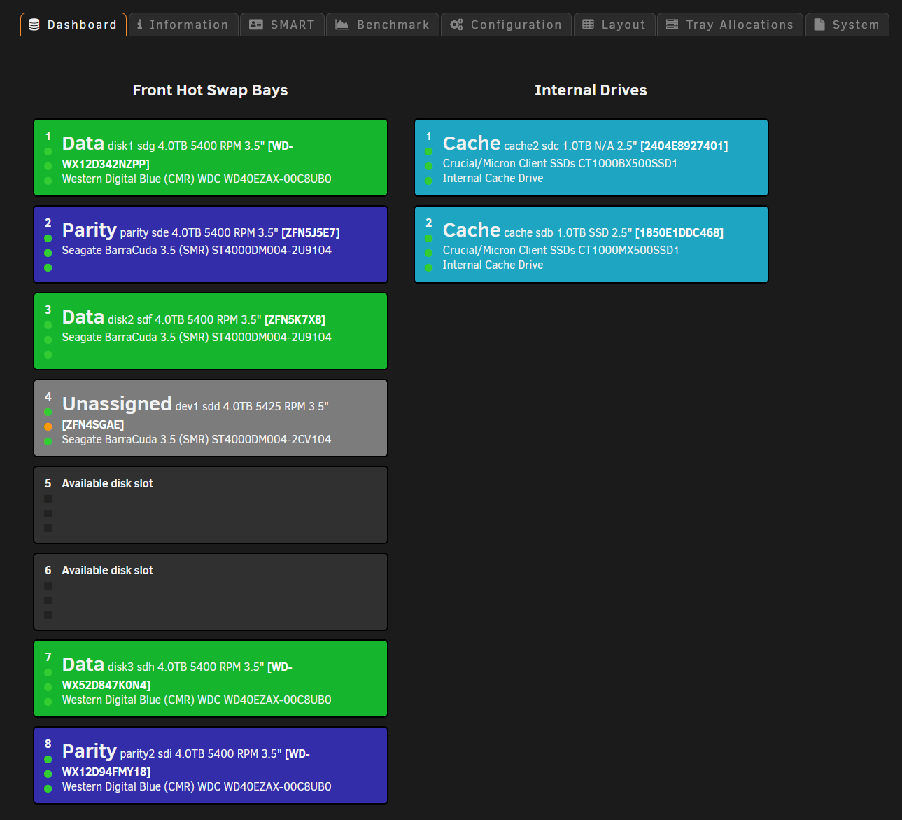

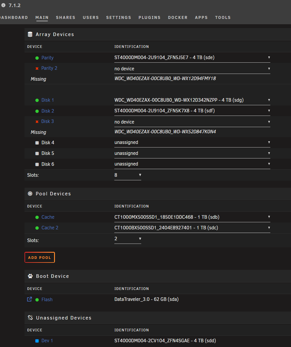

  6. servertwr-diagnostics-20250604-1143.zipAttached are diags from 7.0.1, running OK
  7. I own a Silverstone CS382 case, and I am using a 4 Port PCIe SATA Card with 4 SATA Cable, 6Gbps SATA3.0 Expansion Card, ASMedia ASM1064 chip to connect the bottom half of the hot swappable bays. The drives in the bottom half no longer show up, and are missing on the array: Here is a snippet of my layout from 7.0.1, prior to upgrading from disk layout plugin: Here is what I see on the Array following the upgrade. When I click the drop down for these missing disks I can only select the unassigned drive, which is unused due to smart errors: Attached diagnostics, I have confirmed I am able to downgrade back to 7.0.1 and continue normal use without error, so unsure what could be occurring. Any tips appreciated. servertwr-diagnostics-20250603-1859.zip
