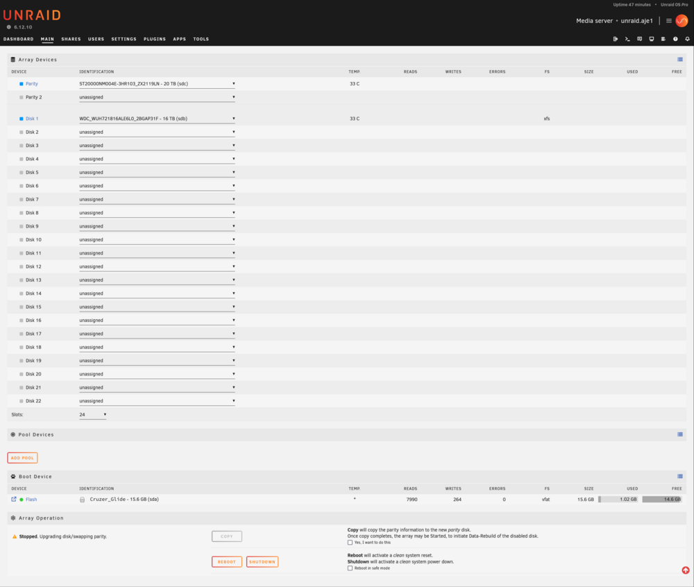

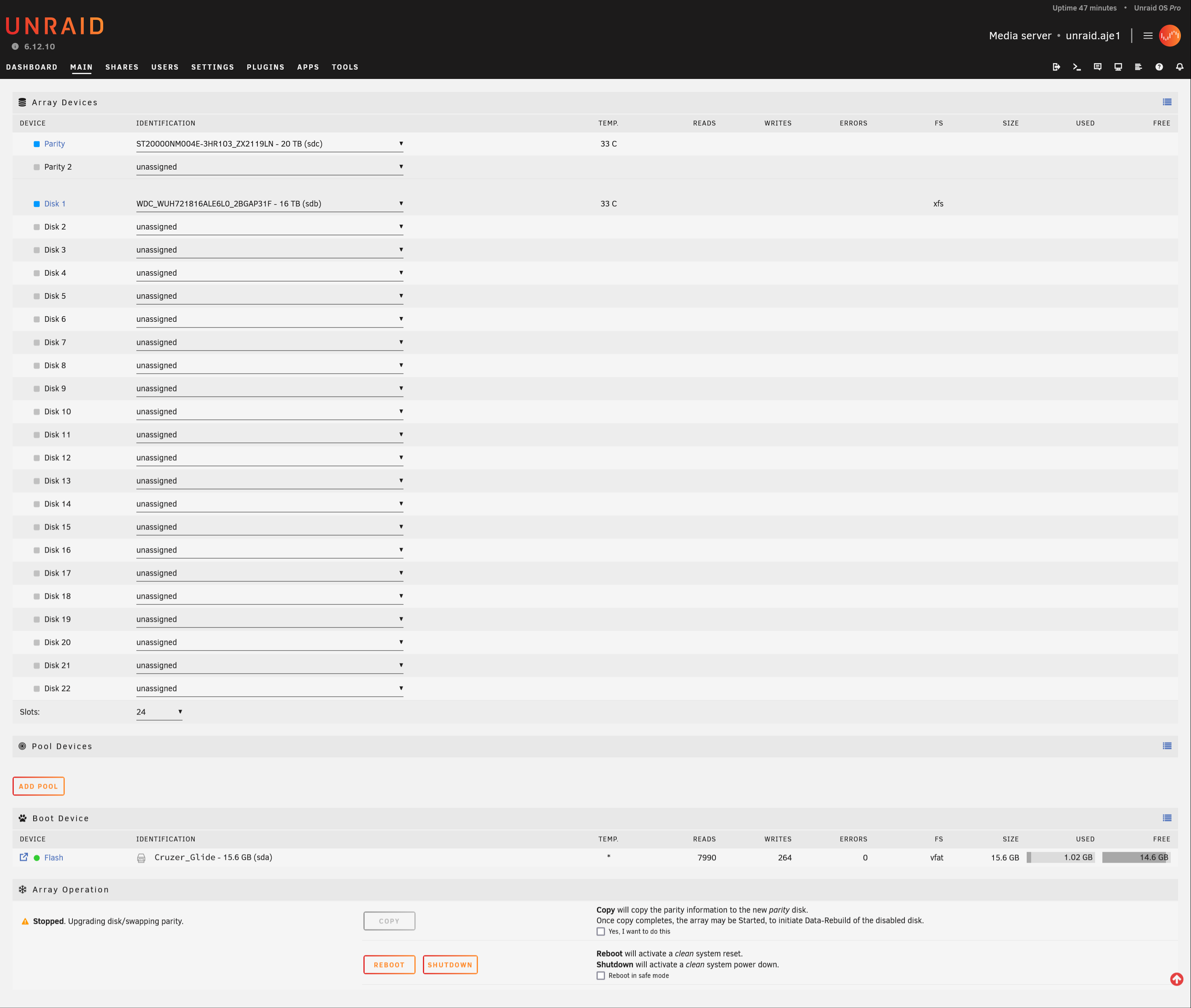

  4. Not sure if that's true (or even how to restart the process), I found this thread which seems very similar.
  5. https://docs.unraid.net/legacy/FAQ/parity-swap-procedure/ I had 2x16TB drives and the non-parity failed. I replaced it with a 20TB drive and began the 'parity swap' process (the largest drive needs to be parity). I am/was at the end of step 14 (the parity copy had completed and ready to do 'The Start button will now be present, and the description will now indicate that it is ready to start a Data-Rebuild.'), but decided to shutdown to remove the dead drive and check on fans. After reboot, "Array Operations" says 'Stopped. Upgrading disk/swapping parity.' and 'Copy' is greyed out (makes sense as it's already been copied). Please help me get my array back online. Diagnostics attached. Thanks. unraid.aje1-diagnostics-20240706-1111.zip
