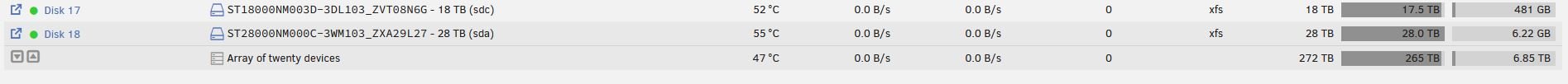

  5. One last question. At some point disk18 was incorrectly reporting its free space and it looks to be corrected. It only has 6GB of free space, which seems really low. Should I move files to another disk manually (Krusader)? Or leave it be? Pic of drives attached. Thx

  12. I saw those error messages too, but have a minimum set and it never got below 20GB
