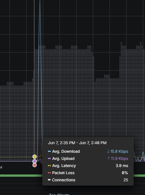

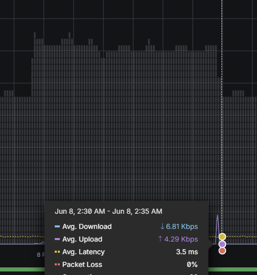

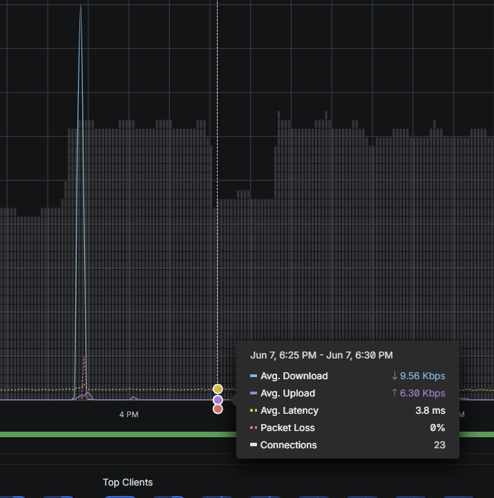

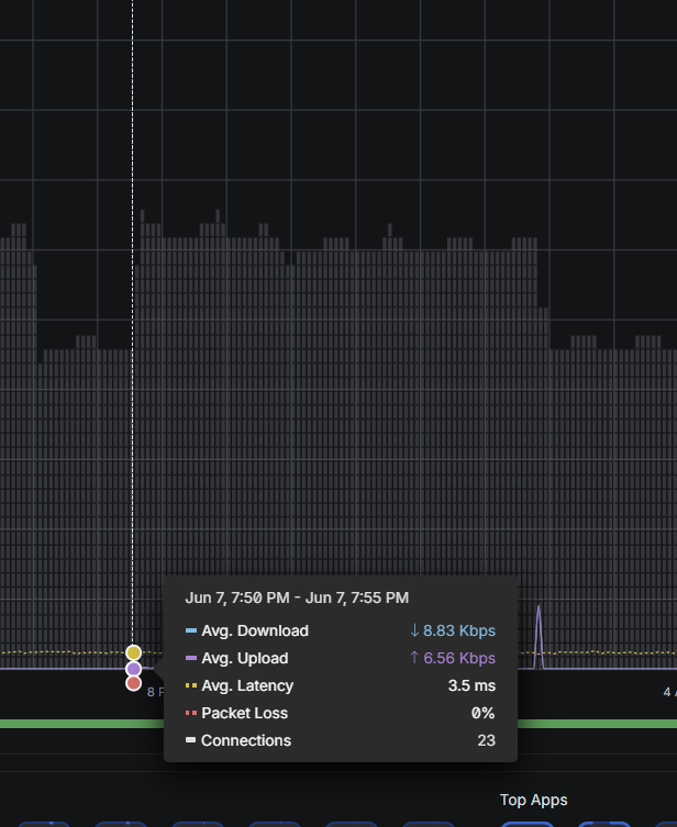

  2. Sorry, I knew exactly what you meant by diag. I had just gotten back from my trip, and after I got to tools just forgot what I was looking for. Here you are. Also provided a screenshot of Unifi or rough time estimates. When you see like 8 or so connections drop, it's when it's going down. First segment was when I got home, restarted, then took a nap, got up, realized it was down again, restarted. Woke up this morning, saw it was down, and just restarted. This is likely the last time it will go down after being home... At least this was the same experience I had from getting home from Florida back in March. Also, the only way to get the server back is to HARD restart via the front panel, as I have no way to get into it. Even the monitor hooked up to it is just green. This could totally not be location-based, but the only two times I've had this issue are when going out of state, and it happens right around crossing a state line. It could totally be an insane coincidence, though. Mighty inconvenient as my server is then down for the rest of my trip. unraid-diagnostics-20260608-1147.zipsyslog-UNRAID.log
