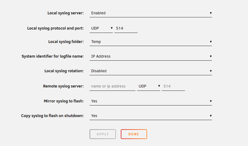

  10. tower-diagnostics-20260403-1718.zip I have assigned a new folder "Logging" for the syslog and attached a new diagnostics. Any further ideas?
  11. It's empty, no files inside
  12. I tried various settings but it still won't show up.
  13. Syslog is enabled but after the last crash Unraid does not log anything at all anymore. Log is simply empty. Any idea how to fix this?
