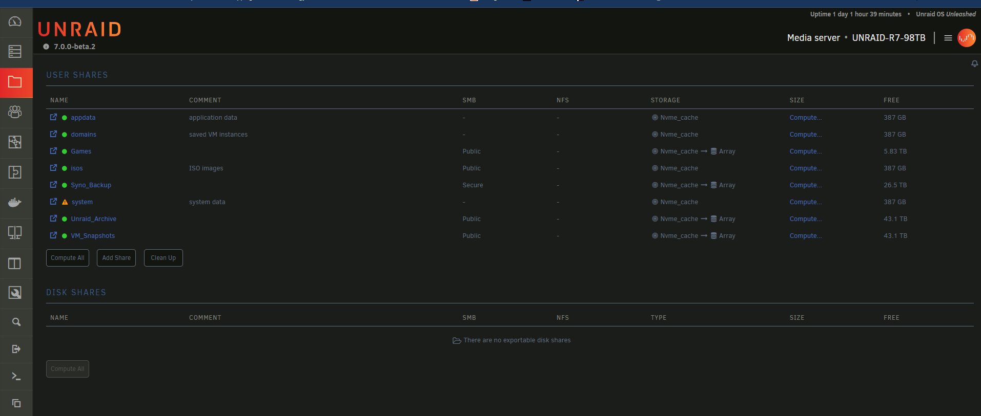

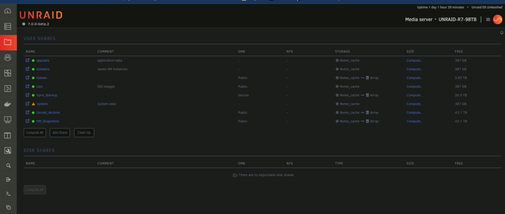

  7. Sorry, backup_cache doesn't exist anymore. This was on an Sata SSD. I have since deleted that Cache and migrated over to an NVME. This seem to work on other Shares which were also on backup_cache but for the System share, this is still showing the triangle. Is this a bug?
  8. Yes, please see attached. unraid-r7-98tb-diagnostics-20240815-2017.zip

  14. I cannot find where or which file is unprotected. The system folder is in my NVME Cache pool which is mirrored. Only the System folder shows the orange triangle, every other folder is green...
