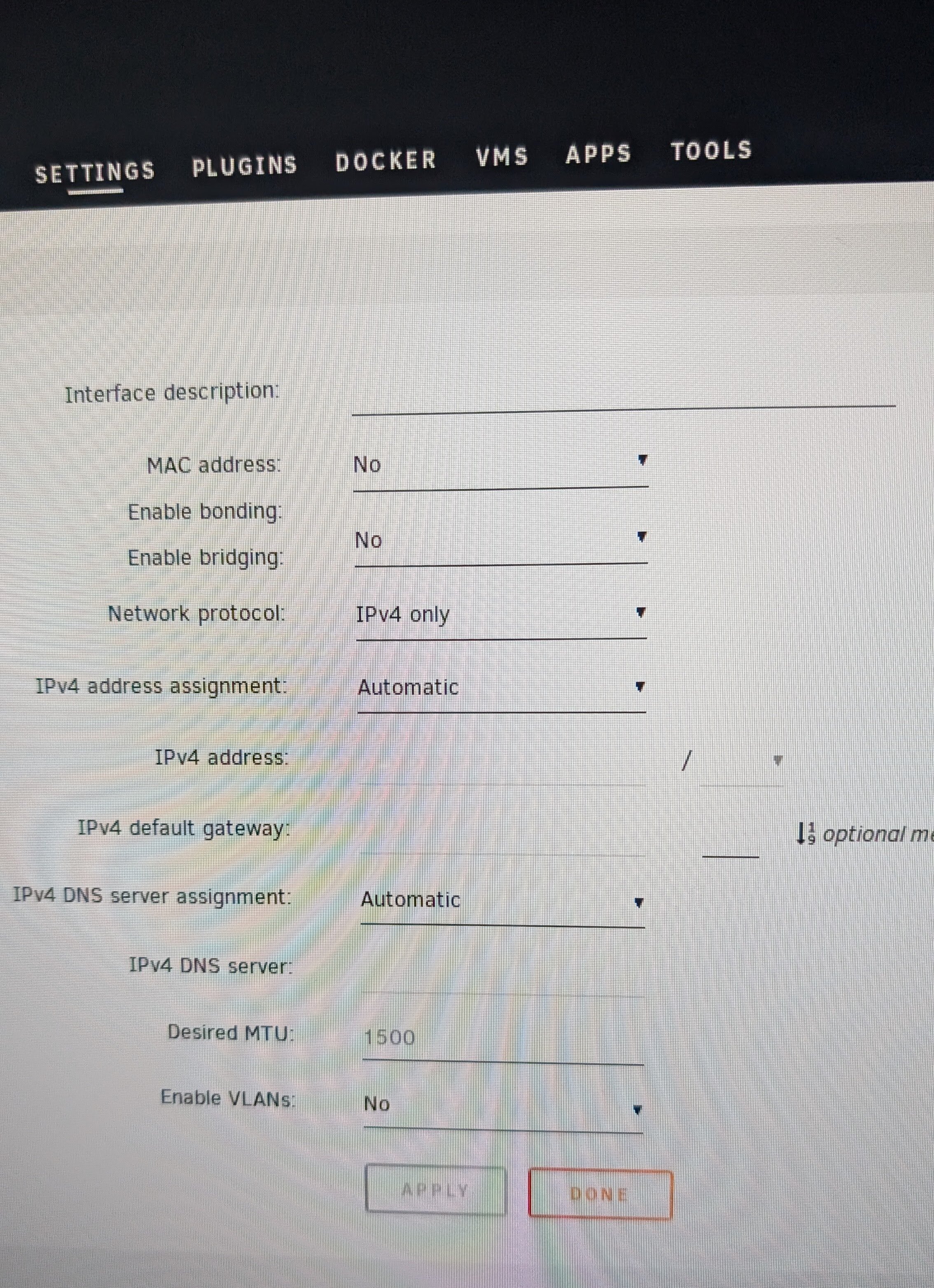

  1. @Hoopster I don't have the bonding setting options like you do (see attached picture). I had to lookup "enable bonding" and then the words popped up in setting, but there was nothing for me to choose. Also, being that I don't have internet access, I can't get the plug-in through Apps. I did go to realtek and download the driver. but I can't figure out how to load it manually. Thank
