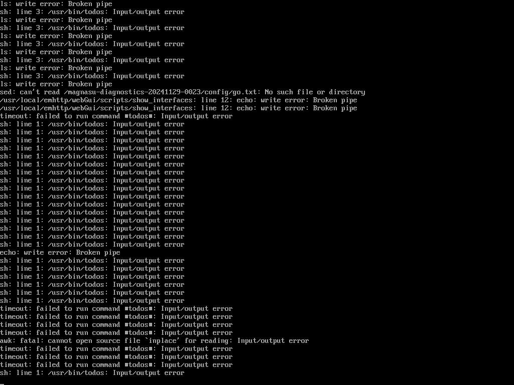

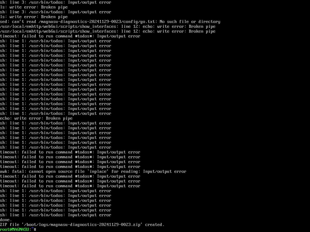

  1. Hi All, I've been having a weird issue recently where Unraid becomes unreachable. I'm unable to login to Unraid page, not SSH to it. The only way I have to access it is physically. I'm not entirely sure what happens, and I tried capturing the diagnostics through CLI but I keep getting those errors (screenshots attached) Even after all those errors, and that it says the diagnostics file has been created, I can't find anything there. Any idea where to start with diagnosing the issue?
  2. Thank you for the answer. Is there anything you could suggest to troubleshoot this further?
