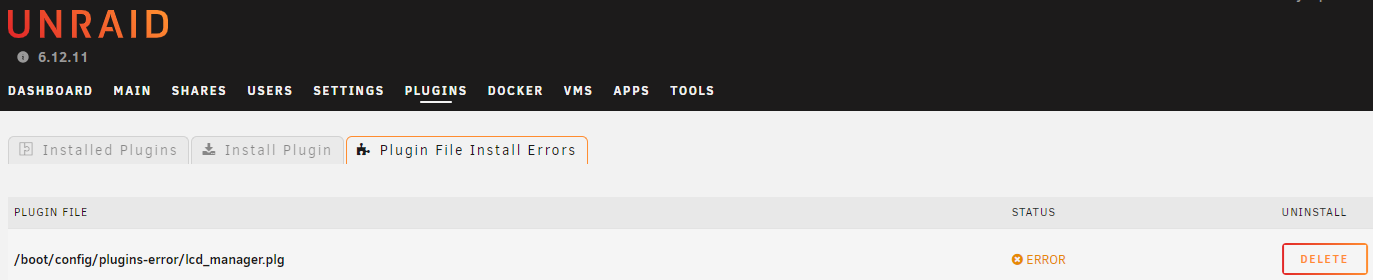

  7. Hi! I installed this plugin on a new QNAP running unraid 6.12.11. It works great, however the plugin doesn't survive a reload. The plugin shows up under the 'Plugin File Install Errors' after a reboot, but I don't know where to find the log file. Any suggestions? Cheers!
