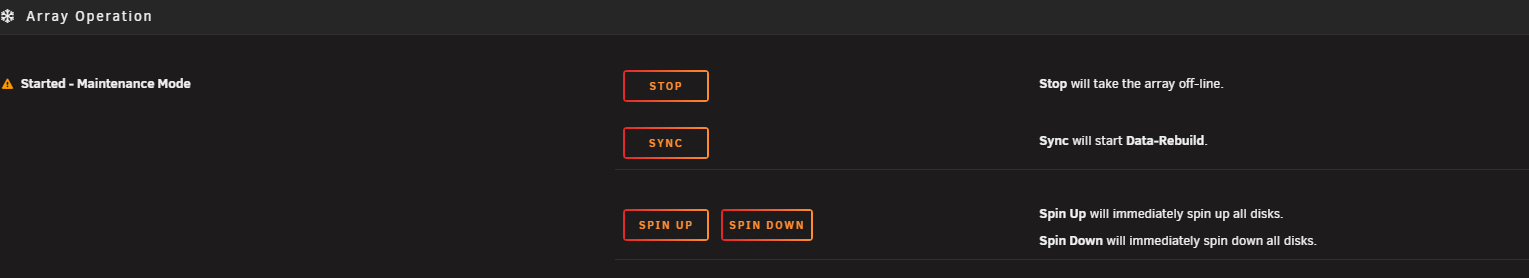

  1. I probably have to click 'Sync' then, even though it doesn't say that in the instructions. Right? Is there someone I should reach out to to get the instructions updated?

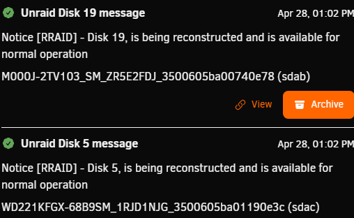

  2. I followed these steps to get them rebuilt, and I did get notifications that they are being rebuilt: But I dont see a progress status notification or anything. And the 'main' page just has them listed with exclamation marks: Is there somewhere I can see progress? Or something else I need to do?

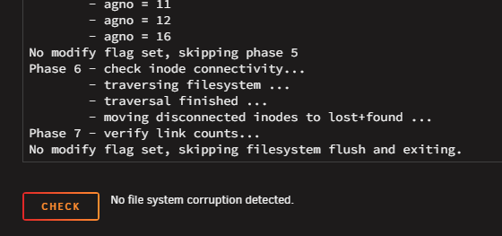

  6. There is no "fix" option, just a "check" option since there doesn't seem to be any corruption:
  7. d5: Phase 1 - find and verify superblock... Phase 2 - using internal log - zero log... - scan filesystem freespace and inode maps... - found root inode chunk Phase 3 - for each AG... - scan (but don't clear) agi unlinked lists... - process known inodes and perform inode discovery... - agno = 0 - agno = 1 - agno = 2 - agno = 3 - agno = 4 - agno = 5 - agno = 6 - agno = 7 - agno = 8 - agno = 9 - agno = 10 - agno = 11 - agno = 12 - agno = 13 - agno = 14 - agno = 15 - agno = 16 - agno = 17 - agno = 18 - agno = 19 - agno = 20 - process newly discovered inodes... Phase 4 - check for duplicate blocks... - setting up duplicate extent list... - check for inodes claiming duplicate blocks... - agno = 0 - agno = 1 - agno = 2 - agno = 3 - agno = 5 - agno = 6 - agno = 9 - agno = 10 - agno = 12 - agno = 13 - agno = 7 - agno = 4 - agno = 14 - agno = 15 - agno = 17 - agno = 18 - agno = 16 - agno = 8 - agno = 11 - agno = 19 - agno = 20 No modify flag set, skipping phase 5 Phase 6 - check inode connectivity... - traversing filesystem ... - traversal finished ... - moving disconnected inodes to lost+found ... Phase 7 - verify link counts... No modify flag set, skipping filesystem flush and exiting. d19: Phase 1 - find and verify superblock... Phase 2 - using internal log - zero log... - scan filesystem freespace and inode maps... - found root inode chunk Phase 3 - for each AG... - scan (but don't clear) agi unlinked lists... - process known inodes and perform inode discovery... - agno = 0 - agno = 1 - agno = 2 - agno = 3 - agno = 4 - agno = 5 - agno = 6 - agno = 7 - agno = 8 - agno = 9 - agno = 10 - agno = 11 - agno = 12 - agno = 13 - agno = 14 - agno = 15 - agno = 16 - process newly discovered inodes... Phase 4 - check for duplicate blocks... - setting up duplicate extent list... - check for inodes claiming duplicate blocks... - agno = 1 - agno = 3 - agno = 7 - agno = 4 - agno = 5 - agno = 0 - agno = 6 - agno = 14 - agno = 8 - agno = 9 - agno = 13 - agno = 10 - agno = 2 - agno = 15 - agno = 11 - agno = 12 - agno = 16 No modify flag set, skipping phase 5 Phase 6 - check inode connectivity... - traversing filesystem ... - traversal finished ... - moving disconnected inodes to lost+found ... Phase 7 - verify link counts... No modify flag set, skipping filesystem flush and exiting.
