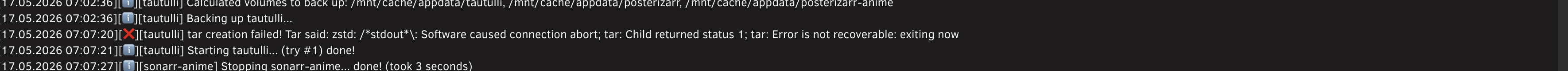

  1. Just tried that and still got the same error on one docker container tautulli
  2. Hello, I've been getting this error recently. It's not the same containers each time and has happened when running in stop all then backup and stop, backup start each container modes.
