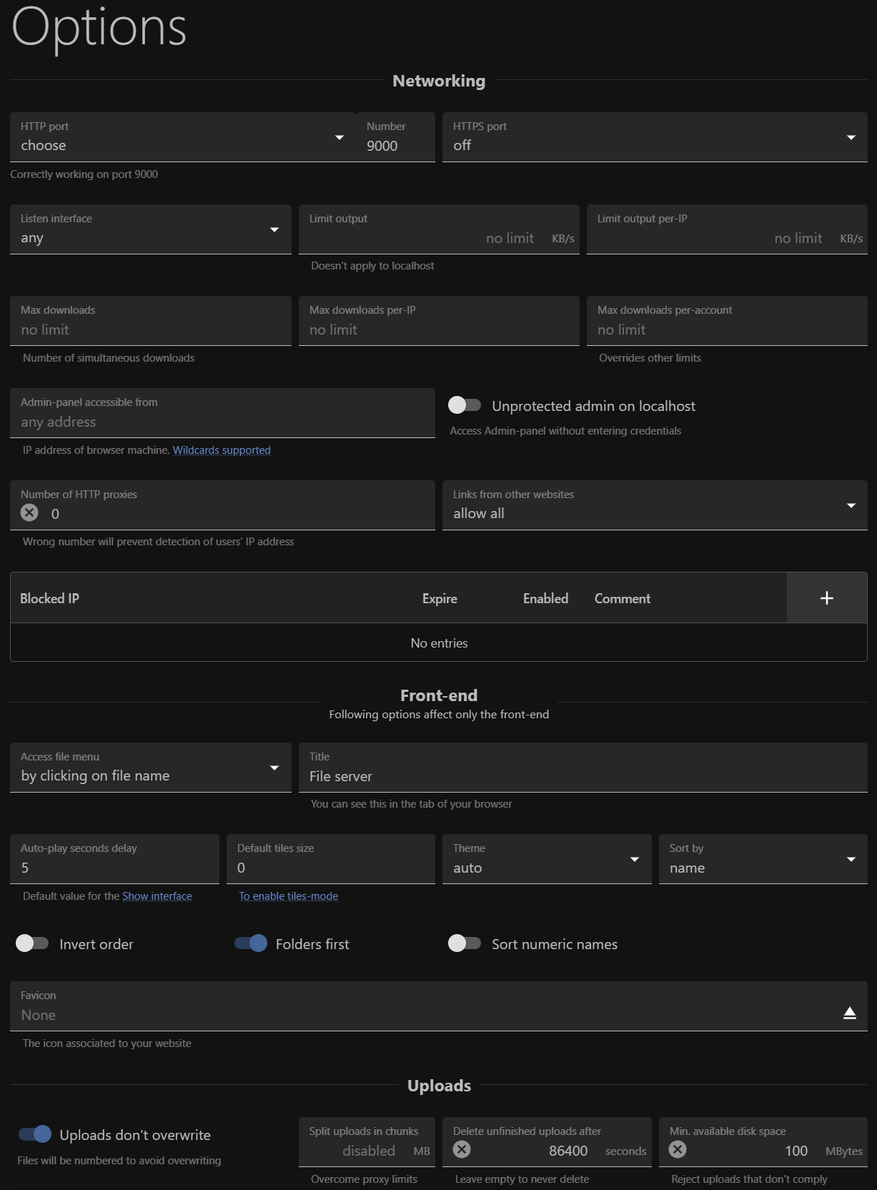

  3. As the title says after upgrading to Unraid 7.1.0 I no longer can access any docker container web UI. I have tried different browsers with the same result. This is what I get on every browser I have tried: about:blank#blocked Any help would be appreciated! Thanks.
