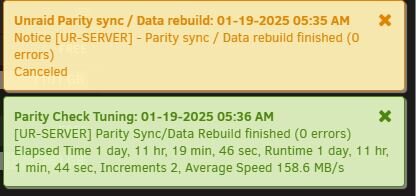

  5. Hey guys, a few weeks ago, a refurbished drive I bought in Nov started giving SMART errors so I replaced it and today it finally finished the data rebuild. I am a bit confused though by the notification I got when I logged into the server this morning as it's showing the data rebuild was cancelled at 5:35AM and then a minute later that it completed successfully. Should I be concerned or is this what is supposed to show?
