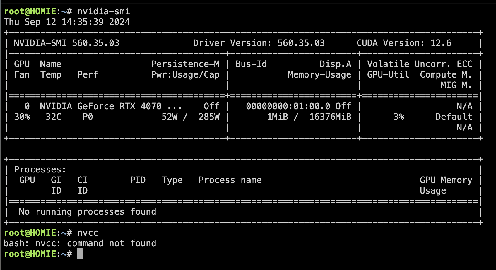

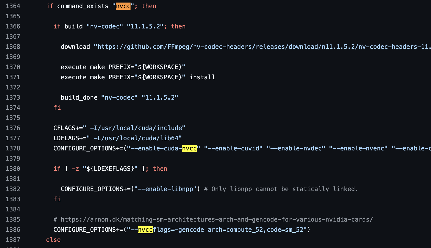

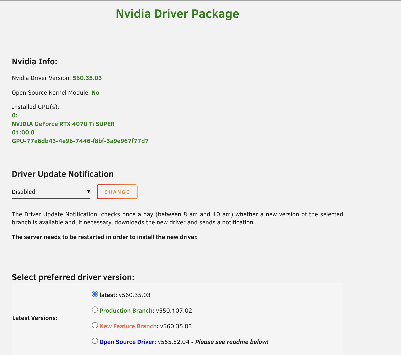

  1. Hey. I've installed unraid on my brand-new server: - ASUSTeK COMPUTER INC. ROG STRIX B650E-I GAMING WIFI - AMD Ryzen 9 7950X - RTX 4070 TI SUPER NVIDIA drivers installed correctly and nvidia-smi command works both inside containers and on host machine, but nvcc command is not found and /usr/local directory does not contain anything related to cuda. Is it possible to install nvcc with drivers & make it system-wide and accessible inside containers? I noticed, that i can't enable HW accel. for ffmpeg inside homebridge, because it looks at nvcc command existence at build time: https://github.com/homebridge/ffmpeg-for-homebridge/blob/latest/build-ffmpeg My output: And the last question is why GPU panel is not appearing at the dashboard? Thanks! homie-diagnostics-20240912-1442.zip
