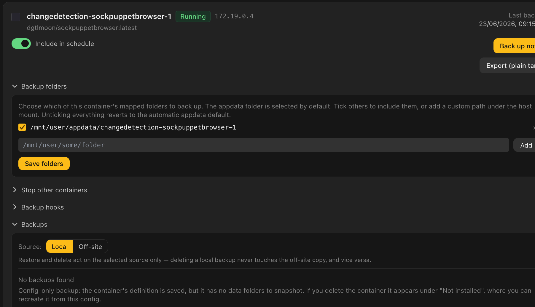

  12. Question: when I restore a container (or VM for that matter) do you start the container after the restore or leave it off (which I would prefer). Reason: I manage most of my containers via docker compose using stacks in Dockhand (Unraid docker compose plugin is very weak). And to recreate a stack I have to restore all the individual containers of a stack one by one (and they depend on each other, so if one starts without the other having been restored.....) Ideally I could restore a whole stack 😉 But this I don't even know on how the best way to implement / Interface in the GUI.....

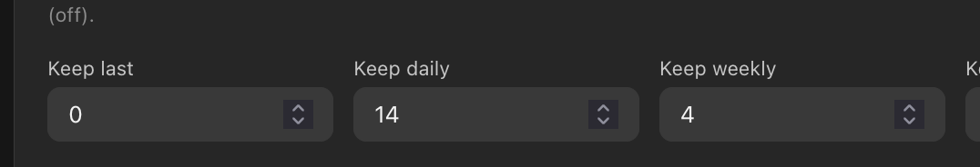

  15. One more change. My normal backup plan in Backrest is daily local and weekly remote. I have different retention times (prune schedules) for each, remote I keep longer (archive). In Bombvault I have one single prune schedule.....

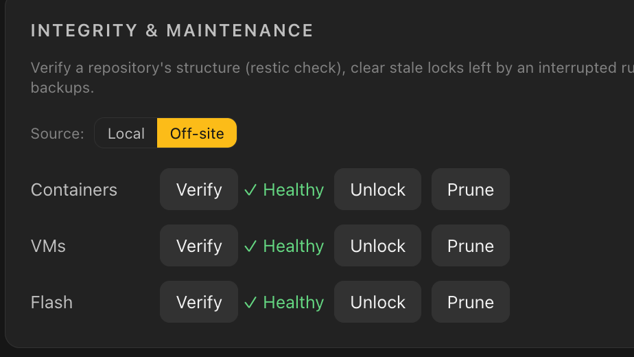

  16. Small GUI error. When I do a manual prune (local/offsite) I get the healthy indicator. But when I switch to the other repo (local/offsite) the healthy stays, in spite of no prune having been run. It should clear this flag when switching repo selector

  18. I can confirm that this is fixed. Prune is working and respecting the setting. I have docker container with 700GB of data and backups got growing, so this was quite important ;)
  19. just updated and tested: bombvault v2.8.0 Backup & disaster recovery for Docker containers and KVM/libvirt VMs Did a flash manual forced prune. Still not working!

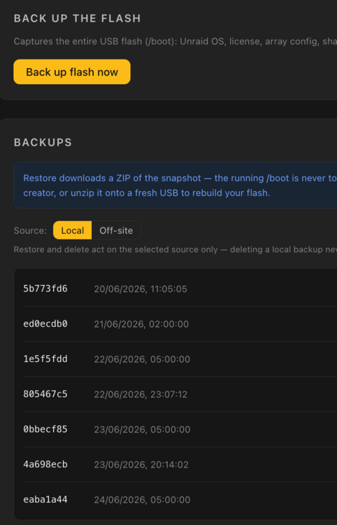

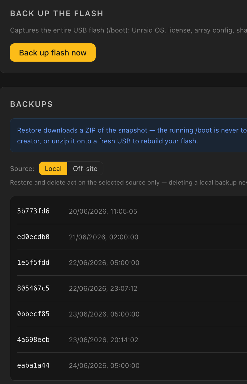

  22. I deleted a VM and want to delete all backups local/remote: I have to select all ndividually local and remote and delete them.... Should be a one go command (like in containers if I rember well). Also then hoping repo's will be pruned.... You didn't comment on this one broken feature :(
  23. Nice. What about the prune issue. It's broken.....

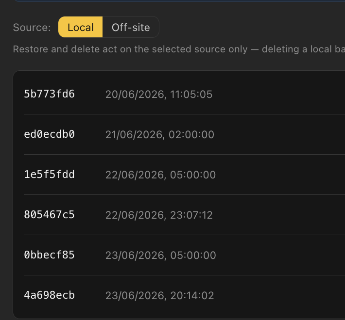

  24. This list should scrollable.... and show all the backups from the last day/s, ideally one could choose a date and list the backups of that day.
