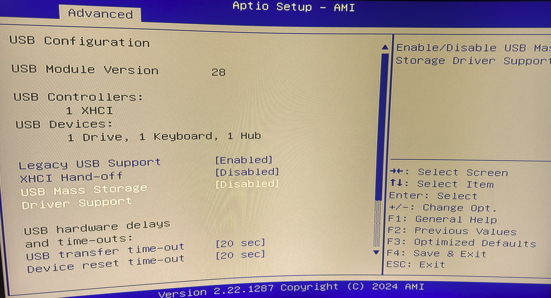

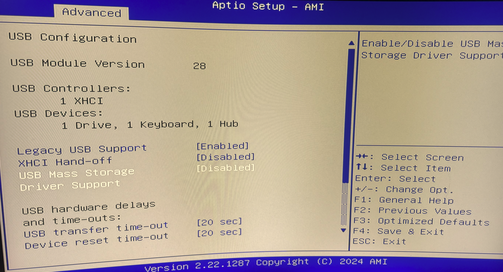

  11. I've disabled the "XCHI Handoff" option. When I additionally turn off "USB Mass Storage", the system boots directly into the BIOS instead of gets stuck on Terramaster Logo.

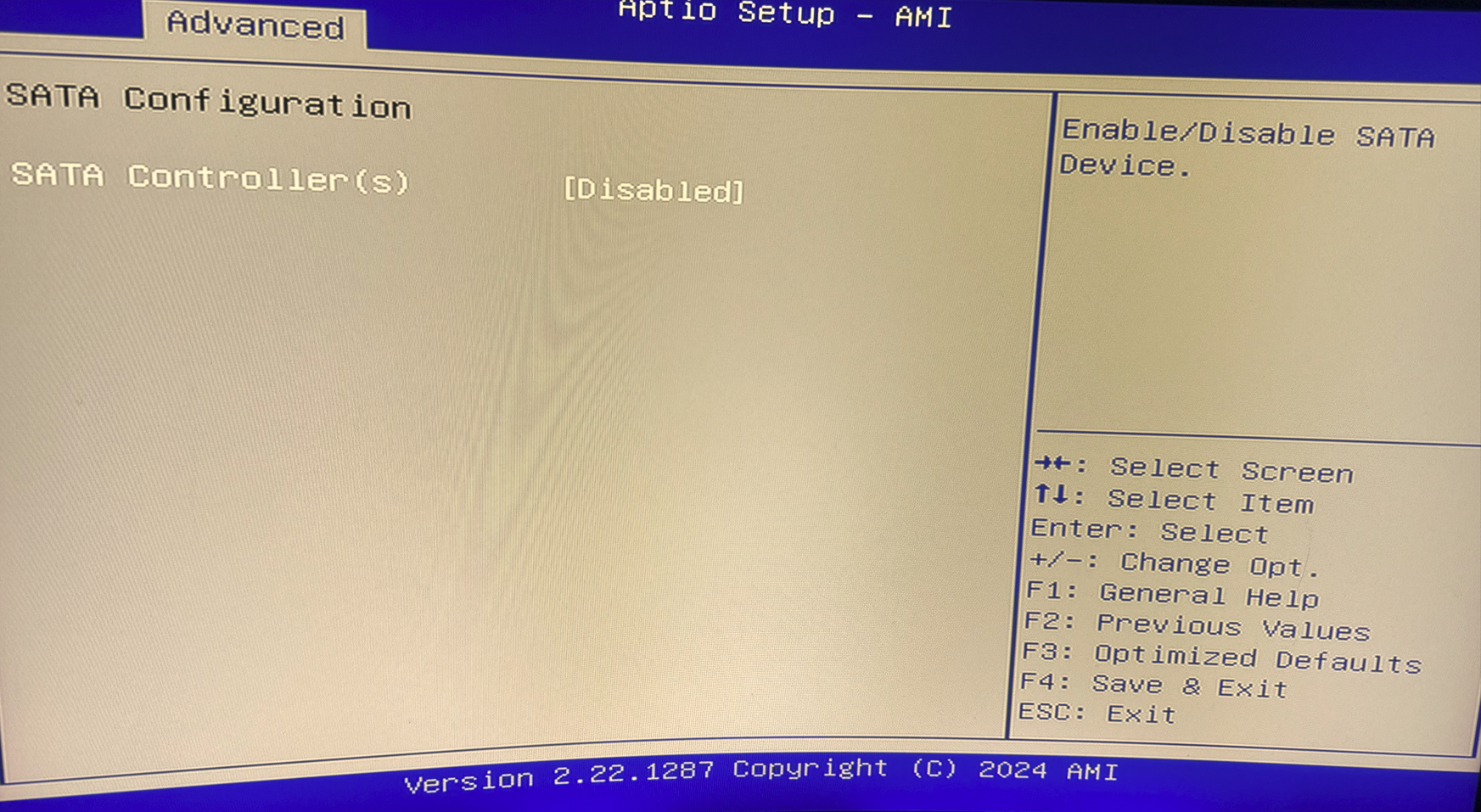

  13. I tried completely disabling the SATA controller and only enabling the USB drive for booting, but unfortunately, that didn't work either. The frustrating part is that there are no error messages or logs being recorded in the BIOS or system. It's so sad because I'd love to use unRaid. However, having to manually select unRaid in the bootloader every time I boot or reboot is pointless. I suspect Terramaster has a hidden setting in its BIOS that prevents unRaid from booting.

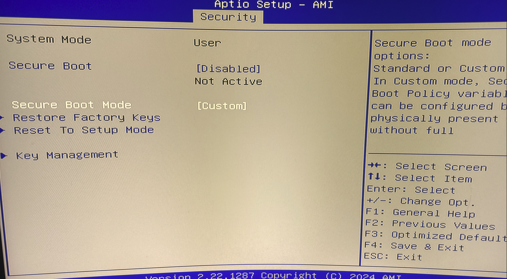

  14. Yes, Secure Boot is disabled. I can switch between Custom and Standard in Secure Boot Mode, but changing this setting doesn't seem to affect boot behavior.
  15. Hello everyone, I could really use some help. I recently purchased a Terramaster F6-424 Max and I'm trying to install unRaid on it. However, I'm running into a persistent issue: every time I want to boot into unRaid, I have to manually press F12 to access the Bootloader and then select unRaid to start. The same thing happens if I'm already in unRaid and choose to restart; the system shuts down and gets stuck on the Terramaster logo until I again press F12 and manually select unRaid. I've tested installing TrueNAS Scale on the same USB drive, and it boots automatically without any need to enter the Bootloader. I've attached some screenshots of my BIOS settings, which I've adjusted according to the unRaid instructions. I'd really appreciate it if someone could take a look and see if I might have missed a setting. Thanks in advance for any help!
