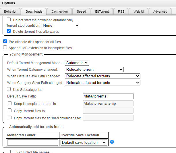

  22. I did, but it wasnt working so i just deleted that part of the config. if i put /data/watch as monitored folder, i also need chromium to download its files to that folder. what path would i need to hand off to the chromium docker for it to download to /data/watch
  23. Config path -/mnt/user/appdata/binhex-qbittorrentvpn data path-/mnt/user/data/torrents/ I started this before watching videos, assuming its file structure was like windows. I was obviously wrong. So its kind of a mess currently. Is there a better way i can do this to un-fuck my folder structure?
