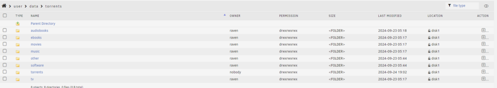

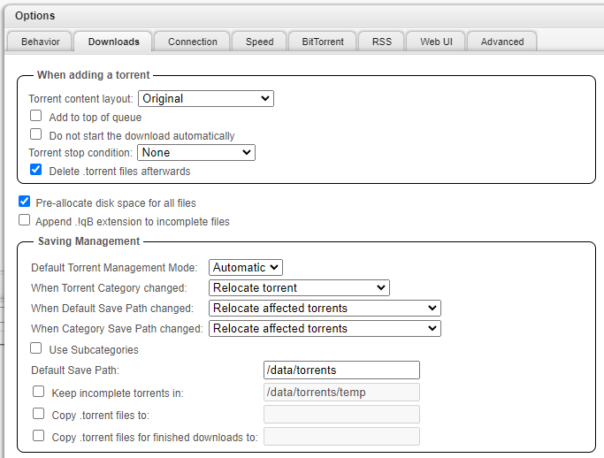

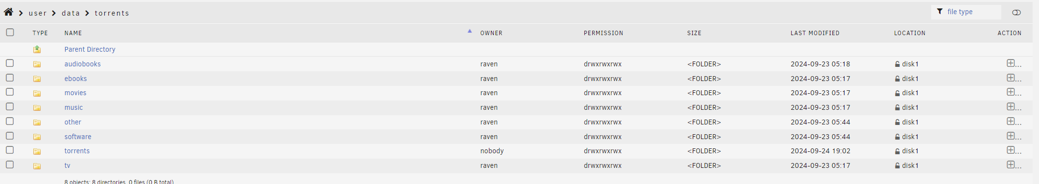

  6. I told it to go to /data/torrents but its downloading to data/torrents/torrents
  7. Quick question, this one should be a quick fix, just not sure why its happening. Seems qbit is downloading my torrents one subdirectory too deep for some reason(the deeper "torrents" file it created itself) Ive attached screenshots of my folder structure and qbit save directory.
