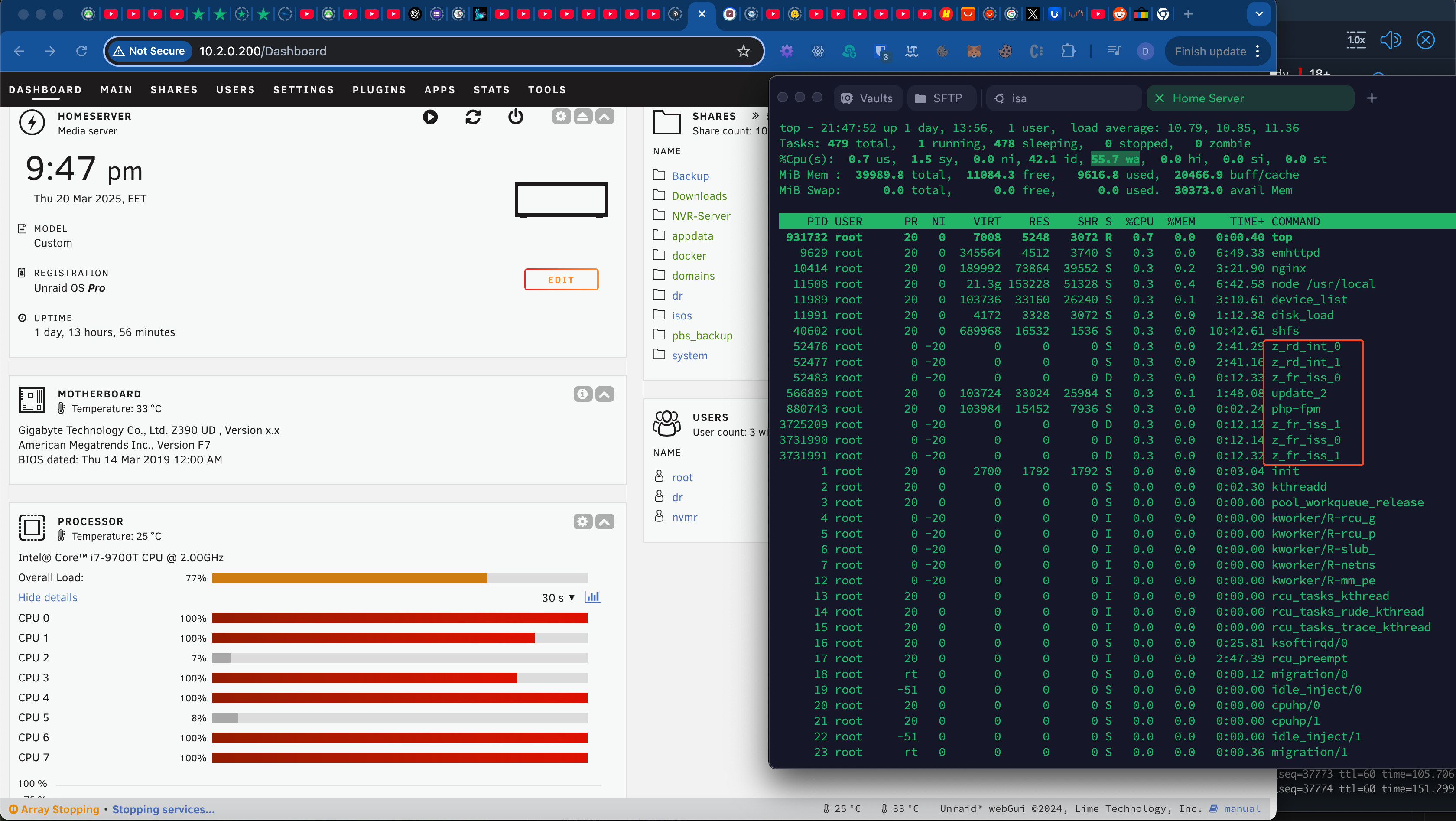

  3. Hi everyone, I'm experiencing some performance issues with my Unraid file server and could use some help diagnosing the problem. I’m running an Intel i7-9700T CPU with 40GB of RAM and several hard drives, some as large as 18TB. Some of the drives are connected to the internal SATA ports, while others are attached to an LSI 9211-8i controller running in IT mode. When resyncing the array, I get speeds of up to 200MB/s, which seems reasonable. However, when writing large files from one HDD to another within the system, the speeds drop to around 30-40MB/s, which feels unusually slow. There also seems to be another issue that might be related to ZFS. Everything was working fine until I tried to stop the array. At that point, the system became almost unresponsive, with extremely high load and high I/O wait times. I have no idea what is causing this behavior. I’ve attached diagnostics from the moment when I attempted to stop the array and everything went haywire. If anyone has insights or suggestions, I’d really appreciate your help. Thanks in advance! homeserver-diagnostics-20250320-2149.zip
