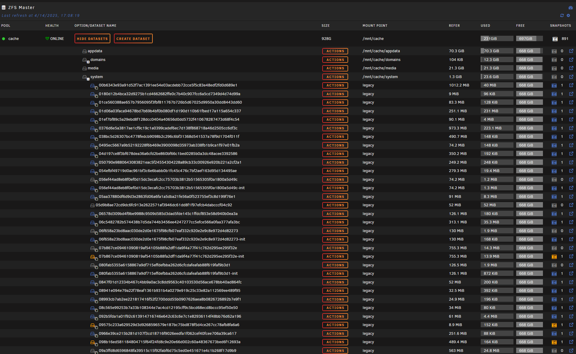

Back again. Now I stopped stopped docker service and vm mananger and after that the array does not stop. So I think it has nothing to do with the services. Correct me, if I'm wrong. When I start it an stop it like 2 h later it works great. Only if I want to stop it after about a week it hat no desire. I installed the zfs master plugin to see some snapshots. This one was huge! There are like 500-700 more lines. Does this look normal? The docker storage is set to native. This was recommended to me here in the forum. The server exists only for about four month and I have about 40 dockers. The command zfs list -r cache also shows all of these entries from above. I clean my server about every two weeks and shut it down for this purpose. It's never worked before for the server to shut down without errors after a few minutes. It always freezes at the exact same point. I've already tried the usual suspects, like fuser -mv /mnt/cache lsof /mnt/cache If I boot in safe mode, I can start and stop the array normally. I haven't tried it for a period longer than a week yet. What is the best way to proceed, considering that the error only occurs after a certain amount of time? Is there anything I can do to prevent this, like stopping before the array, to see if it will work? I'm currently trying a script that prepares everything, but it's not working. I keep getting the same error. #!/bin/bash echo "Starting array shutdown script..." ### 1. Unmount all SMB (CIFS) shares mounted on this server echo "Unmounting all SMB (CIFS) shares mounted on this server..." mount | grep -i cifs | awk '{print $3}' | while read -r share; do if [ -n "$share" ]; then echo "Unmounting $share" umount "$share" # Check if unmount was successful if mountpoint -q "$share"; then echo "Failed to unmount $share. Forcing unmount..." umount -l "$share" fi fi done ### 2. Stop all Docker containers echo "Stopping all Docker containers..." docker ps -q | xargs -r docker stop ### 3. Terminate SSH sessions accessing the array echo "Terminating SSH sessions accessing the array..." # Get the PID of the current script to avoid killing itself current_pid=$$ pids=$(lsof -t /mnt/disk* /mnt/user* 2>/dev/null | grep sshd | uniq | grep -v "^${current_pid}$") if [ -n "$pids" ]; then echo "Terminating SSH sessions with PIDs: $pids" echo "$pids" | xargs -r kill else echo "No SSH sessions accessing the array found." fi ### 4. Close any open files on the array echo "Closing any open files on the array..." pids=$(lsof -t /mnt/disk* /mnt/user* 2>/dev/null | uniq | grep -v "^${current_pid}$") if [ -n "$pids" ]; then echo "Terminating processes with PIDs: $pids" echo "$pids" | xargs -r kill else echo "No processes accessing the array found." fi ### 5. Stop VMs echo "Stopping all VMs..." virsh list --name | while read -r vm; do if [ -n "$vm" ]; then echo "Shutting down VM: $vm" virsh shutdown "$vm" # Initialize countdown max_wait=150 # Maximum wait time in seconds interval=10 # Interval between checks elapsed=0 while [ $elapsed -lt $max_wait ]; do sleep $interval elapsed=$((elapsed + interval)) echo "Checking if VM '$vm' has shut down... (Elapsed: ${elapsed}s)" if ! virsh list --name --state-running | grep -qw "^${vm}$"; then echo "VM '$vm' has shut down gracefully." break fi done # After timeout: force shutdown if virsh list --name --state-running | grep -qw "^${vm}$"; then echo "VM '$vm' did not shut down in time. Forcing shutdown..." virsh destroy "$vm" sleep 5 if ! virsh list --name --state-running | grep -qw "^${vm}$"; then echo "VM '$vm' has been forcefully terminated." else echo "Failed to forcefully terminate VM '$vm'. Manual intervention may be required." fi fi fi done ### 6. Stop SMB services echo "Stopping SMB services..." /etc/rc.d/rc.samba stop ### 7. Stop NFS services echo "Stopping NFS services..." /etc/rc.d/rc.nfsd stop ### 8. Stop additional services (optional) echo "Stopping additional services..." # Example: /etc/rc.d/rc.plexmediaserver stop Is this a known problem with any plugin?

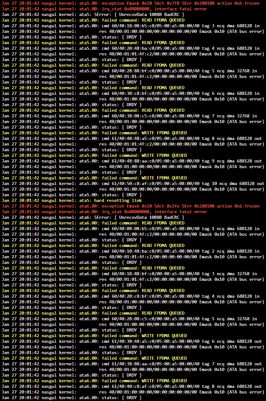

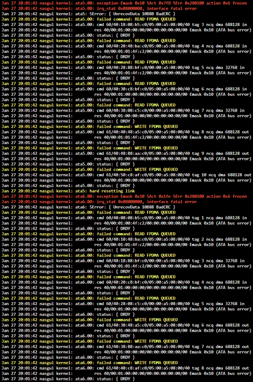

Tatsächlich nicht, aber: ich glaube auch, dass die Platten in Ordnung sind. Die eine Platte ist über ein SATA-Kabel, die andere über einen HBA mit einem SAS zu SATA-Kabel verbunden, deswegen würde ich die Kabel in dem Fall fast ausschließen (komplett andere Verbindungstechnik). Vor allem, da die Fehler im gleichen Moment kamen und beide Platten zu dem Zeitpunkt beschrieben wurden.

Hi, nachdem ich vor drei Tagen zwei HDDs zu meinem Array hinzugefügt hatte (beide an einem LSI 9207-8i angeschlossen), ist heute/vorhin auf einmal gleichzeitig bei zwei Platten der UDMA CRC Error Count auf "1" gewechselt. Ich habe gelesen, dass die mit hoher Wahrscheinlichkeit am Kabel oder am Controller liegt, jedoch ist eine Platte per Sata-Kabel direkt mit dem Mainboard (Intel Z790 Chip) verbunden, die andere über ein SFF-8087 Kabel mit dem LSI 9207-8i Controller. Beide Platten waren zu dem Zeitpunkt des Errors am beschreiben, also diese sind nicht gerade erst hochgedreht worden. Hängt dies mit einem höheren Problem, sprich z.B. Betriebssystem zusammen? Beide Platten, die den Error bekommen haben, waren Bestandsplatten, also nicht eine der beiden neuen. Wie kann ich das Problem elegant "ignorieren", ohne dass ich bei einer Status-Meldung über einen Messenger-Dienst nun jedes Mal eine Warnung bekomme und nicht alle paar Tage manuell den Counter überprüfen muss, falls ich den Error 199 einfach deaktiviere. Wenn ich im Dashboard die Meldung den Daumen nach unten bestätige, werden dann neue Fehler trotzdem angezeigt? Danke schonmal unraid-diagnostics-20250127-2040.zip
