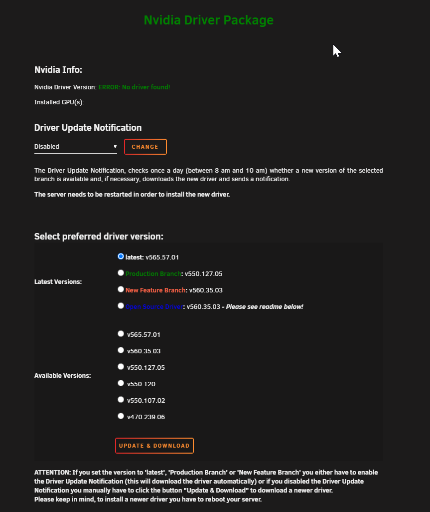

  2. Got it to work finally after selecting an order driver. Driver installed, all good. Now I’m fighting with Plex to get it to transcode properly. Thanks again for your help.

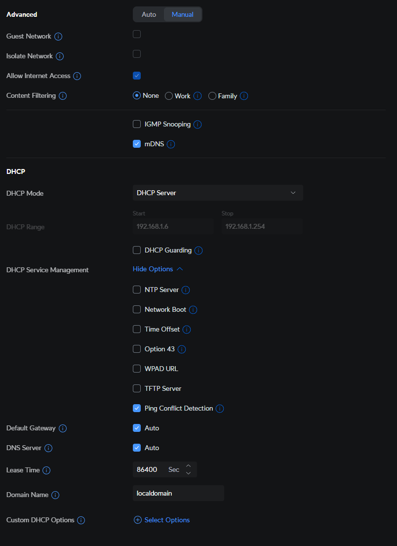

  3. Went through to confirm. Here are my settings:
  4. This makes me think its a read/write thing:
  5. Had Pi-Hole running through Unifi, turned off Pi-Hole and reverted DNS on the router level.

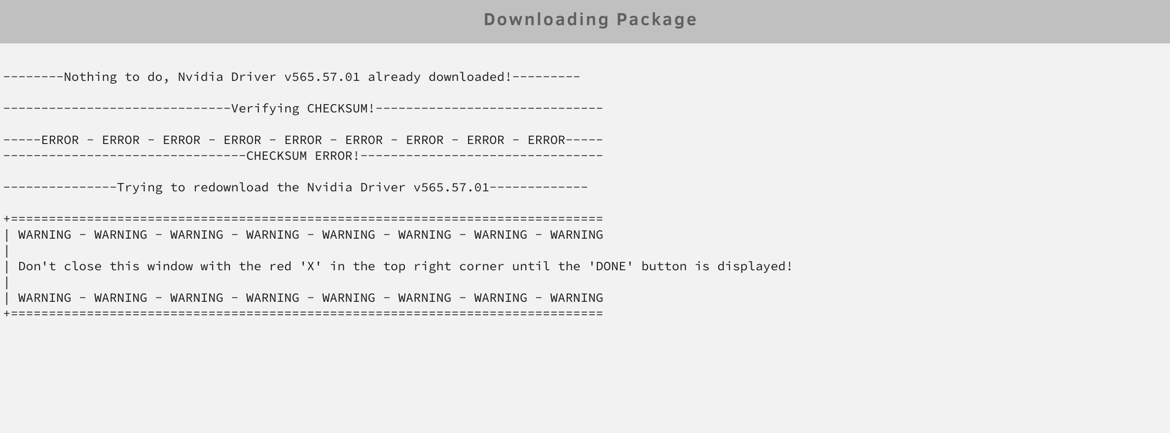

  7. Im in the US. Thanks I'll see what I can do with these.

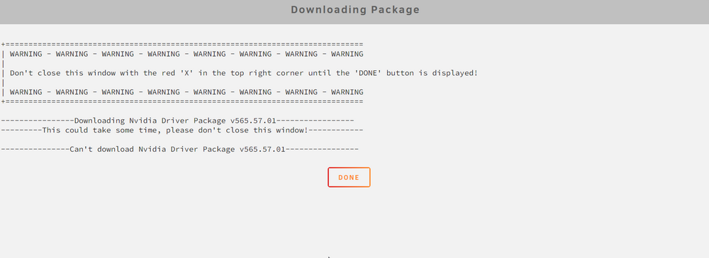

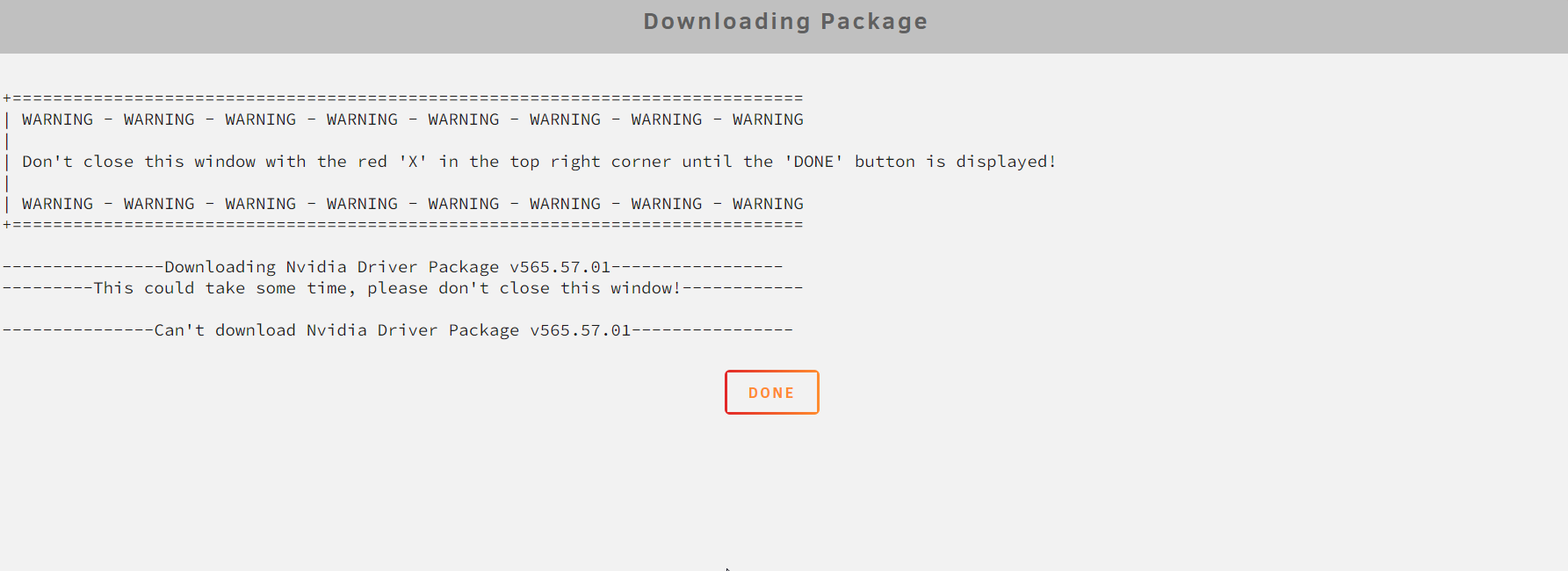

  8. It will show the downloading driver package screen like the screenshot above shows. However, it has been an hour and it is still not completed. I'm trying to run through the list of things that might be wrong like USB boot failing, SSD failing, network issue etc. EDIT: Just got a error that I can't download the driver:

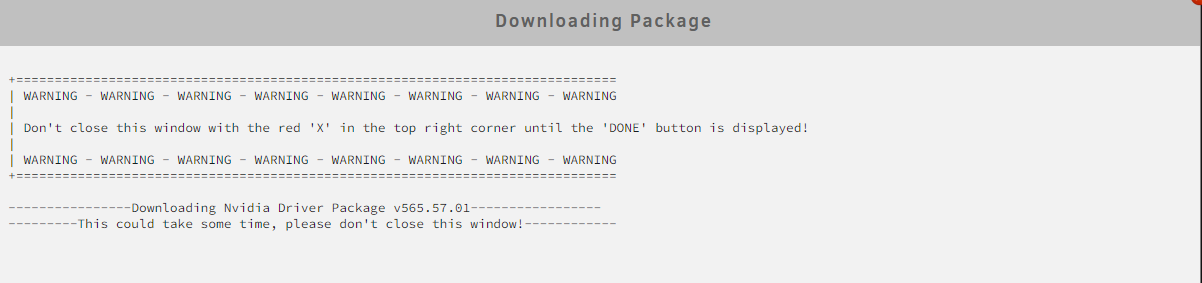

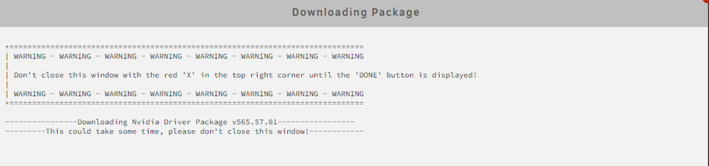

  9. EDIT: Updated to 6.12.13, Nvidia_Driver plugin installed successfully. Now when I install the driver itself, it hags on the Downloading Package screen. GPU Stats sees the GTX 1060 but the Nvidia Driver plugin won't install the driver.
