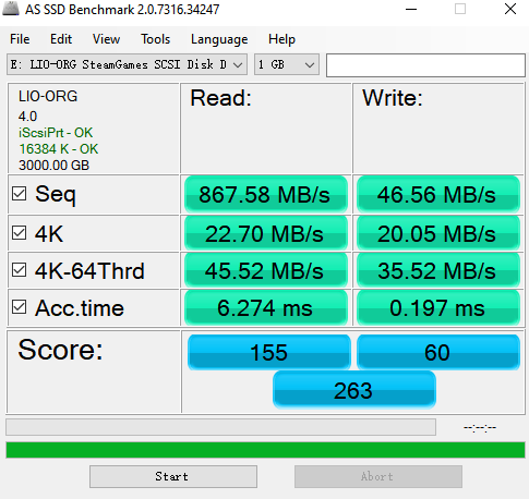

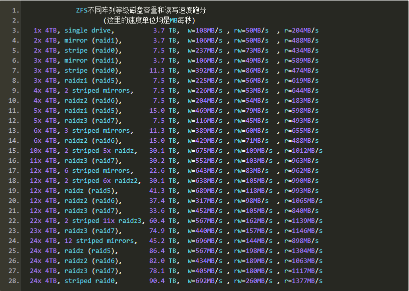

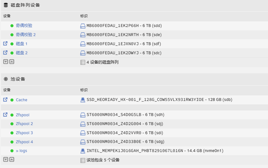

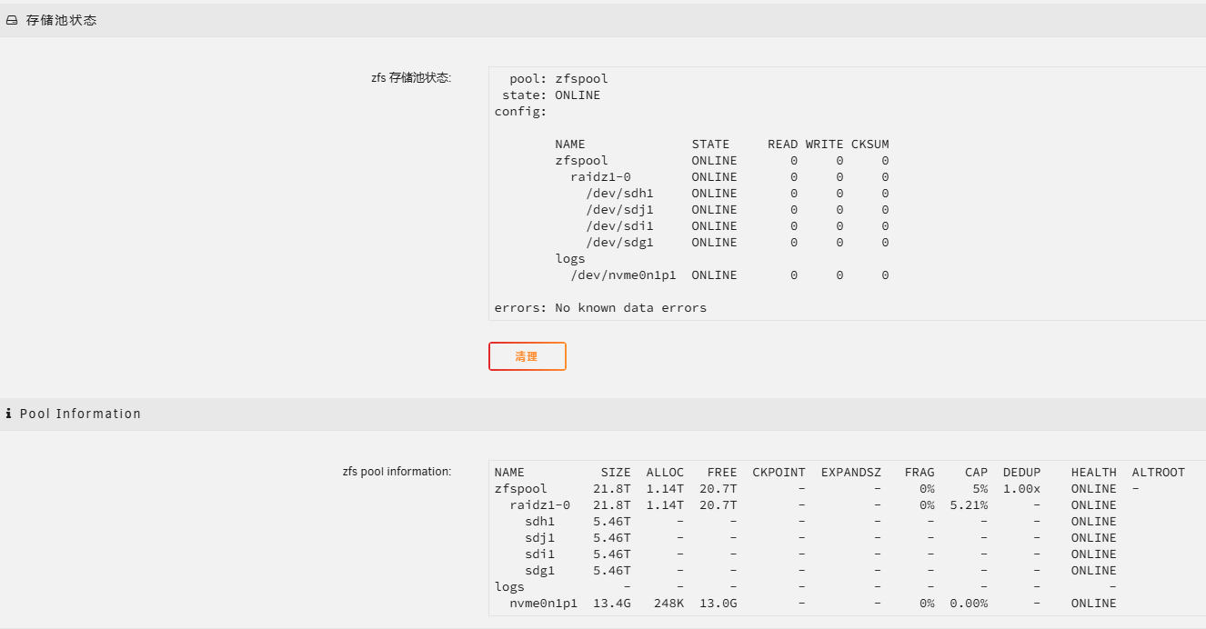

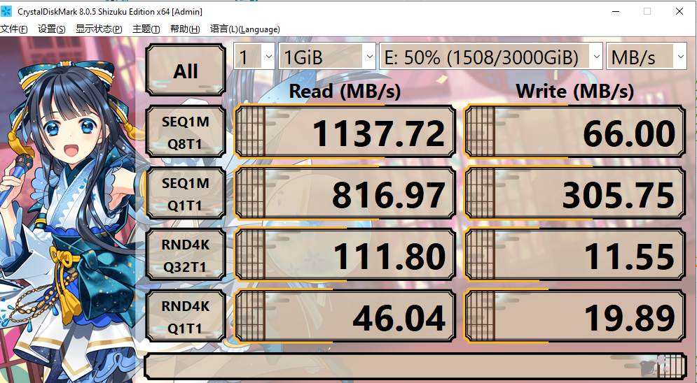

  3. Unraid server configuration: CPU: e3-1245 v5 Motherboard: MSI C236A WORKSTATION Memory: DDR4 2133 32G NIC: Intel 82599ES 10-Gigabit SFI/SFP+ Hard Disk: disk ATA SSD HEORIADY HX- 0A0 /dev/sdb 128GB disk HP MB6000FEDAU HPD1 /dev/sdc 6.00TB disk HP MB6000FEDAU HPD1 /dev/sdd 6.00TB disk HP MB6000FEDAU HPD1 /dev/sde 6.00TB disk HP MB6000FEDAU HPD1 /dev/sdf 6.00TB disk SEAGATE ST6000NM0034 MS2D /dev/sdg 6.00TB disk SEAGATE ST6000NM0034 MS2D /dev/sdh 6.00TB disk SEAGATE ST6000NM0034 MS2D /dev/sdi 6.00TB disk SEAGATE ST6000NM0034 MS2E /dev/sdj 6.00TB disk INTEL MEMPEK1J016GAH__1 /dev/nvme0n1 14.4GB where the specific arrays are shown in the figure: The eight 6T mechanical disks are all connected via an LSI SAS2308 array, connected to the PCI-e3.0 x4 slot on the motherboard, which theoretically won't be any slower than a 10Gbps network speed, and won't cause a bottleneck in the hard drive transfers This is the speed of various arrays tested by others I found online: Below is the speed I tested by connecting to zfspool, via an ISCSI virtual disk: Where Q1T1 performance is normal ??????????????? It's really amazing, excuse my limited knowledge, I don't know how to explain and deal with such a situation

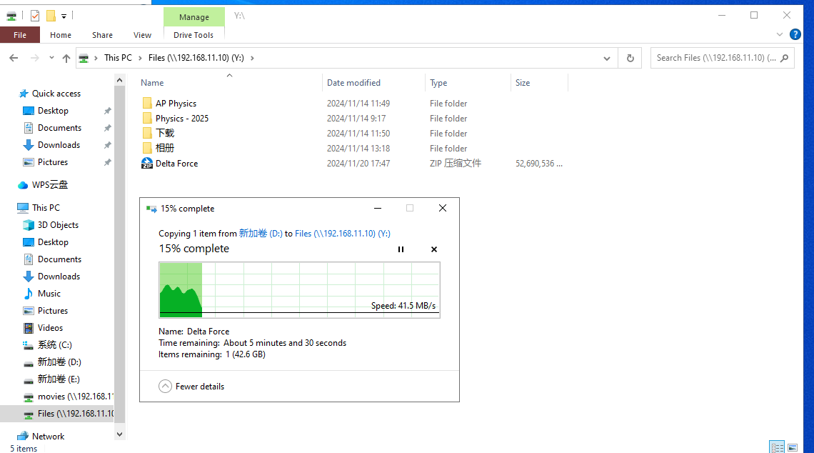

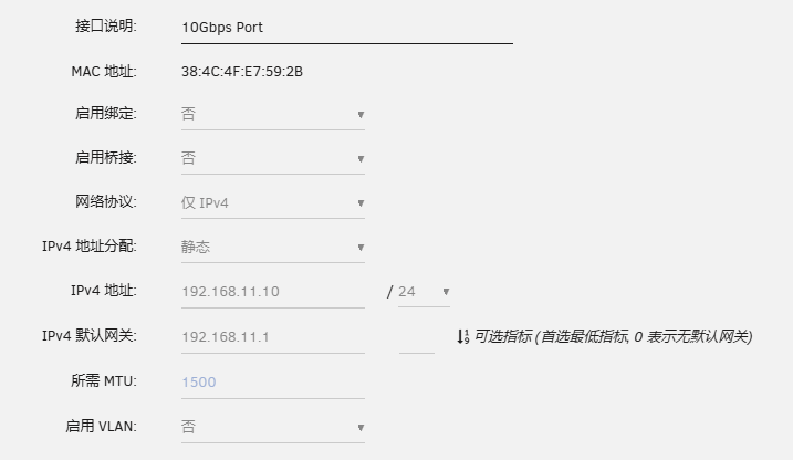

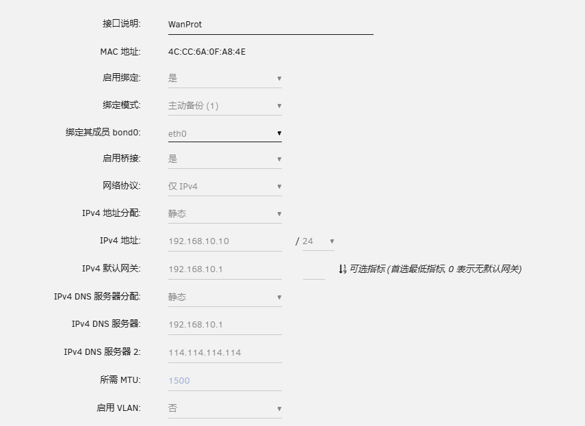

  4. 内容更新!!! 问题反馈,使用diskMark进行测试发现更为怪异的现象,真的很神奇,希望懂的大佬帮忙解释一下为什么 其中SEQ1M测试 Q1T1性能还是正常的 ??????????????? 真的很神奇,恕我知识有限,不知道如何解释这样的现象

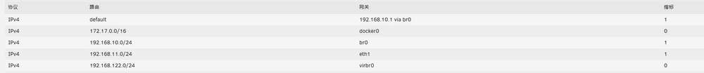

  5. 我是通过这样的方法解决的: 1G网卡绑定一个IP地址 10G网卡绑定另外一个不同网段的IP地址 实际两个网卡的配置如下: 1G网口: 这个网卡用作整个服务器的wan口,启用桥接,并绑定br0,服务器的管理,上网都通过这个网口 10G网口: 需要注意的是10G网口地址的IP网段应该和上面网卡不同,启用绑定,默认网关可以设置0, 我之前设置相同网段下的IP地址,导致无法10G网卡连接,数据总是走1G的网口。 特别注意!!!! 修改网络后,可能会出现default路由对应的网关是10G网络,这个时候你的所有Docker,服务商店均无法访问网络。 我在这里被搞崩溃过好几次,最后总结出来的比较好的办法就是eth0的mac地址设置为你的1G网卡
  6. Unraid服务器配置: CPU:e3-1245 v5 主板:MSI C236A WORKSTATION 内存:DDR4 2133 32G 网卡:Intel 82599ES 10-Gigabit SFI/SFP+ 硬盘: disk ATA SSD HEORIADY HX- 0A0 /dev/sdb 128GB disk HP MB6000FEDAU HPD1 /dev/sdc 6.00TB disk HP MB6000FEDAU HPD1 /dev/sdd 6.00TB disk HP MB6000FEDAU HPD1 /dev/sde 6.00TB disk HP MB6000FEDAU HPD1 /dev/sdf 6.00TB disk SEAGATE ST6000NM0034 MS2D /dev/sdg 6.00TB disk SEAGATE ST6000NM0034 MS2D /dev/sdh 6.00TB disk SEAGATE ST6000NM0034 MS2D /dev/sdi 6.00TB disk SEAGATE ST6000NM0034 MS2E /dev/sdj 6.00TB disk INTEL MEMPEK1J016GAH__1 /dev/nvme0n1 14.4GB 其中具体阵列如图: 其中通过4块希捷6t机械盘,并添加了一块16T的傲腾固态作为LOGS缓存,搭建了ZFS存储池。 8块6T机械盘都是通过LSI SAS2308阵列进行连接,接在主板的PCI-e3.0 x4槽位上,理论上速度不会比10Gbps的网速更慢,不会造成硬盘传输的瓶颈 这个是我在网上搜到的其他人测试的各类阵列速度: 其中4盘ZFS raidz模式比我的实测的速度要块很多, 下图是我通过ISCSI虚拟盘,连接zfspool进行测试的速度: 很奇怪的是read性能正常的情况下,write性能异常的弱鸡。 求助各位大佬解答,出现这类问题可能的原因。
