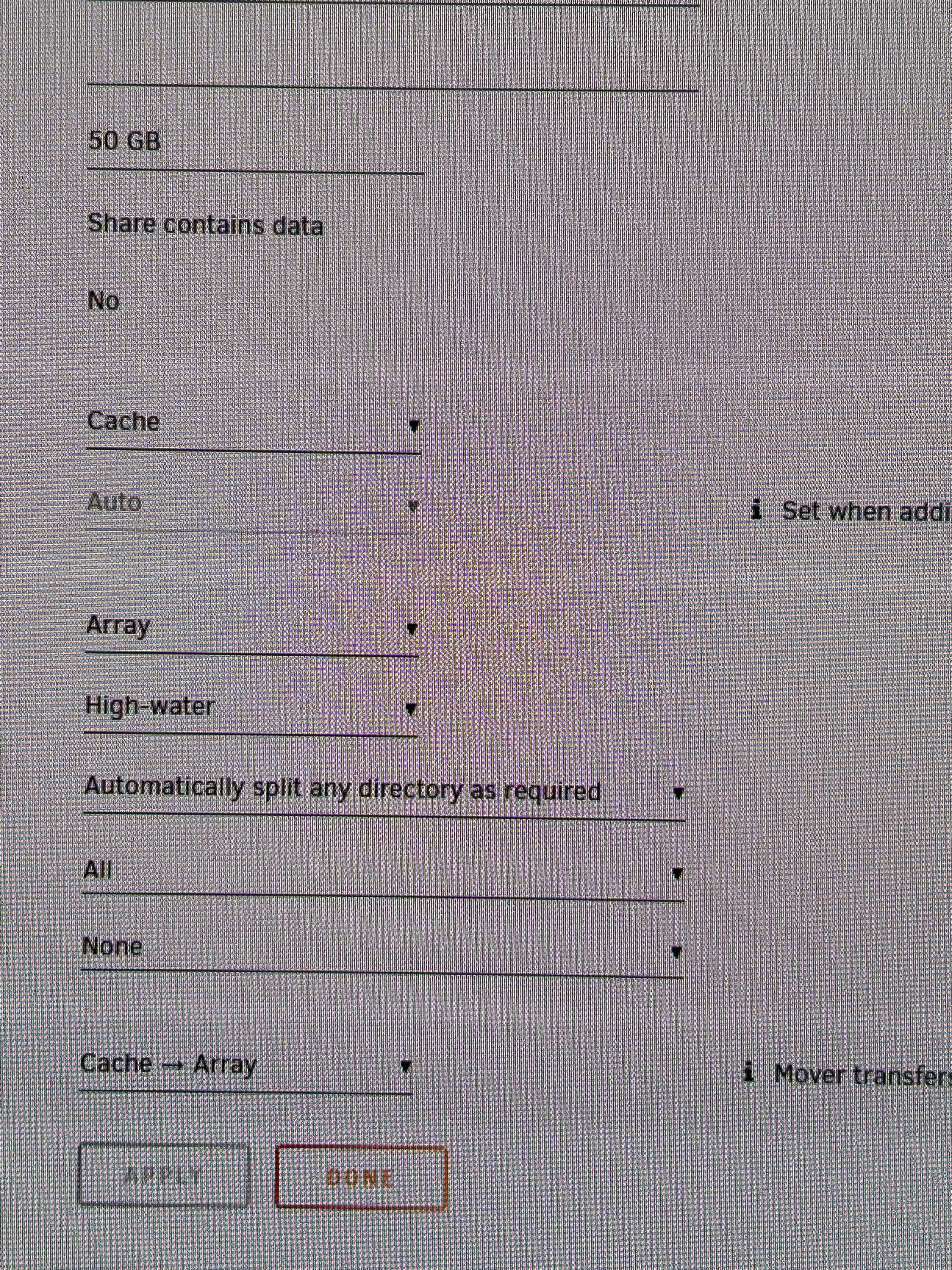

  9. so I went in and set the shares to 50gb for some reason they were at 0 like you said. Not sure how but I reset them to 50 across the board and left the cache at 100gb and still the files write to one of the drives on the array instead of using the cache.

  11. Over Smb via windows network share drive. And when I run home I’ll double check but I thought I set a minimum of 90gb on that share. Is that different than a floor ?
  12. So the shares are 90gb some are 97.8gb because unraid set that way by default. I set the minimum cache to 100gb. If I try to drag a file over to movie folder or any of my other shares, it just goes directly to one of the array drives. I was assuming maybe that diagnostics it would show. I have a hard time reading that.
  13. I am sorry if I am coming off as ignorant but I am not sure what you mean. Do you mean the shares minimum needs to be smaller than the cache? So I would set the shares to 50gb and the cache to 100gb and problem solved?
