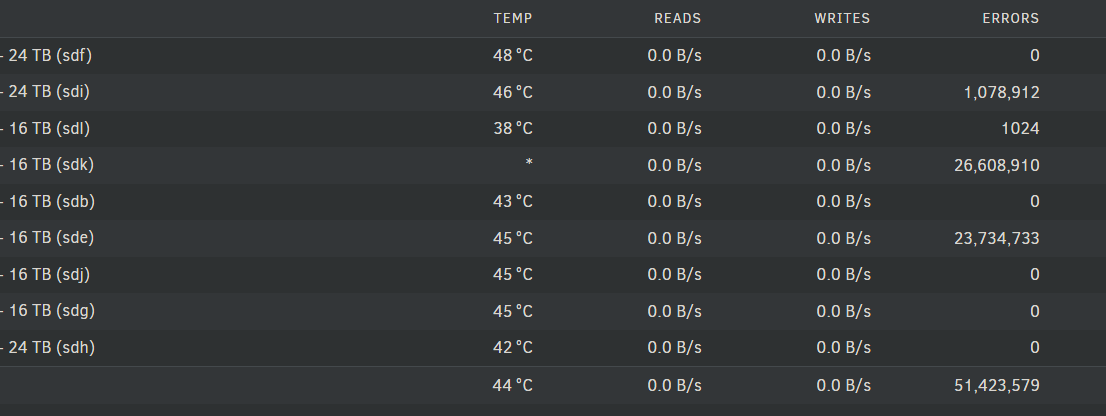

Hi folks, so before touching anything further, I wanted to seek some advice. Recently I had some issues with my previous motherboard/psu that made unraid go a little bonkers with the read errors. During my troubleshooting, I attempted to remove a drive that became unmountable, start the array in maintenance mode, turn it off, start it again and rebuild on that same drive but since I started getting more and more errors on more drives, I decided to turn off everything. As it stands now, I replaced all the parts/cables that could be culprits and I stopped getting read errors on all my drives, I want to attempt a rebuild on that drive but it shows as unmountable, should I assign it at the same spot and start a rebuild or do a format and then rebuild?? I would like to know the steps about it, I checked the docs but it seems that my scenario is a bit unusual so I would like to make sure before proceeding. I started the data rebuild initially but from what I've seen in the docs/forums, a data rebuild on an unmountable drive results in an unmountable drive regardless? What should I do then format the drive and the assign it to the same spot in the array? Any help would be appreciated. If I have to lose data on said drive I can take that hit but would rather avoid it if possible. Thanks again for any advice and merry Christmas. As it stands here is the status of my array (stopped, and the unassigned device is the one I wish to put back):

Hi folks, So this weekend my little server has been driving me nuts here is what happened from start to finish: -I was moving some data from my nvme scratch disk to the array and Unraid became unresponsive, even over ssh or directly through the terminal. -The motherboard after that refused to boot and got stuck in b2 or a0 mode until I removed that NVME. -After that it's been nothing but problems, it started saying that one drive is unusable. -I tried removing it from the array re-assign it and rebuild but after wards other read errors started popping for other drives so I decided to cancel the rebuild for now. -I also tried moving most of the drives from the motherboard SATA ports to the LSI card thinking there might be some issue with the motherboard, a little better but I still get errors during a rebuild or read check. -I also tried changing a few SATA cables to no avail. -Since so many different drives are throwing errors, I decided to pause the current rebuild attempt I was doing since the same drive becomes unusable during the rebuild. I am not sure that buying a new drive will solve this issue, if I had to take a guess I would say it is motherboard related?? I do not have access to another mobo for testing. I really want to fix this but I would appreciate some help to pin point the issue. I don't want to throw money at the problem without knowing if it will fix it if possible. Here are most of the errors I got in order: NVME failure: ``` nvme nvme0: Try "nvme_core.default_ps_max_latency_us=0 pcie_aspm=off pcie_port_pm=off" ``` Then I started getting this kinds of errors when most drives where plugged through the motherboard: ``` Nov 30 19:01:05 Taichi kernel: ata6.00: exception Emask 0x10 SAct 0x7fe000 SErr 0x4890000 action 0xe frozen Nov 30 19:01:05 Taichi kernel: ata6.00: irq_stat 0x04400040, connection status changed Nov 30 19:01:05 Taichi kernel: ata6: SError: { PHYRdyChg 10B8B LinkSeq DevExch } Nov 30 19:01:05 Taichi kernel: ata6.00: failed command: READ FPDMA QUEUED Nov 30 19:01:05 Taichi kernel: ata6.00: cmd 60/00:68:00:e7:00/04:00:08:00:00/40 tag 13 ncq dma 524288 in Nov 30 19:01:05 Taichi kernel: res 40/00:01:00:4f:c2/00:00:00:00:00/00 Emask 0x10 (ATA bus error) Nov 30 19:01:05 Taichi kernel: ata6.00: status: { DRDY } ``` When I moved things to the LSI cards I stopped getting these but I caught read errors while trying to rebuild or just complete a read check. Thanks in advance for any help.
