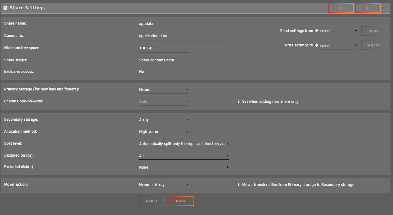

  7. Perfect! I really appreciate the advice, as you can tell I'm still learning the ins and outs. I expected changing the primary to run a mover action and get all the data over to the primary, rather than storing it and reading it from where it was originally written. This is where I think some of the confusion came from. It is now definitely moving the data, just slower than I was expecting. I think this is my solution, I will update the thread if it isn't with diagnostics as well as update you if this does fix my problem. I am optimistic this is what I was looking for though. Thanks!

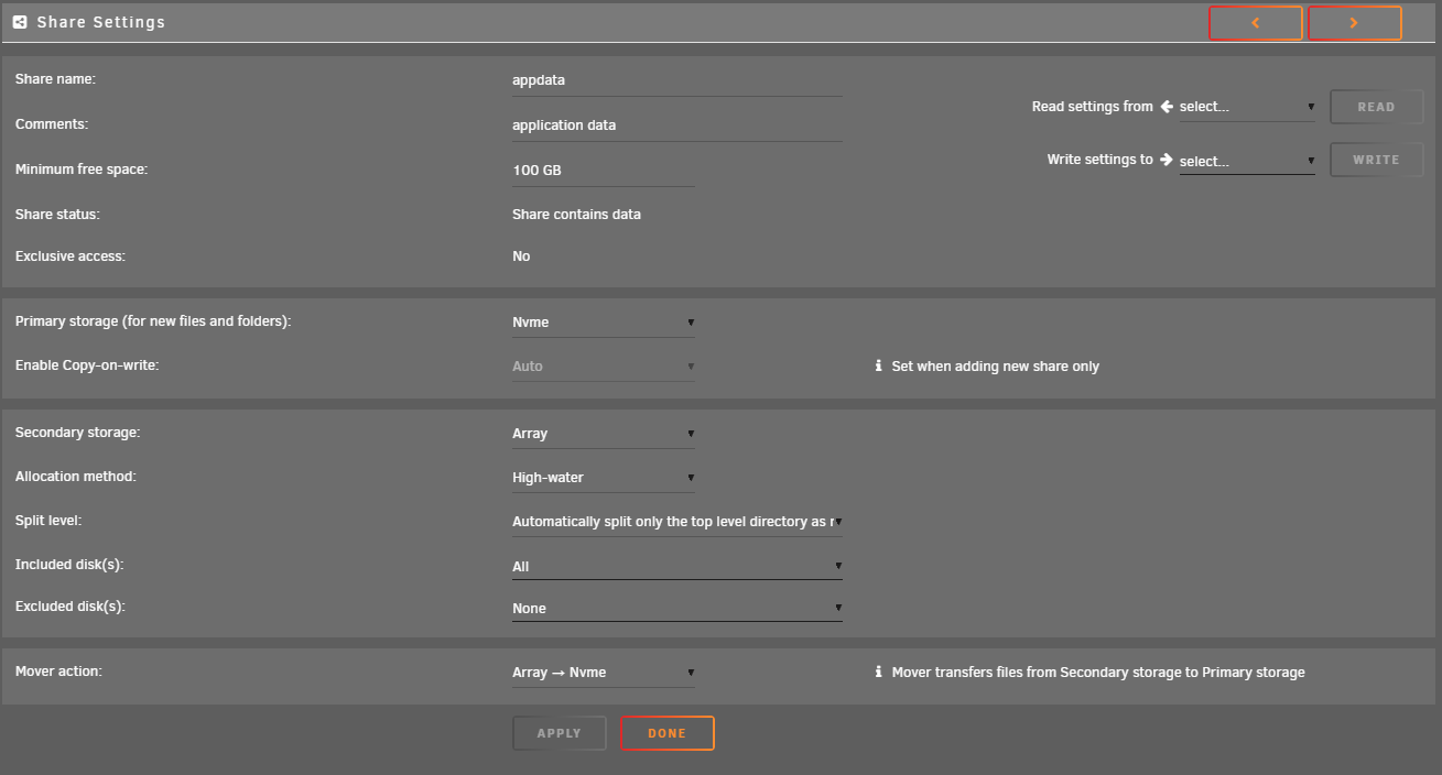

  8. Okay, so if I want to move the data from where it is currently stored (array and cache) and onto nvme, I would need to set the primary to nvme, set the secondary to Array (or wherever the data is stored) then set the mover action to Array -> Nvme, run the mover and my data should move over like the screenshot below? That would make sense to me but I'm doing that now but my nvme pool is still showing 32mb used.
  9. I also noticed my mover action may be wrong, its set NVME -> Array. Will I need to change that to Array -> NVME run the mover and Cache -> NVME run the mover and then change it back to NVME -> Array to have it do an array secondary backup?

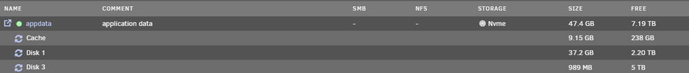

  10. I just did a compute all and noticed appdata still hasn't migrated off of Disk 1 and its also now on Disk 3 as well. How does one get appdata to move over? I changed storage from Array to Nvme and ran the mover command. Am I missing a step here?

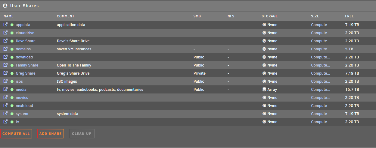

  11. Hi there! I just had a successful upgrade on the hardware, but my spin down problem still doesnt seem to be fixed. I was wondering if there was anyway to see what is using these drives? I moved all the shares that weren't my media share over to the Cache drive (which I now call nvme due to the upgrade) but the platter disks still dont spin down. I'm also wondering why free doesn't reflect that. These are 2 1tb nvme drives in a pool, so this stuff shouldn't have 7.19 Tb free. Maybe that has something to do with my problem?
  12. Thanks for that quick reply! 1: I have a SAS controller in a JBOD configuration on both the old and new setup. The current hardware is really old so I'm not running any VMs I can live without, I plan on spinning up new ones. You're probably right about the Docker containers. I have rebooted it a few times since I found the spindown feature and I would have expected everythign to move over since then, but I will review your links as I think you're onto something there. I noticed isos was still on the array, hopefully that's it. Again thanks for the links and advice!
