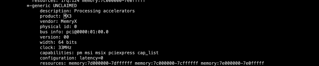

  6. so it seems its not working still. im asking the developer what i can test locally. i see the card now after re-installing your steps in /dev/memx0 but it wont work on the docker side
  7. @ich777 it didnt work here is a screenshot of lshw showing that it was unclaimed
