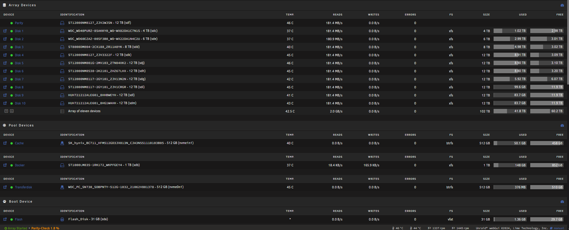

HI Trurl after letting the nas running for 1 day, again encounter the error "Docker Service failed to start" where all the docker is up but inaccesible attached the diagnostics file imrannas-diagnostics-20250518-1413.zip
