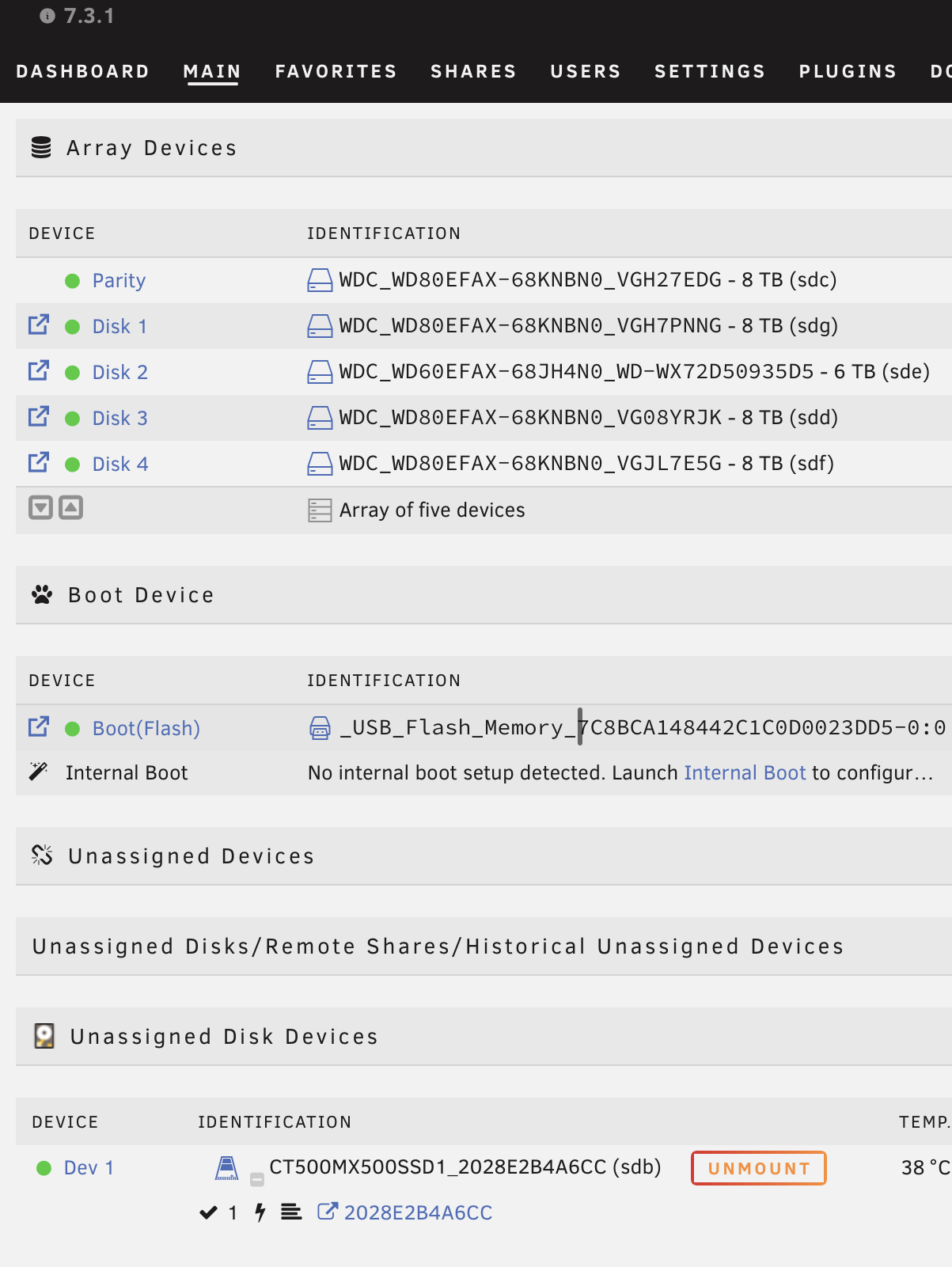

Woke up this morning to this: I already restored a older docker image to make sure it is not the image causing the issue.tower-diagnostics-20260530-0713 - after docker restart.zip tower-diagnostics-20260530-0701 - Before Docker restart.zip

After upgrading to version 7.3.0, the Docker service has been crashing intermittently. I have to manually restart the service each time, after which everything works normally until the issue occurs again the following day. There are no relevant errors in the system logs. However, when I check the Docker tab, it shows that the Docker service is not started. Please let me know what addional information Ican provide to help. I also upgraded to 7.3.1 same issue and never had this issue before on 7.2.6 or lower.
