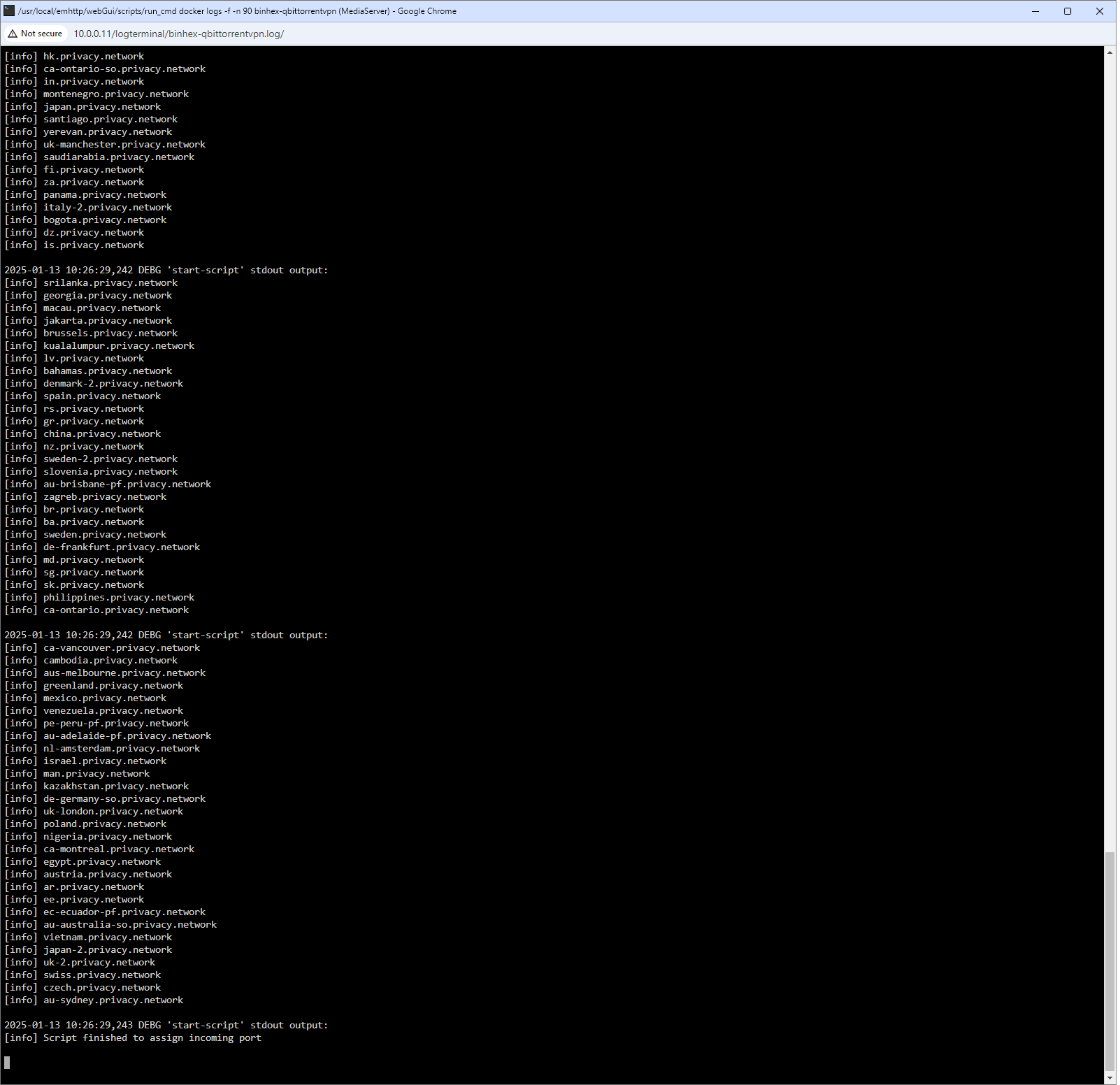

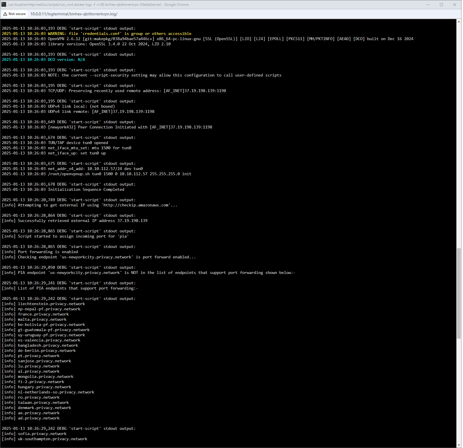

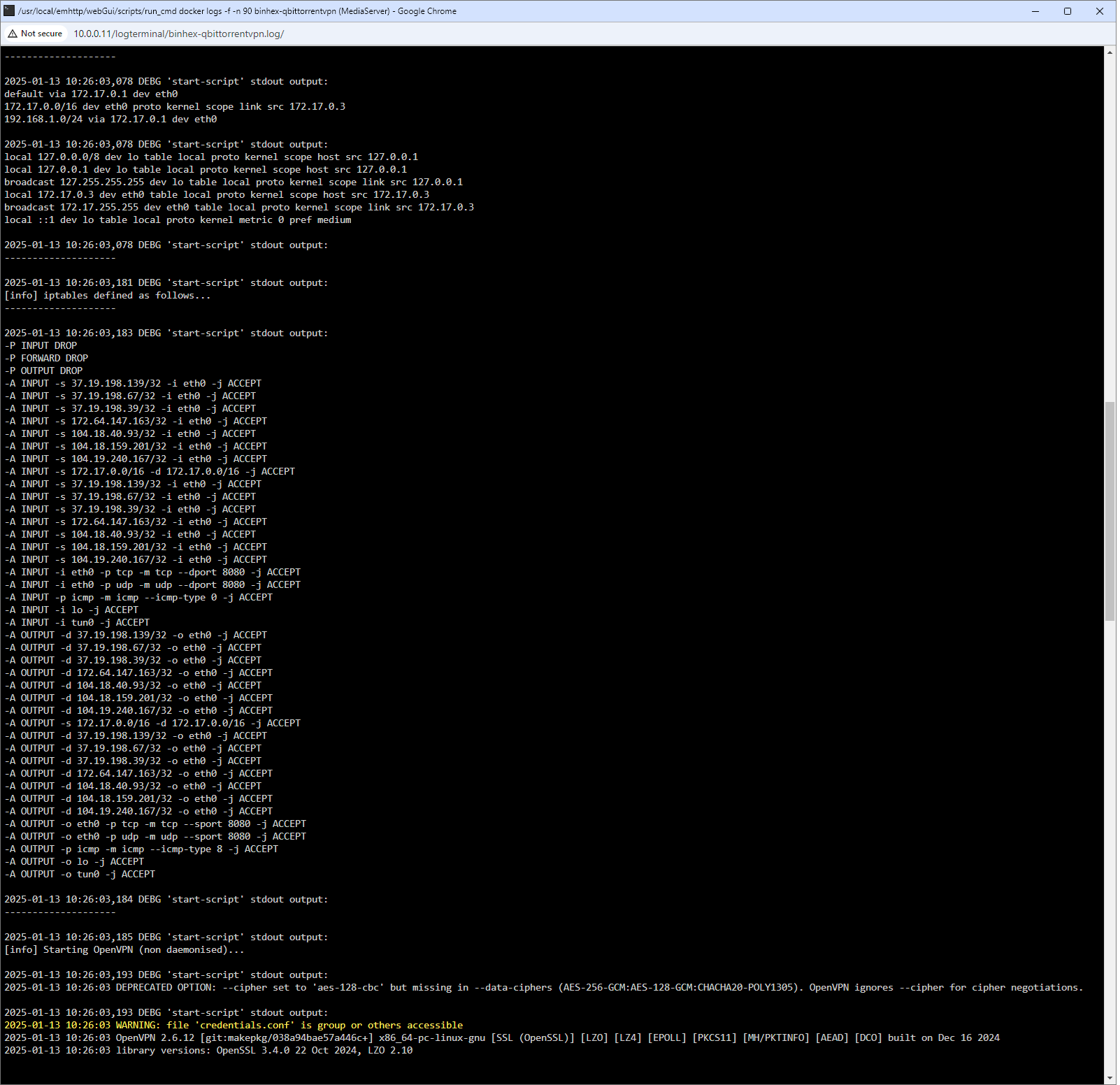

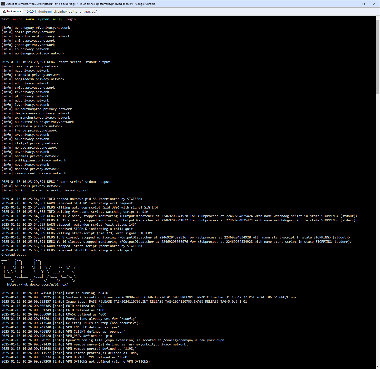

  4. Thanks so much! I changed to ca_ontario for my ovpn file and left strict port forwarding on and it worked! I love the work you do @binhex I am sure I will be back to the forums at some point during my setup journey of the arr suite, see you then

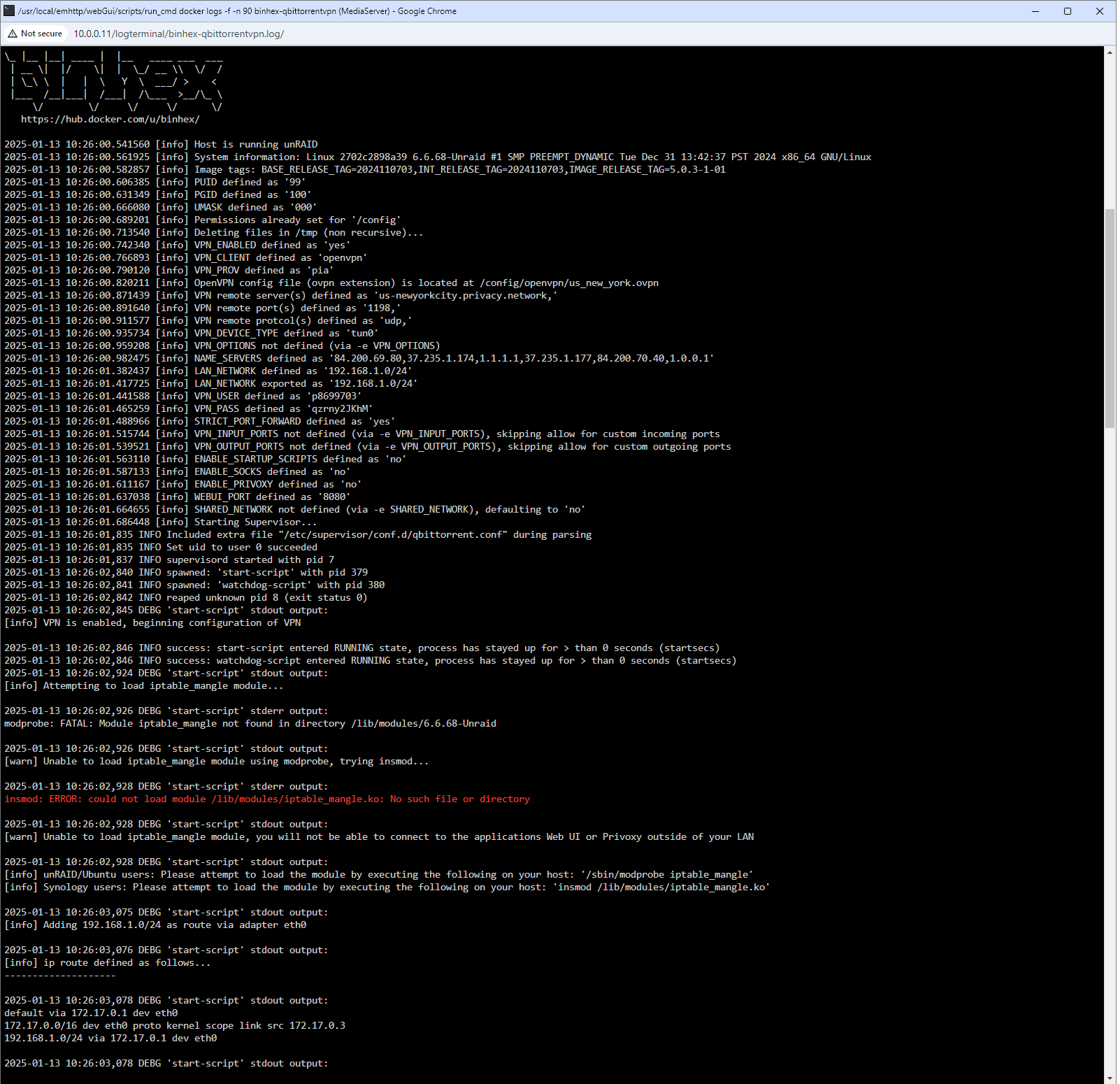

  5. I think this is what you asked for. I am not sure how to save the logs as a file so I screenshotted Also, everything still functions just fine if I change the "vpn enabled" setting to "no" so I know that it has something to do with my vpn setup

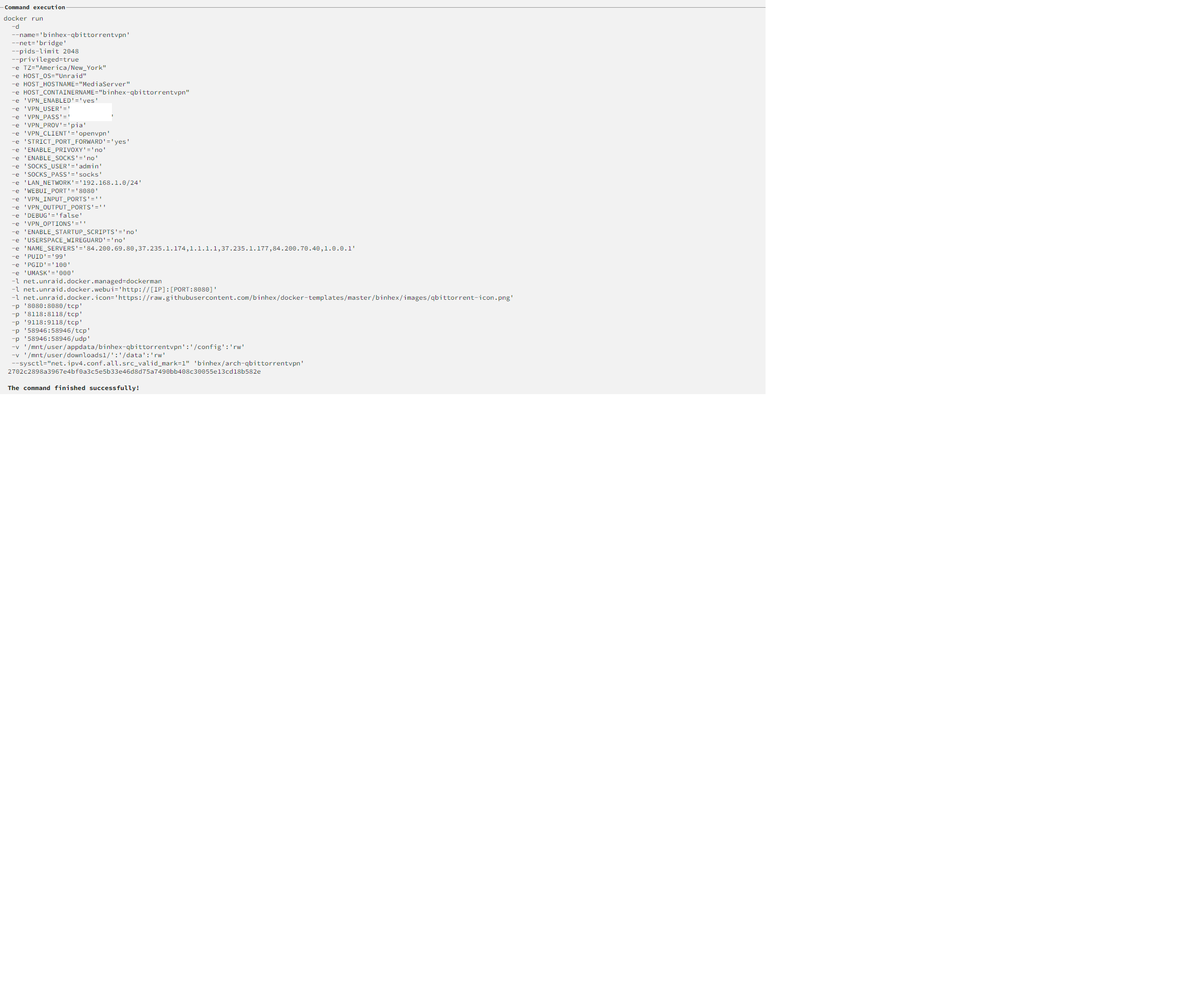

  7. I am setting up qbittorrentvpn for the first time and ran into two problems. The first was that the admin/adminadmin default was not working, which I was able to overcome by pasting WebUI\Password_PBKDF2="@ByteArray(ARQ77eY1NUZaQsuDHbIMCA==:0WMRkYTUWVT9wVvdDtHAjU9b3b7uB8NR1Gur2hmQCvCDpm39Q+PsJRJPaCU51dEiz+dTzh8qbPsL8WkFljQYFQ==)" at the end of the config file using console. The second challenge is that after I activated the vpn, the web ui wont open. I am getting an error and a warning while the container is opening insmod: ERROR: could not load module /lib/modules/iptable_mangle.ko: No such file or directory and WARNING: file 'credentials.conf' is group or others accessible Not sure how to overcome these. Some details to hopefully help: - I tried running the container without vpn active and it worked fine (after the default password problems). - I know that my vpn username and password are correct. - I am using PIA - I moved the .pem file, the certificate, and the new york .ovpn file into the openvpn file using console. They are located at path /mnt/user/appdata/binhex-qbittorrentvpn/openvpn/ and I checked to make sure that they were actually there Any troubleshooting steps would be really appreciated!
