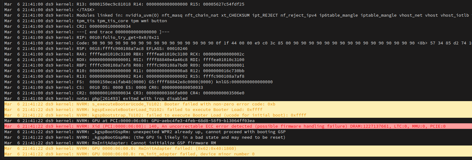

Unraid constantly crashing. NVRM: GPU 0000:06:00.0: rm_init_adapter failed, device minor number 0

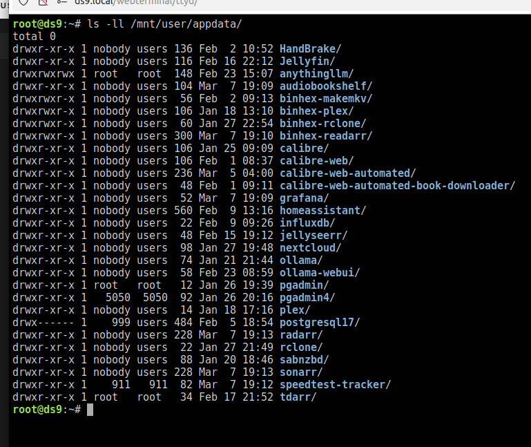

Thanks @itimpi now I see it in /appdata. Suggest modifying the help documentation to make it clearer that if logging to appdata, the IP of the unraid server needs to be put in the "Remote" IP address. Wasn't super clear (at least to me!)

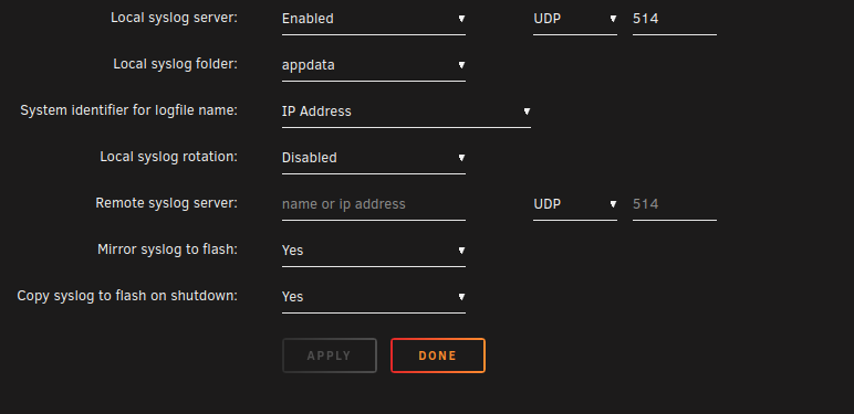

Thanks @JorgeB I had actually done that a while ago, but for some reason it never logged anything to my "LOcal syslog folder" which I selected my cache appdata share, see below. But when i look at /mnt/user/appdata I don't see anything other than the folders for my docker containers (see below). I now just enabled it to mirror to my flash, let's see if that does anything.

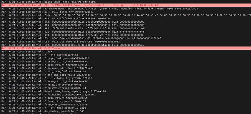

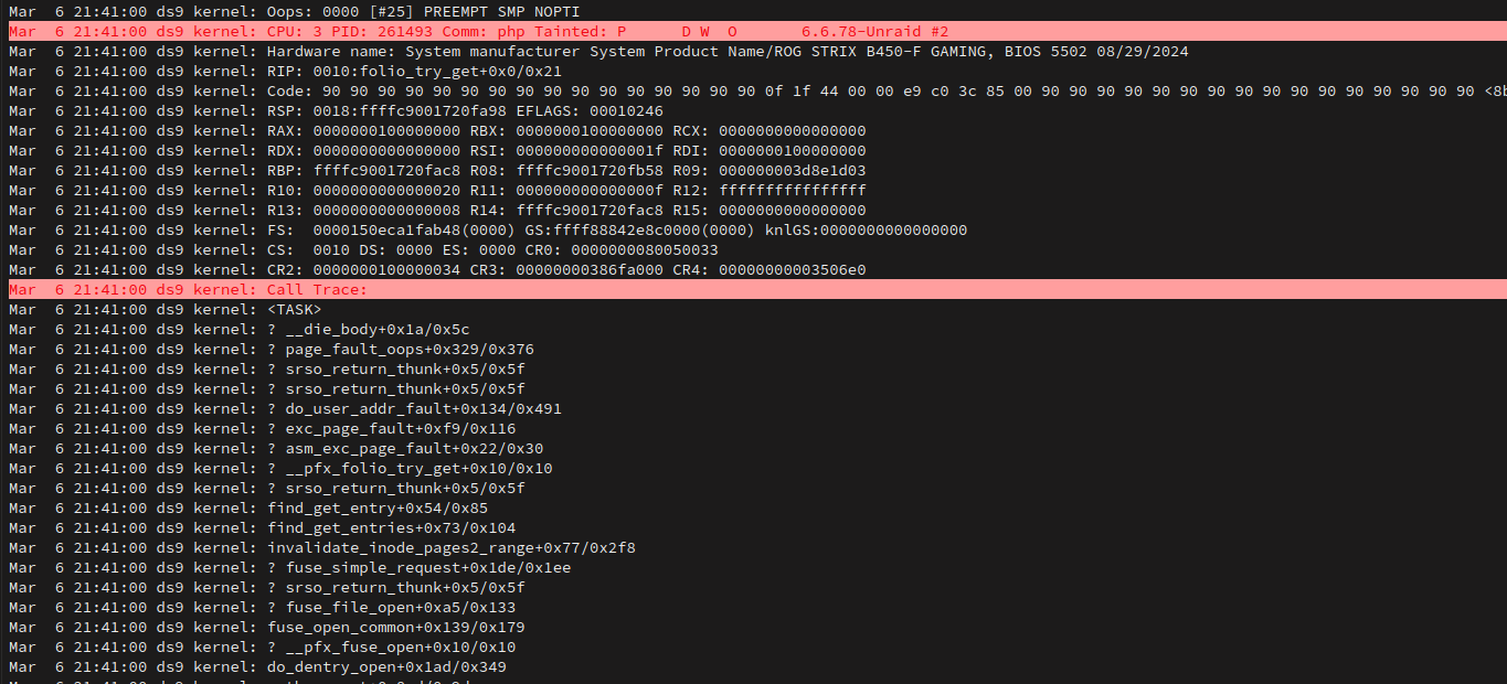

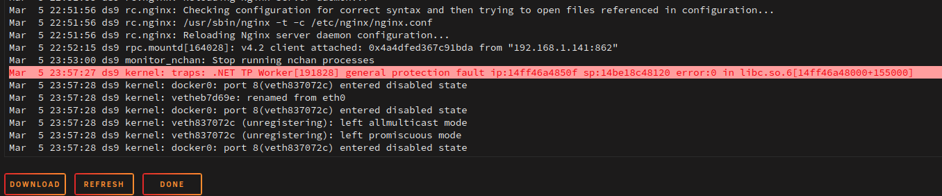

copying this here trying to pin down this behavior updated the nvidia driver to open source version and (so far) haven't seen above issue reboooted and no issues, UNTIL i started jellyfin from a client and immediately noticed the below and jellyfin docker stopped can a container cause this level of system instability? isn't that the whole point of containerization to avoid?

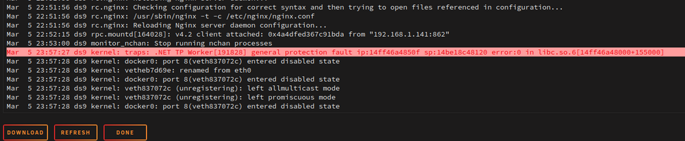

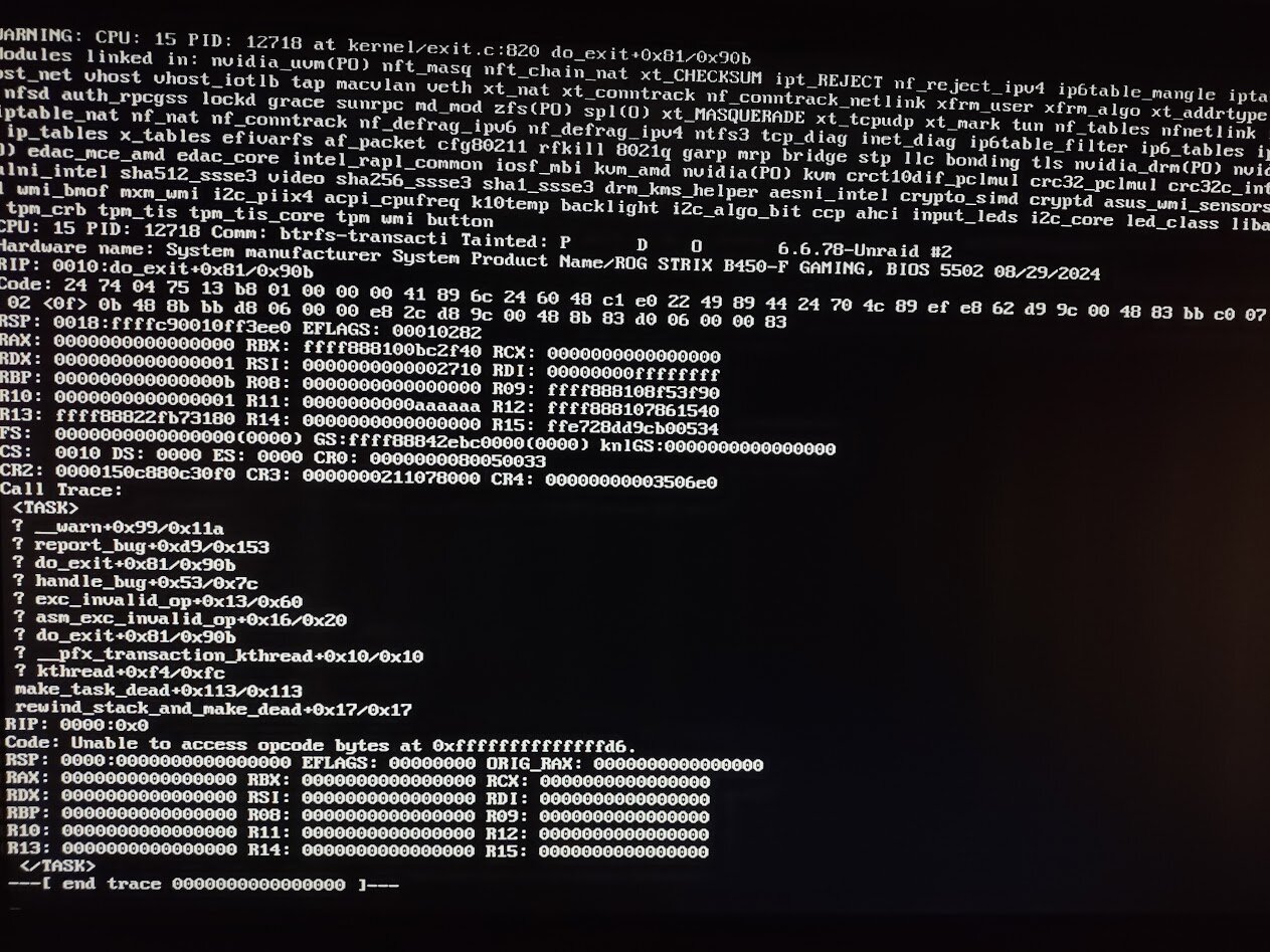

This is getting nowhere fast, all dockers were stopped and when I logged into the GUI it worked for 2 seconds but trying to get to syslog failed and entire GUI stopped working. Plugged in a monitor to the machine and this is what is shown: I've also enabled the syslog server and and it's supposed to be writing to "appdata" but I don't see any files there, but attached are the diagnostics from this morning. Again to recap: This machine was working perfectly fine for my 30 day trial period, then bought Lifetime The machine has also worked flawlessly with Windows and DrivePool for years Memtest is PASS ds9-diagnostics-20250305-0735.zip

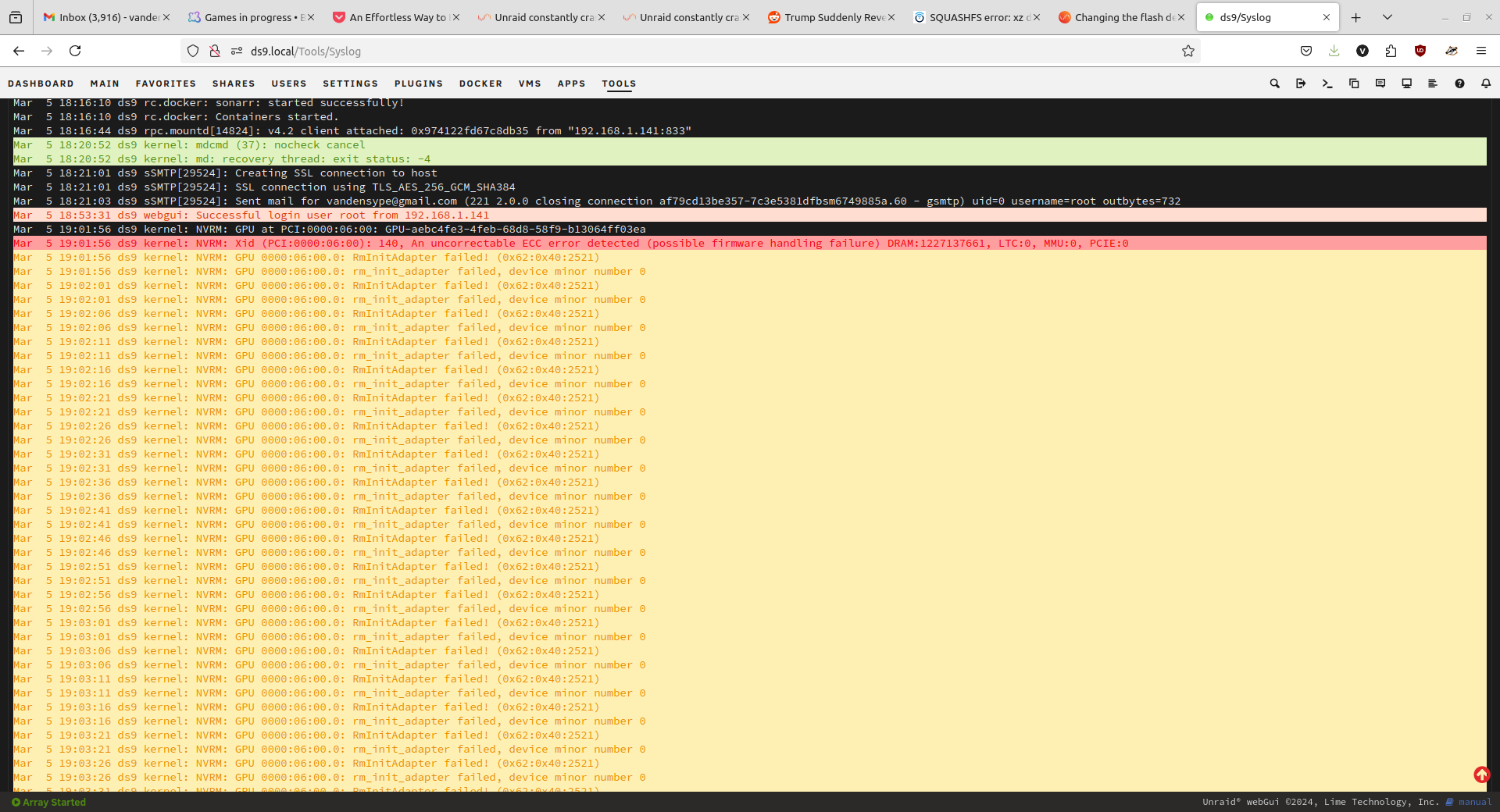

well, it was running fine for about a day, but then another set of errors happend, see attached. THese errors seem different than the last time, so not sure what is going on if every day it's a different set of problems. NOte that the last set of errors occurred just now as I logged in. Mar 5 04:40:02 ds9 move: mover: finished Mar 5 07:27:05 ds9 kernel: NVRM: GPU at PCI:0000:06:00: GPU-aebc4fe3-4feb-68d8-58f9-b13064ff03ea Mar 5 07:27:05 ds9 kernel: NVRM: Xid (PCI:0000:06:00): 140, An uncorrectable ECC error detected (possible firmware handling failure) DRAM:1227137661, LTC:0, MMU:0, PCIE:0 Mar 5 07:27:05 ds9 kernel: NVRM: GPU 0000:06:00.0: RmInitAdapter failed! (0x62:0x40:2521) Mar 5 07:27:05 ds9 kernel: NVRM: GPU 0000:06:00.0: rm_init_adapter failed, device minor number 0 Mar 5 07:27:09 ds9 kernel: NVRM: GPU 0000:06:00.0: RmInitAdapter failed! (0x62:0x40:2521) ds9-syslog-20250305-1227.zip
