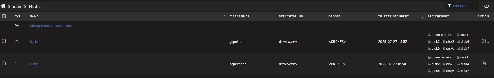

  11. Sorry, Unfortunately, I am not able to understand everything you wrote. Can you please check my scrennshots ?In in my opinion the amateur should have been deleted yesterday.
  12. Ok, the cache cleaner is not working at all. Every file is " still in range" disks="" pool="download-ssd" subfolders="Filme Serien" filetypes=".mkv" wait_todo="120" move_excl="yes" move_excl_list="/mnt/user/system/mover/mover_excl.txt" move_tune_list="/mnt/user/system/mover/mover_ignore.txt" rsync_mode="folder" rsync_move="" rsync_copy="rsync --stats -azht --mkpath" switch_mode="switch" time_keephours="24" time_keephours_sub="720" subfolder_keep_sub="" target_keephours="user0" use_recycle="no" recycle_folder=".Recycle.Bin" unraid_note="Yes" unraid_syslog="yes" script_cron="*/5 * * * *" clean_cron="0 */12 * * *" mediaserver_type="emby" mediaserver_url="http" mediaserver_host="192.168.178.2" mediaserver_port="8096" mediaserver_key=" mediaserver_only="only" script_cron_state="started" clean_cron_state="started" exclusions="" rewrite_source="/media/Media:/mnt/user/Media"

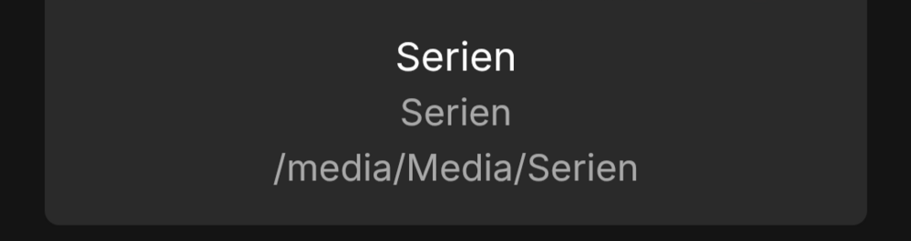

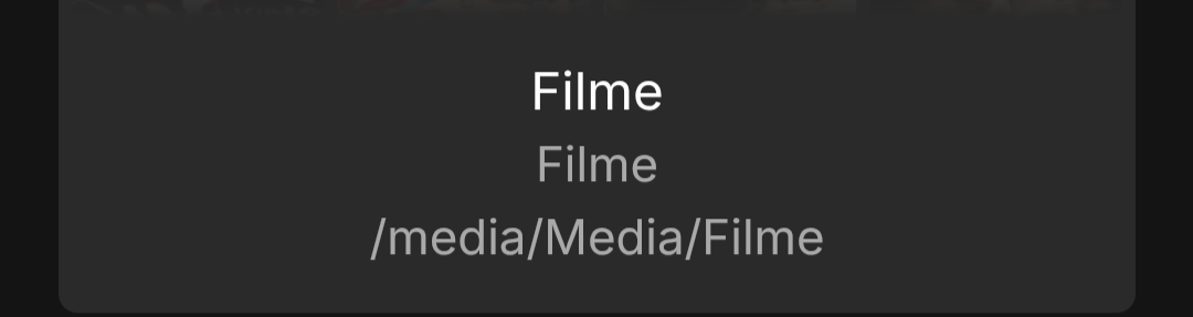

  15. root@Server:~# wget -q -O - "http://192.168.178.2:8096/emby/Sessions?api_key=2e5701c3fc314112b67b4f10c6483e7b" | \jq '.[] | {NowPlayingItem: .NowPlayingItem.Path} | select(.NowPlayingItem!=null)' | \sed 's|{||g;s|}||g;s|"NowPlayingItem":||g;s|"||g;s|^[ \t]*||;/^[[:space:]]*$/d' | shuf -n 1 /media/Media/Filme/The.Surfer.2024.German.EAC3.DL.1080p.BluRay.x265-VECTOR/The Surfer (2024).mkv
  16. Did you mean the attachment ?
  17. root@Server:~# wget -q -O - "http://192.168.178.2:8096/emby/Sessions?api_key=" | \jq '.[] | {NowPlayingItem: .NowPlayingItem.Path} | select(.NowPlayingItem!=null)' | \sed 's|{||g;s|}||g;s|"NowPlayingItem":||g;s|"||g;s|^[ \t]*||;/^[[:space:]]*$/d' | shuf -n 1 \\\\192.168.178.2\\Media\\Filme\\The.Surfer.2024.German.EAC3.DL.1080p.BluRay.x265-VECTOR\\The Surfer (2024).mkv

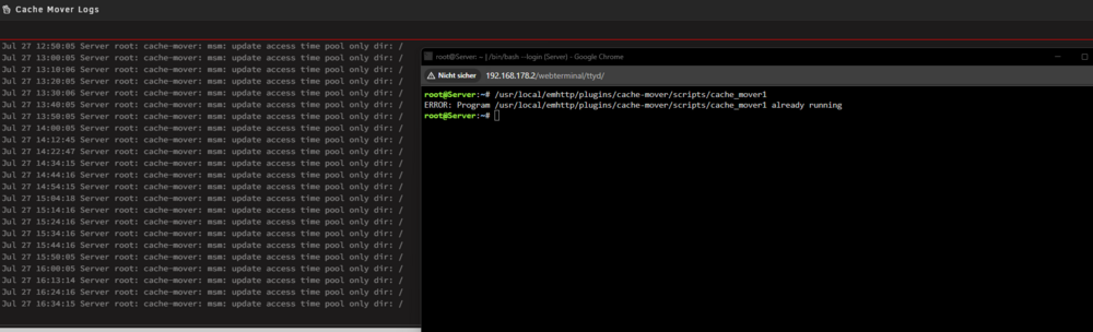

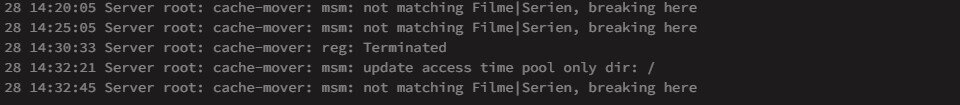

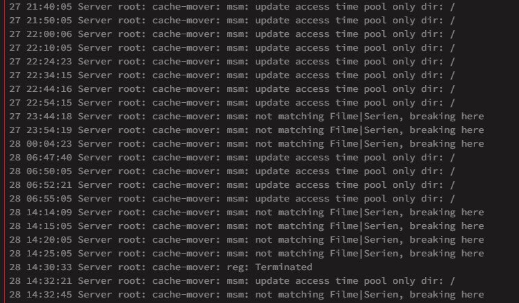

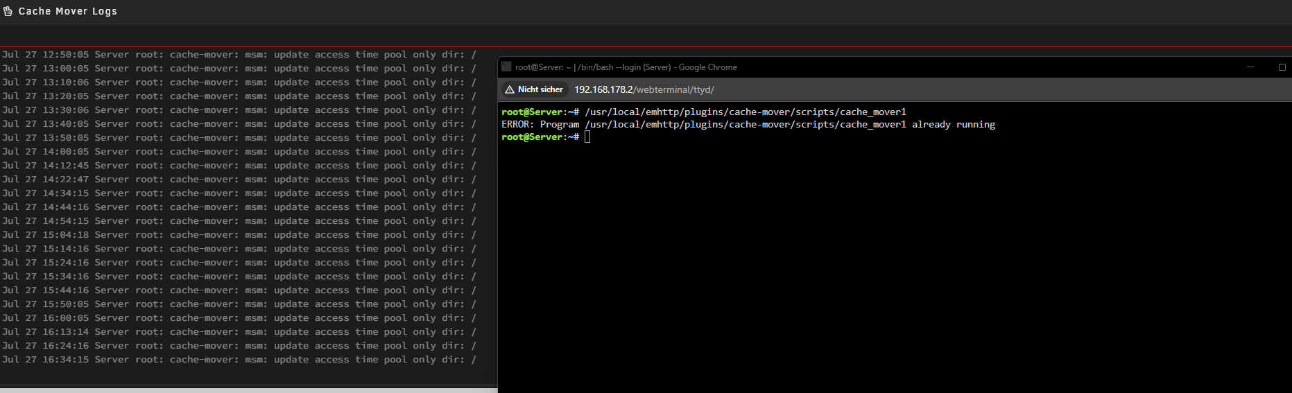

  19. The first resonse to /usr/local/emhttp/plugins/cache-mover/scripts/cache_mover1 was " already Running " in the log. After killall cache_mover1 i tried /usr/local/emhttp/plugins/cache-mover/scripts/cache_mover1 again. The attached picture is the respone to /usr/local/emhttp/plugins/cache-mover/scripts/cache_mover1 You can ignore the not matching Filme/Serien, breaking here log entry. Somebody was using a library not using the Cache Mover Plugin. I

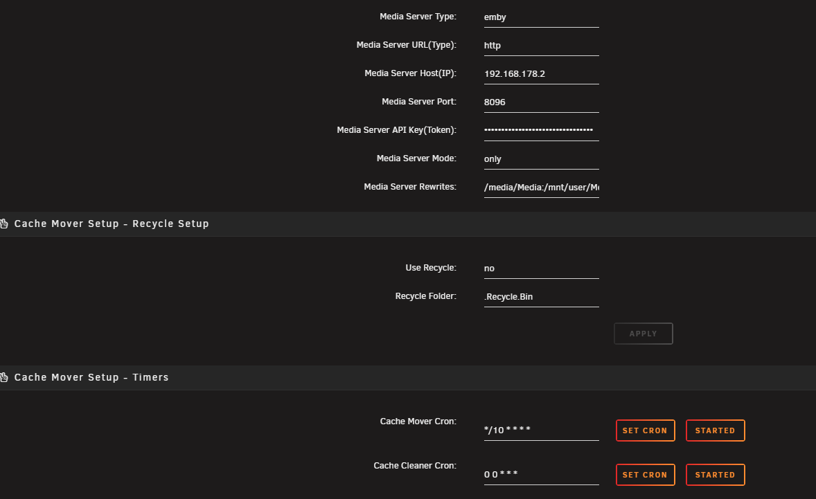

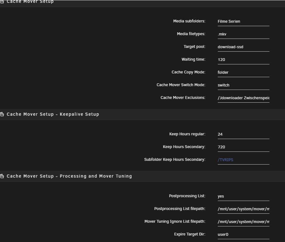

  20. disks="" pool="download-ssd" subfolders="Filme Serien" filetypes=".mkv" wait_todo="120" move_excl="yes" move_excl_list="/mnt/user/system/mover/mover_excl.txt" move_tune_list="/mnt/user/system/mover/mover_ignore.txt" rsync_mode="folder" rsync_move="" rsync_copy="rsync --stats -azht --mkpath" switch_mode="switch" time_keephours="24" time_keephours_sub="720" subfolder_keep_sub="" target_keephours="user0" use_recycle="no" recycle_folder=".Recycle.Bin" unraid_note="Yes" unraid_syslog="yes" script_cron="*/5 * * * *" clean_cron="0 0 * * * " mediaserver_type="emby" mediaserver_url="http" mediaserver_host="192.168.178.2" mediaserver_port="8096" mediaserver_key="emby token" mediaserver_only="only" script_cron_state="started" clean_cron_state="started" exclusions="" rewrite_source="/media/Media:/mnt/user/Media"

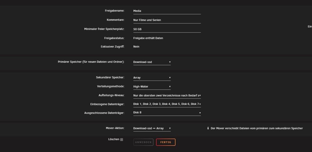

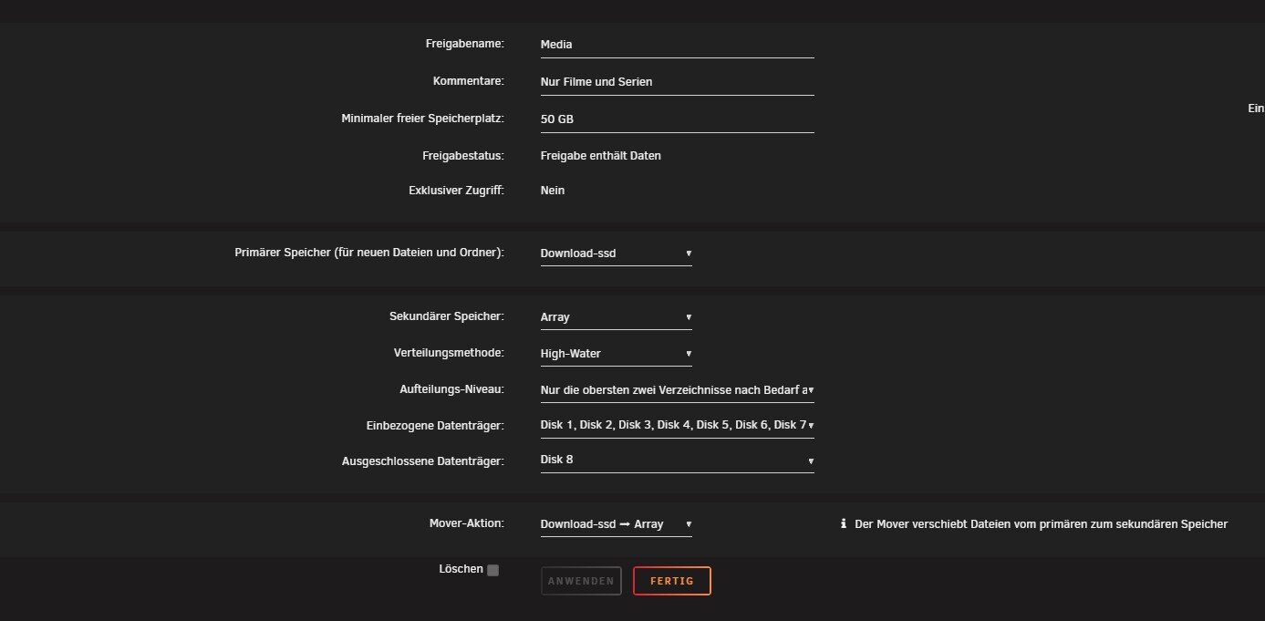

  22. as requested, or did you mean something else ? I am not using the "nobody" uid 99. My folders have the UID 1000, can the different owner influence the plugin ?
