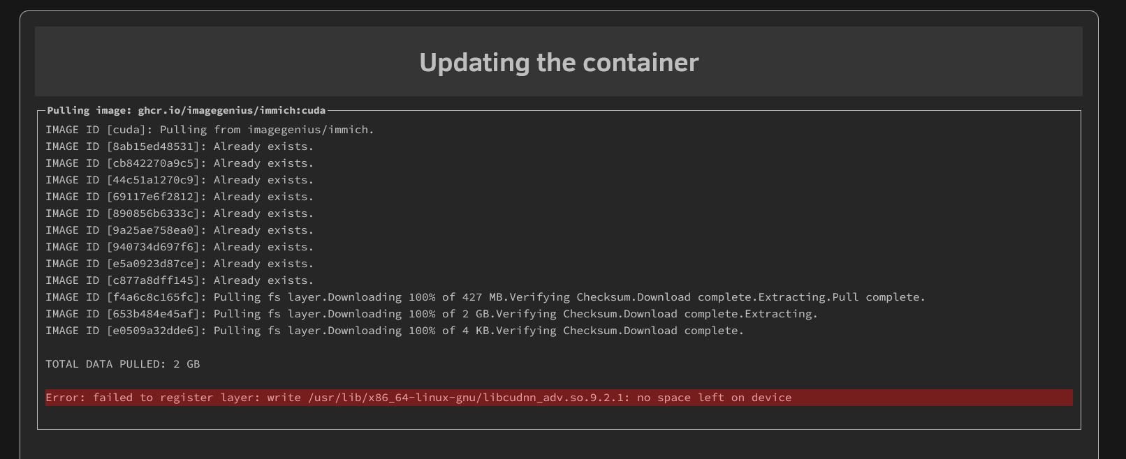

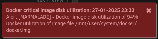

  7. @trurlI think that's whats happening here. I'm lost, however, as to how I change where its writing to. Anyway, here are the diagnostics: marmalade-diagnostics-20250129-1155.zip Total unRAID noob, so lmk if that's not helpful. Tysm
  8. Hello! I was getting a warning as I was in the later stages of building out my unraid server abt the docker disk image utilization. Realized today that I was unable to update Immich because it was full. I have plenty of space, I'm just having trouble figuring out how to allocate more space. Furthermore, there isn't options in the docker template for changing where to place the files. Thanks!
