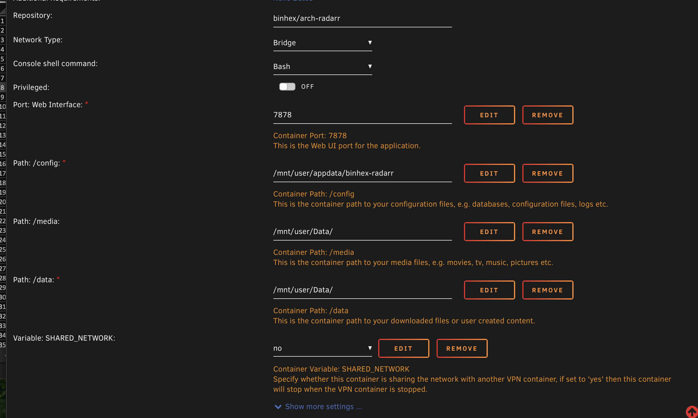

  4. Yes, that path does exist. I hadnt changed anything, so they may have been wrong. I went ahead and changed the group setting, and got this. docker run2.yaml
