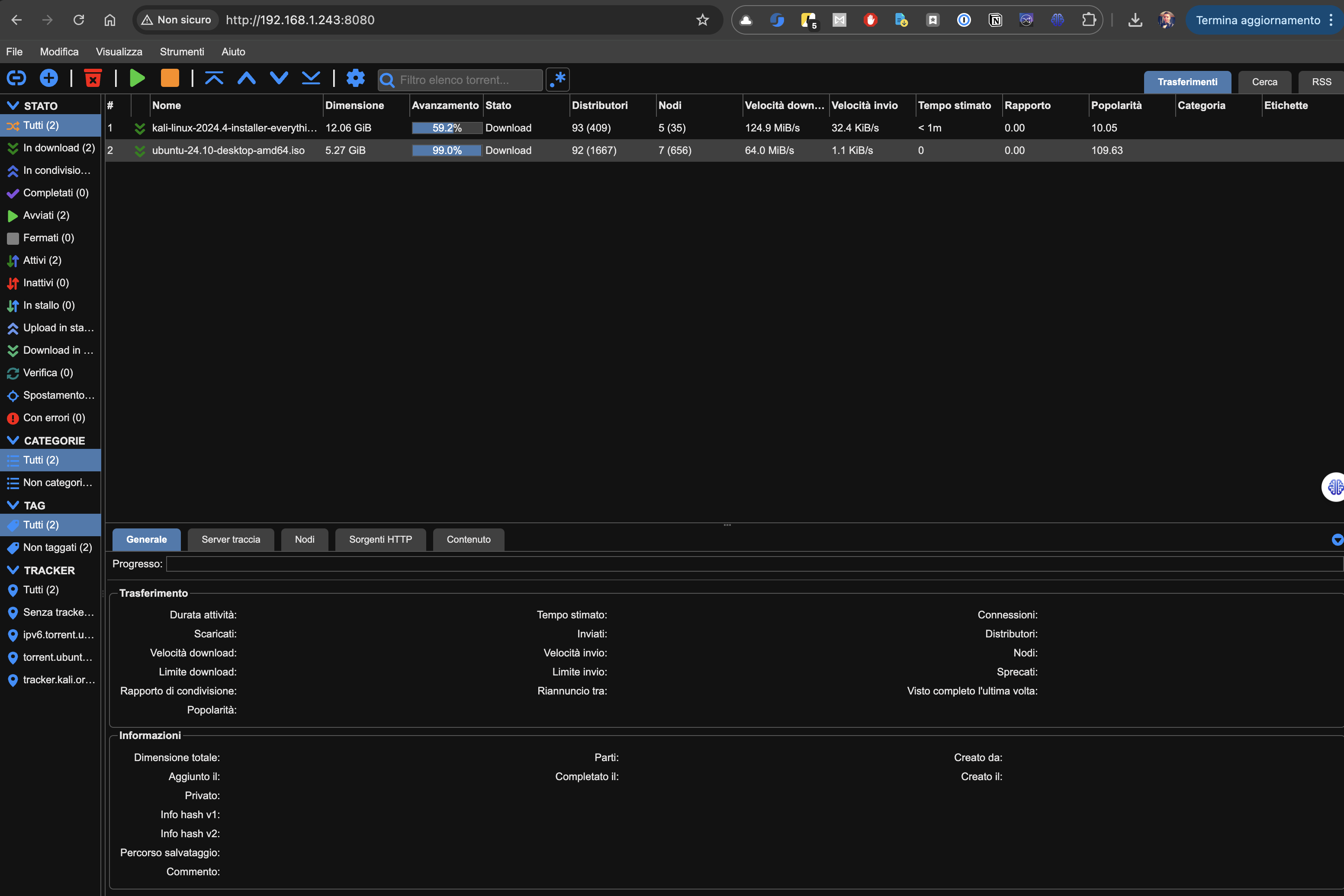

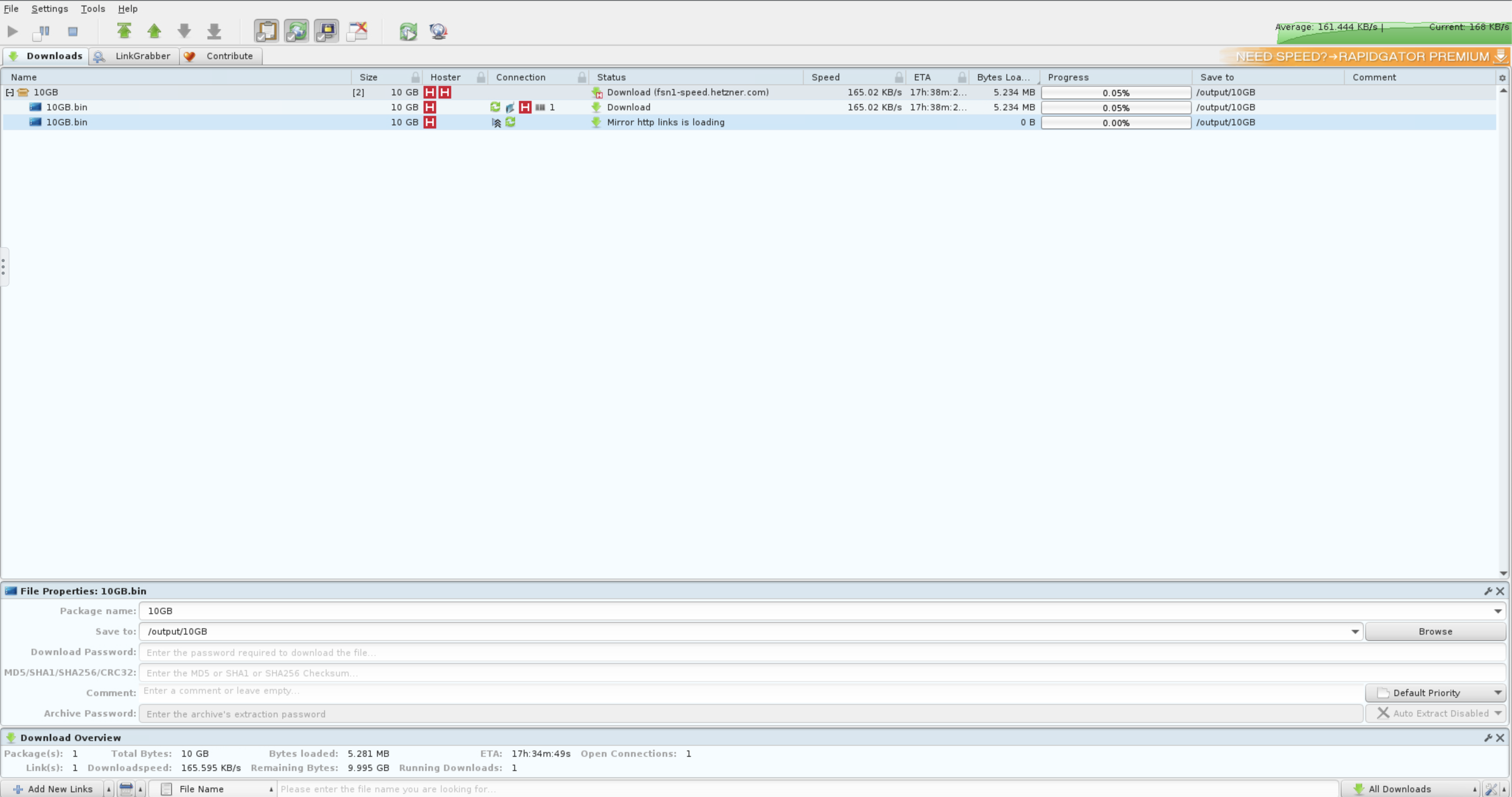

  6. UPDATE seems a problem with only jDownloader containers as you can see here:
  7. Hey everyone, Quick update on my previous SMB transfer speed issues. I discovered that disabling the Tailscale plugin entirely resolved most of my SMB bottlenecks. After removing Tailscale and all related virtual interfaces, I’m now seeing full 10 Gbit throughput when copying via SMB—whether I use user shares or disk shares. It seems that Tailscale and its virtual network interfaces were introducing a bottleneck for the SMB protocol, so if you’re having similar speed problems and happen to be running Tailscale, try disabling it to see if it helps! However, I still have one lingering problem: the jDownloader Docker containers are stuck around 10 Mbit/s download speeds, which is significantly slower than expected. I tested by installing the Speedtest CLI inside the container: • The first Speedtest sometimes reports a relatively good download rate. • But subsequent Speedtests (and real downloads via jDownloader) plummet to very low throughput—as if there’s some sort of QoS or bandwidth cap kicking in. On my firewall side, I have no traffic shaping or throttling configured. The same version of jDownloader running on Windows in the same network saturates my connection without any issues. So it’s definitely isolated to the container environment on Unraid. Any ideas on what could be throttling the Docker container’s traffic? If anyone has come across a similar jDownloader Docker speed cap or any Docker networking QoS problem, please let me know. I’ve tried all the usual suspects (disabling Tailscale, checking container network modes, etc.) without success. Thanks in advance for any tips! @trurl any ideas?

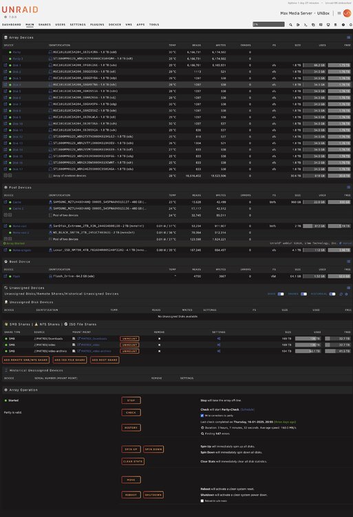

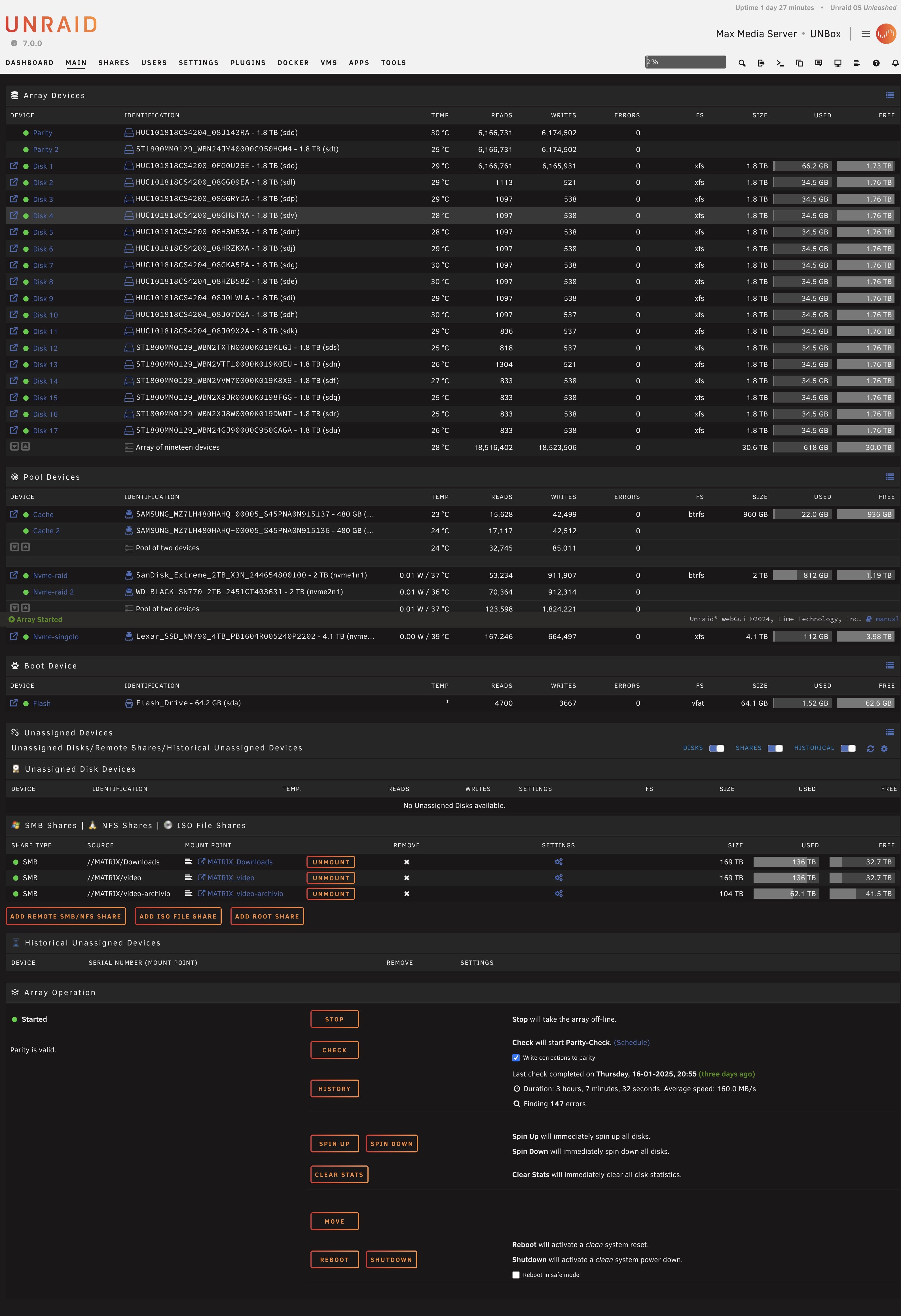

  10. @trurlsorry for forgetting, I attached the diagnostics to the post as requested. I would like to point out that the problem is not only with the array but also with the nvme disk pools where there is no active array.
