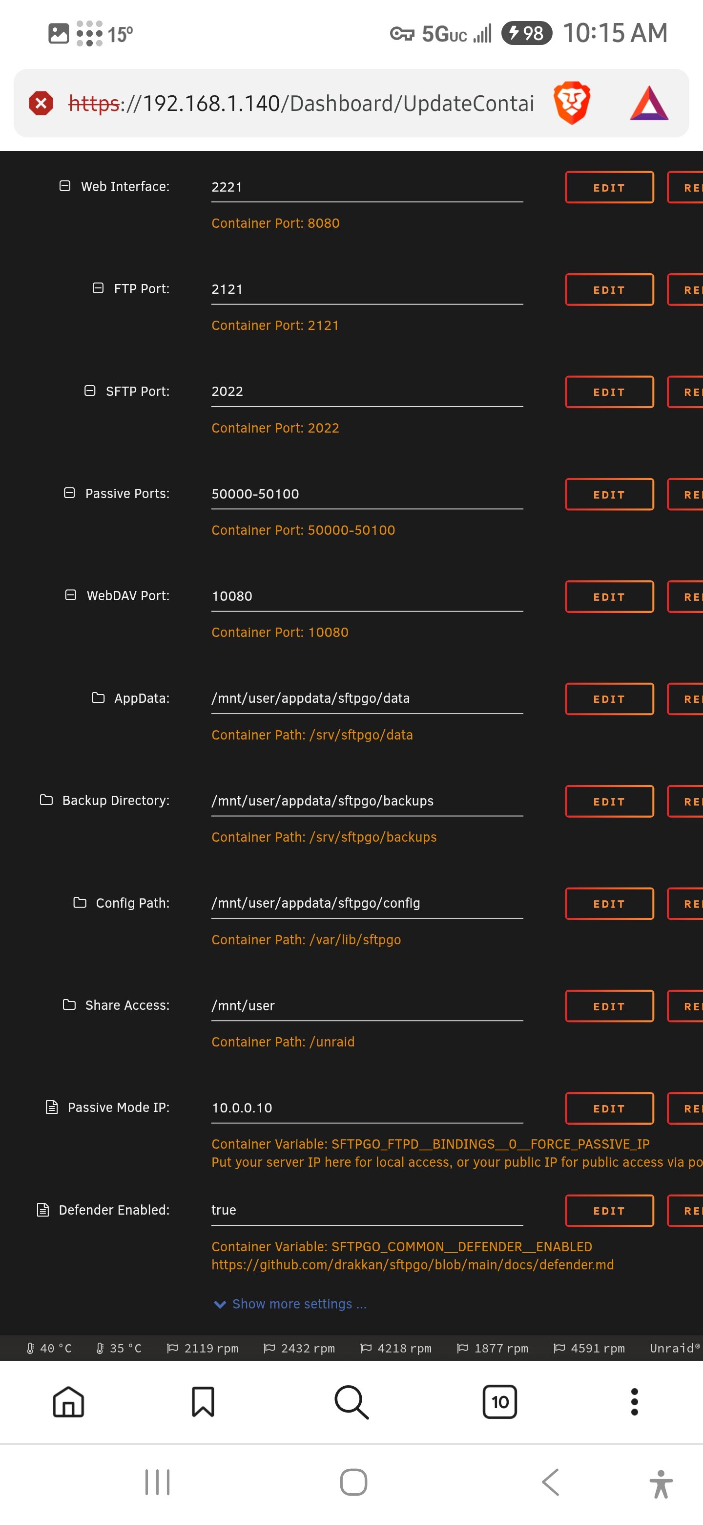

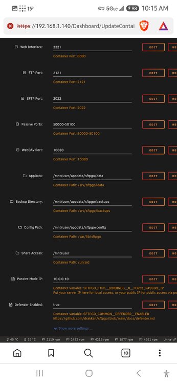

  1. I suggest reading why was already posted. It's literally what we've been already discussing. It took me a while to figure it out. You can either use the built in one and modify the vsftpd file in the /etc directory and configure User Scripts OR use SFTPGO. That's what has been discussed already. In great detail.
  2. So I was playing around with SFTPGo a bit. I think I figured out what my problem was. If you edit the container then "Add another Path, Port, Variable, Label or Device" I added the directory NAME (could be anything). Set the Container path (In my case it was "/Cameras" for my security camera FTP storage location which is /mnt/user/Cameras) Set the Host Path: /mnt/user/Cameras Access Mode: Read/Write (obviously) Then after applying the changes I restart the app. Open the webui for admin. Set a virtual folder: Name "Cameras" Root directory "/Cameras" Created a user "Security" (Left the Root directory alone.) Virtual Folders I set as "/Cameras" and selected "Cameras" (that was just created) Save. Just for the heck of it I played around a bit more. Virtual folder "Movies" Virtual folder "Music" Created user "Plex" Virtual folders "Movies" and "Music" When logging into "Security" on Filezilla it loads my "Cameras" folder When logging into "Plex" it loads my "Movies" and "Music" folders. Haven't played around much more with it though but it was more than I was looking for. Would like to get some security protocols enabled though. Other than 2FA for the webui of course. I like how it has an IP Block list and an autoblock feature but that's useless against VPNs. Not sure if this is something that I want accessible through the internet. Maybe local connections and VPN access only.

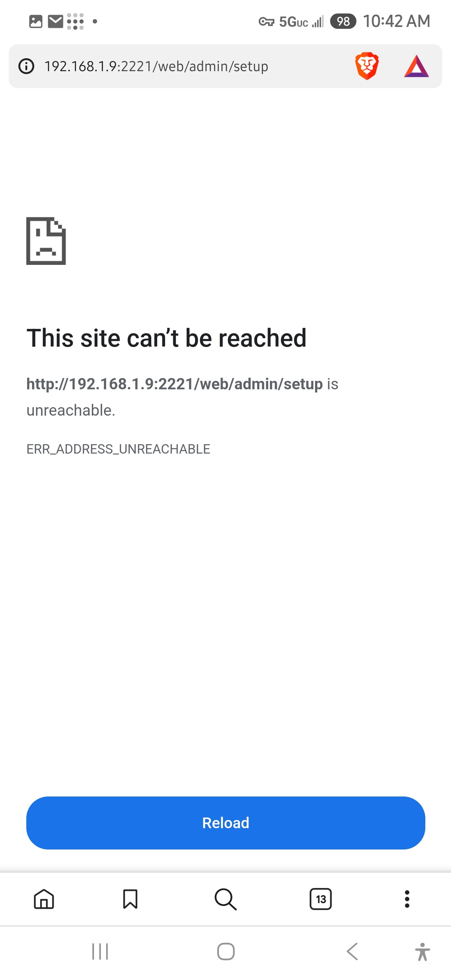

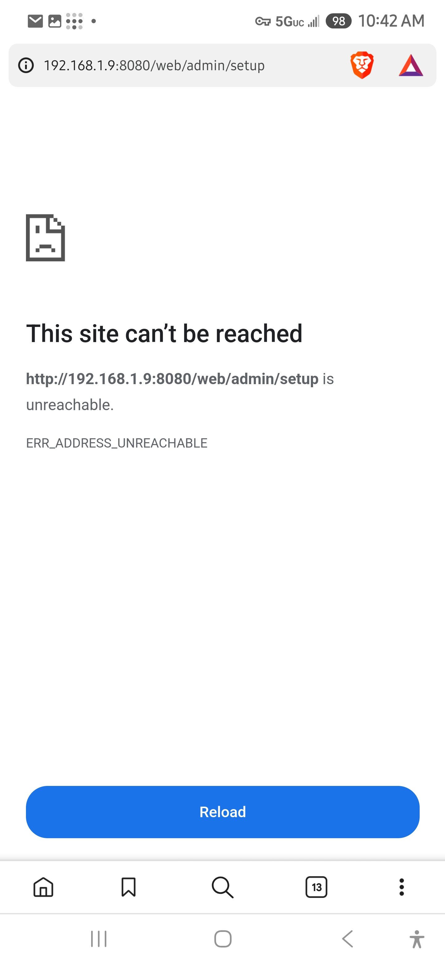

  5. Nope. Didn't work either. I'm doing this away from home through tailscale and even trying through Wireshark. I'll have to try it again when I get home.
  6. Nope. Didn't work.

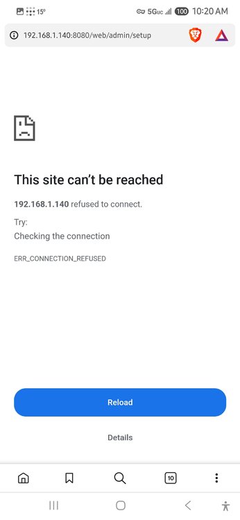

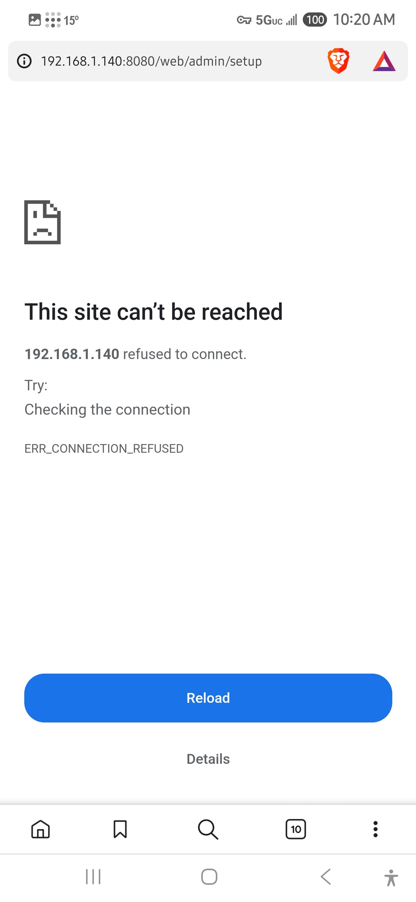

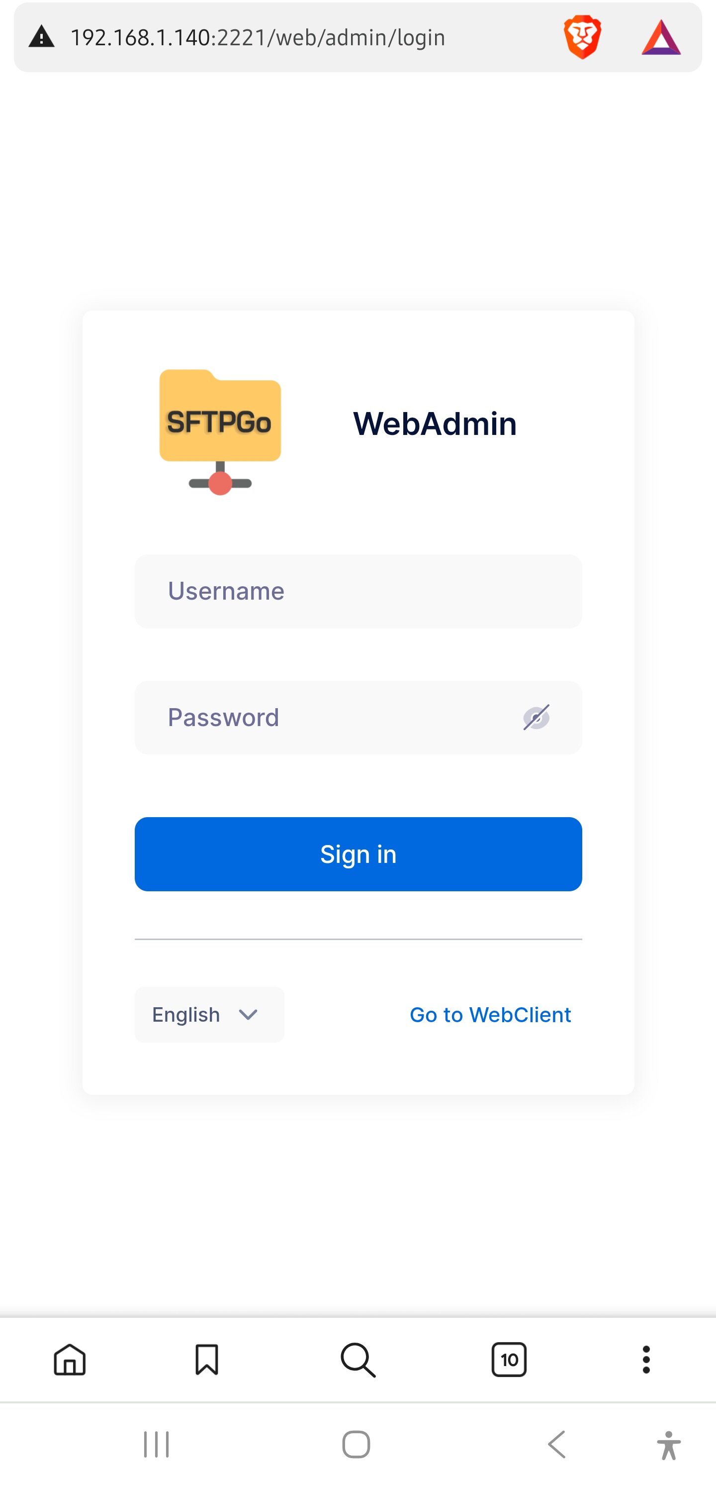

  7. So what's the password then? This has been the issue from the beginning. This is what I was talking about.
  8. I've tried that one and I can't ever get passed the login screen. It's never asked me to set an account up and can't find the user/password anywhere to set it up. I've tried everything obvious. My only successful searches ended here:
