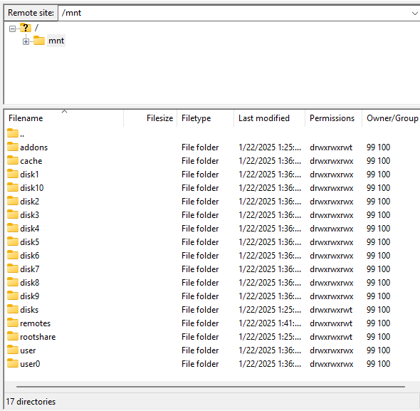

Thanks for this. Gonna give this a try later. Any idea on how to set the directory? The OS version defaults on /mnt which is... risky in my opinion. Just like @BrianGhere, I use it to store my surveillance videos on. But when you log in it goes right to /mnt directory. So if someone was to hack it... So I'd like to have it set to a very specific directory if it's possible.- New default FTP share and new path for FTP service
I previously used ProFTPd on verion 6 but it stopped working on OS7. The built in FTP server is very easy to setup and operate BUT: It doesn't start by default. I would like for it to automatically start after the array starts. AND For some reason, it defaults to /mnt/ directory. This gives RW permissions to whatever can access it. I hate that! FTP is notoriously easy to hack. And everyone knows that it uses port 21. So it's easy to assume that a port scan of port 21 can reveal your easy to hack FTP server which can lead to losing everything. That's frightening! I only need it for my security camera NVR system to upload the videos and images to. That's it. Where ProFTPd I was allowed to set the FTP directory to /mnt/user/CameraNVR and the FTP server would ONLY be that directory so if the FTP was to be compromised, that's all I'd lose. But now I risk losing it all. I have tried a few of the community FTP servers and they're all waaaayyyy too difficult to configure for me. Any inputs or thoughts?- AsRock Z170 Motherboard bios 7.60 fails to boot with OS 7.0.0
