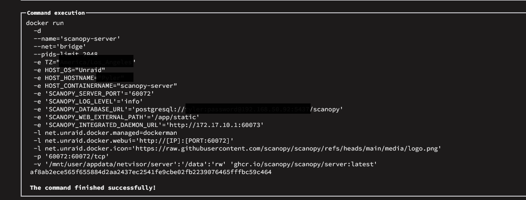

  1. Your integrated Daemon URL is most likely wrong. Read the comment in the field for what should be there. It should be whatever your docker bridge gateway is - which it should auto fill. So maybe reset the template back to default?
  2. @bbronz3 Why did you add the ' SCANOPY_PUBLIC_URL' = 'http:/ / localhost : 60072' ?? There seems to be an extra space at the beginning of that variable too - but you must have added it because the template doesn't come with that. Refer to mine
  3. Someone needs to fix the unraid docker template for the daemon- it is a little bit wrong. Make sure you guys remove the port from the server target. @bbronz3 The server target should just be the root of your server as the port will get filled from the port variable below it. Refer to my screenshot example of what it should be.
