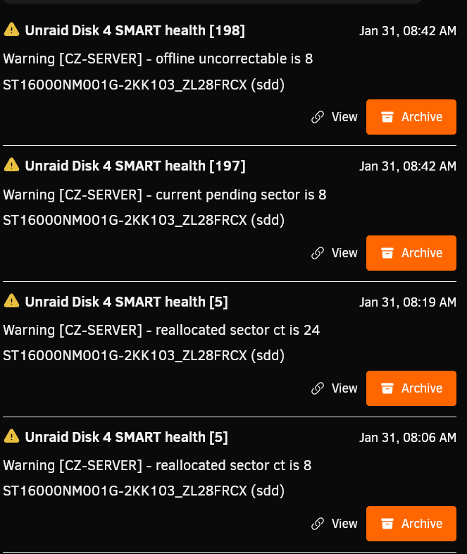

  1. First, just wanted to say thanks for the help! I ended up finding unbalanced after my last post and got that process started. I've now removed the drive from my array. The drive is covered under warranty and is going to be replaced. Is it worth creating a new config with that drive removed and rebuilding parity now or should I wait until the replacement comes in?
  2. The RAM I switched to was new so hoping it's good. I'll still test soon though. Poor time to have RAM and a drive failing with current prices. Haven't dealt with a drive failure yet on Unraid so need to figure that out. Edit: I only have 5.5 TB on the drive that's failing. Is there an easy way to move data off that drive so I don't need to replace right away?
  3. I was started to suspect RAM. I was able to swap to a different set to avoid downtime. I scrubbed the NVME drive afterwards and removed the corrupted files. Everything seems good so far, but I did see these errors earlier today that I hadn't seen before. Could they be related or is this a separate issue and that drive is starting to fail? ST16000NM001G-2KK103_ZL28FRCX-20260131-0959.txt
