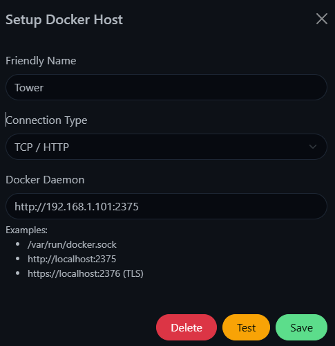

  2. This worked for me. Switching to main then using the default local-config.yaml here.
  3. Alright so I did some investigation and found that my docker daemon wasn't exposing port 2375 or 2376 locally anymore. To fix this I navigated to the config folder on the Unraid Server: /boot/config/ Nano into 'docker.cfg' and added this section: DOCKER_OPTS="-H unix:///var/run/docker.sock -H tcp://0.0.0.0:2376" Saved the config and restarted the docker service with: /etc/rc.d/rc.docker restart All is working well and my uptime kuma service on my desktop pc can see the docker containers on my unraid server again.
  4. Hello, I just recently experienced my first flash drive failure. After replacing it and manually setting up my OS and docker containers again, I've run into a slight hitch that is rather annoying. Alongside my server PC, I run uptime kuma on my desktop PC as a docker container so that way I can monitor the status of the server PC along with everything running within it. Since reinstalling the Unraid OS, I'm not getting the status of docker containers. The method I used is creating a Docker Container monitoring type, creating a docker host that points to my server PC on my local network. This no longer works for some reason and I'm not really sure where to even begin.
