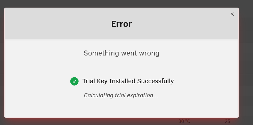

  9. Been a trying process so far, unfortunately. First two USB's I tried, the USB creator wouldn't believe had GUIDs (even though I could see them through various tools). Third one (all sandisk 16GB usb3.2) recognised the guid but then 'couldn't' complete the format, not clear what the issue was there, because windows thought the formatting was fine, at that point fell back on the manual install. There appears to be a typo in the windows make bootable script and it failed as a result (pretty sure the below is meant to be setup) # from make_bootable.bat :select echo: set/p boot="Permit UEFI boot mode [Y/N]: " if /i %boot%==N ( # pretty sure this should be setup not set/p (at least that's what windows terminal thought it was trying to do): but even after fixing that it still didn't quite seem to work, every time I booted in, got the missing operating system message. At that point, I flipped the USB into zip mode, added an autorun to point it at syslinux and the .cfg and tried again. Worked like a charm, I am in, I have got in through the UI. Now, when I go to start the trial, I get something went wrong > Trial Key Installed Successfully > calculating trial expiration which may or may not be related to the trials that happened before this point.. Please let me know what additional info you need. Persistent of Gloucestershire.
