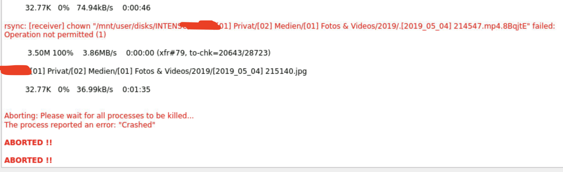

  11. That's it, thanks! The file system of the external drive is exFAT which doesn't support ownerships and permission. I had to go to the task inside LuckyBackup and modifify under advanced settings. Untick "preserve permissions" and "preserve ownership".

  13. Yesterday I installed LuckyBackup (with root rights) and made my first backup. Today I started the backup task again and I always get this error: It's weird because yesterday it worked perfectly and also I run LuckyBackup as root. I am also very confused why there is a dot in front of the filename (there is no such file with a dot in front of the filename!). And I also dont know where the weird numbers after the filenames are "8BqjTE" are coming from. They are not in the filename. The backups goes onto an external drive which is mounted correctly.
