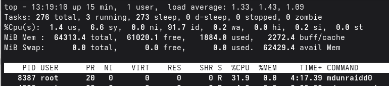

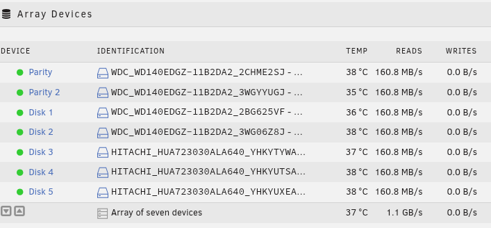

  1. SOLVED - though I cannot explain how. After seeing that it was related to a pegged CPU, I shut down my Unraid VM and tweaked it's settings: Reduced Cores from 12 to 6 (12 was always just a flex anyway but with 48 threads available, why not) Changed the vIOMMU setting to VirtIO from "Intel (AMD compatible)". I am not running any VMs in Unraid, so I don't think this would even apply anyway. Increased RAM from 64000 to 65536 (another flex, I should probably reduce it). Added a TPM State devices - just in case I can use it to get off the thumbdrive. None of these changes should have had any impact, but clearly they did. Or it was just the reboot? And with a sync running its only using 30% of one core:
  2. Looks like I am somehow being CPU limited. When running a sync, the mdunraidd0 process is consuming 100% of one core. This wasn't a problem before the unraid upgrade. I am using an AMD EPYC 7402P 24-Core, the individual cores aren't super fast, but they don't need to be for this. Should certainly not be pegged by a simple parity calculation. This tells me that something is not right. It could be something on the Proxmox side, since I did apply updates there at the same time. Though nothing that should have made this large of a difference. I'll keep digging, but would appreciate any input if anyone has seen this, particularly on AMD CPUS.

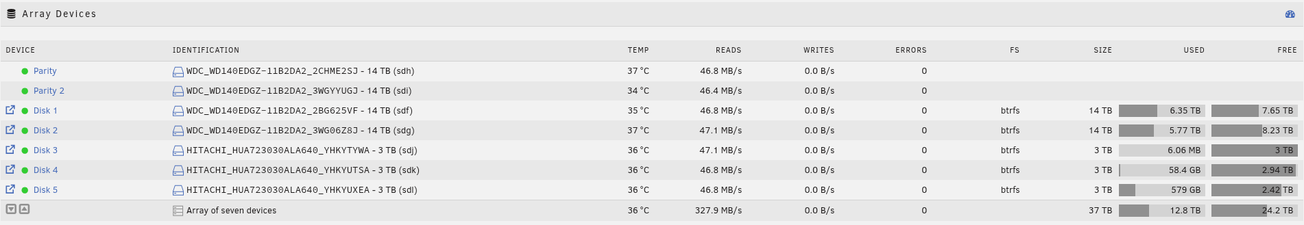

  3. Slightly faster in maintenance mode, 50MB/s vs 45MB/s, still no where near where it should be.

  7. Here are the 7 drives that make up my array, they are all plenty fast enough. /dev/sdf: Timing O_DIRECT disk reads: 622 MB in 3.00 seconds = 207.00 MB/sec /dev/sdg: Timing O_DIRECT disk reads: 534 MB in 3.02 seconds = 177.02 MB/sec /dev/sdh: Timing O_DIRECT disk reads: 648 MB in 3.00 seconds = 215.65 MB/sec /dev/sdi: Timing O_DIRECT disk reads: 566 MB in 3.01 seconds = 188.15 MB/sec /dev/sdj: Timing O_DIRECT disk reads: 474 MB in 3.01 seconds = 157.45 MB/sec /dev/sdk: Timing O_DIRECT disk reads: 438 MB in 3.00 seconds = 145.98 MB/sec /dev/sdl: Timing O_DIRECT disk reads: 450 MB in 3.01 seconds = 149.71 MB/sec Yet:
  8. I upgraded yesterday from 7.2.x (want to say 7.2.4 but not sure). Prior to doing the upgrade I ran a parity-check (it had been a couple of months), right from the start it told me it would be just over a day to complete, and it was accurate within a couple of hours. Post upgrade, I decided to kick off another parity check to generate some heat (I am working on tweaking my fan curves on the host system, I run Unraid in a VM with pass through disk controller). This post upgrade parity check is estimating over 3 days. It shows it reading my disks at 44MB/s, compared to my typical ~135MB/s. Anyone seeing similar behaviour?
