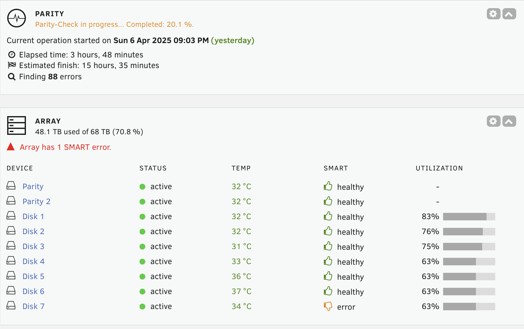

Please help. Random crashes after migrating to a new motherboard and CPU.
Just giving you an update, the crash happened again and I decided to chatGPT the heck out of it. When I went to the brass tacks with all the errors, it found that there was corruption happening in my "docker.img" file. I recommended me to wipe it and reinstall all the docker images I had. Another thing that it recommended me to do was to scrub my "btrfs" so that I did. So far running it in all its paces has no crashes now. @trurl Thank you for your help and teaching me about parity correction and scanning information.

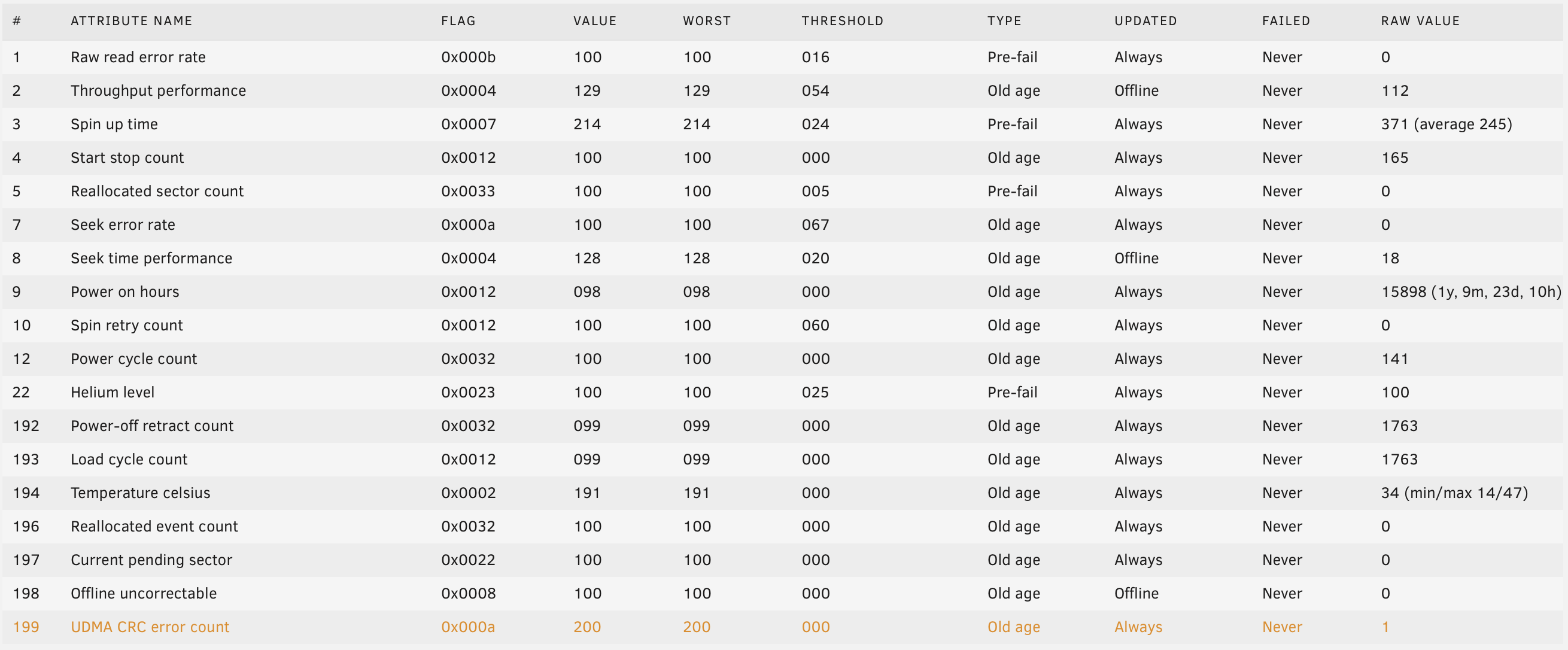

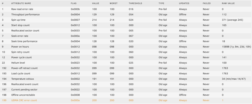

Just an update @trurl This might be the cause of the issue. Looks like it might be due to a loose or bad cable on one of my SSD drives. From inspection the wire is a bit too short and tugging on it a bit.

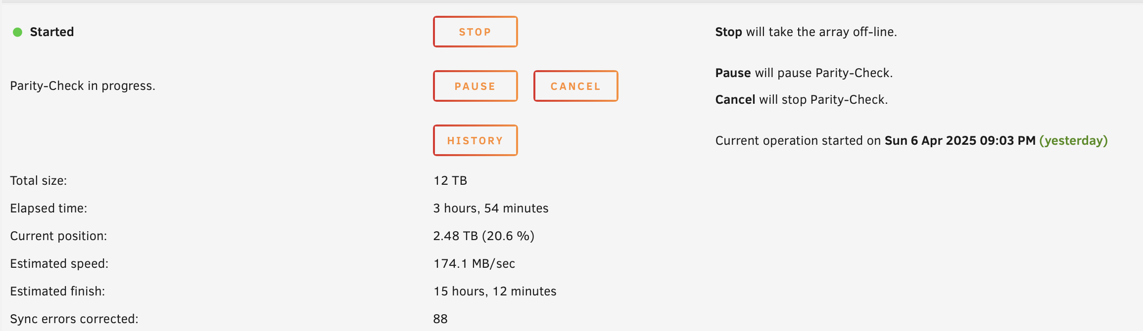

Makes perfect sense. Thank you for the info. Nope, I let the machine stay dead after getting this crash 5 times. should I let this parity check run? how do I make it "correcting"?
I see! I always thought that parity checks are error correcting if they don't match up. Would it be best remove the parity drives, format them then add them back? Sorry for my ignorance, still starting out in this homelab journey.
