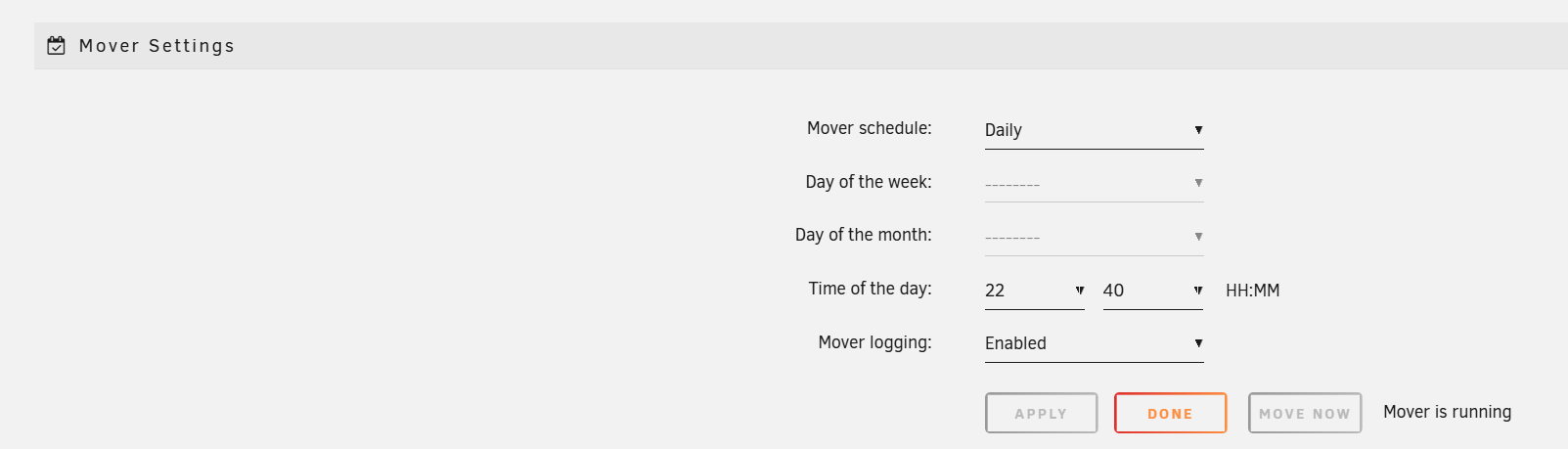

  5. Had run it previously but it was running it again for some reason. Ran mover again overnight after a reboot, cache is almost full now though. hp-diagnostics-20250414-2033.zip

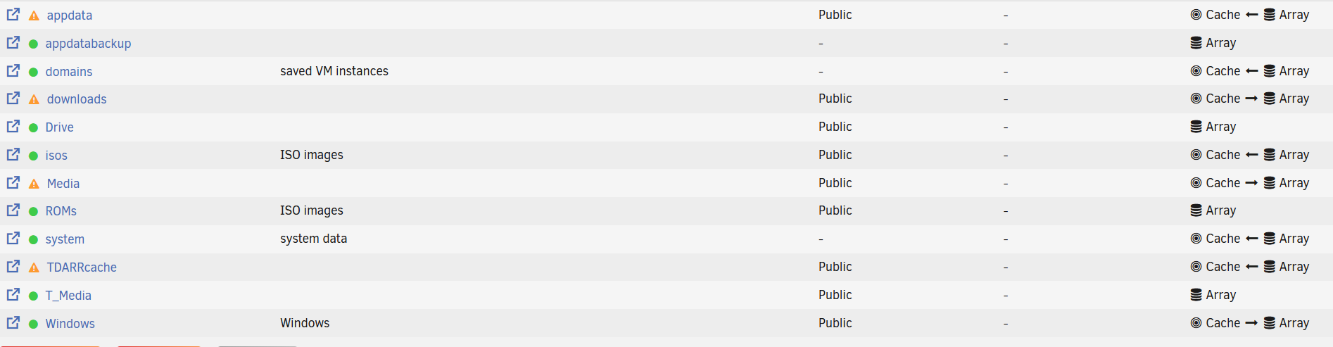

  6. Yes, disabled docker and VMs, changed user shares to cache primary, secondary array with move to cache, ran mover overnight with the diagnostic in the first reply post. The cache drive usage size increased, so I assumed it worked (19GB to 295GB). It was the mover on the Main array operation screen.

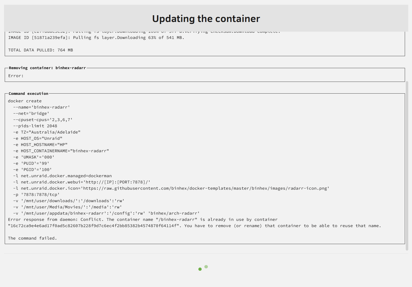

  7. Updating docker apps still isn't working after turning the docker back on after reinstalling hp-diagnostics-20250412-1045.zip

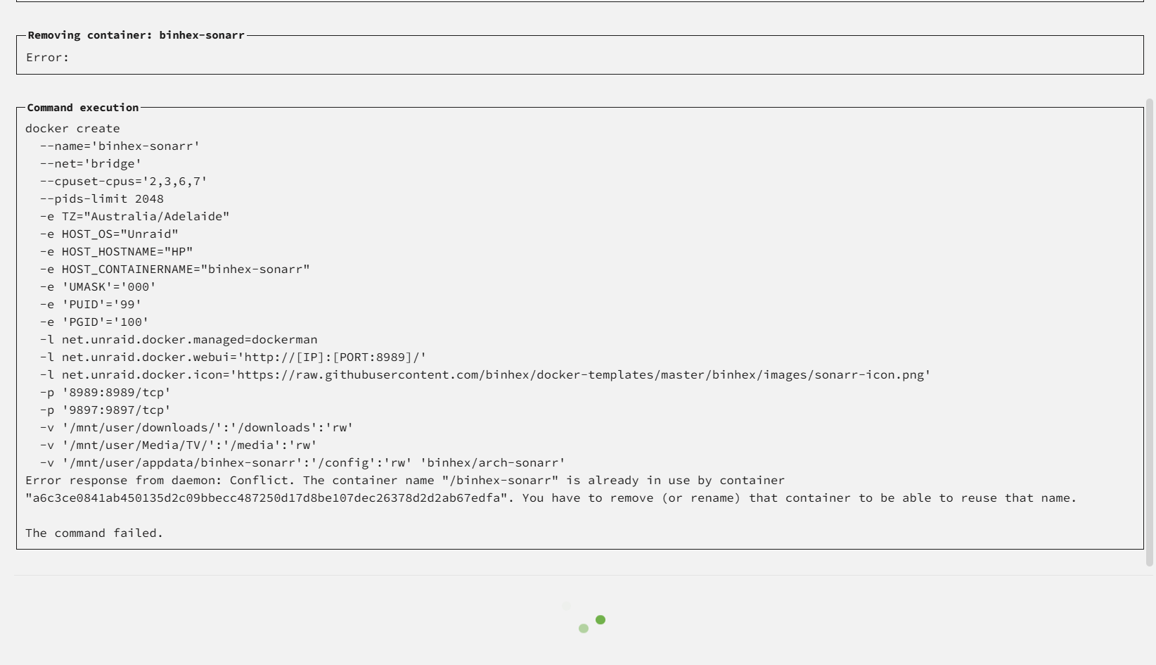

  8. Thanks for the response. Will disable docker and VMs, change user shares, run mover and repost. Diagnostics attached after action hp-diagnostics-20250412-1045.zip
